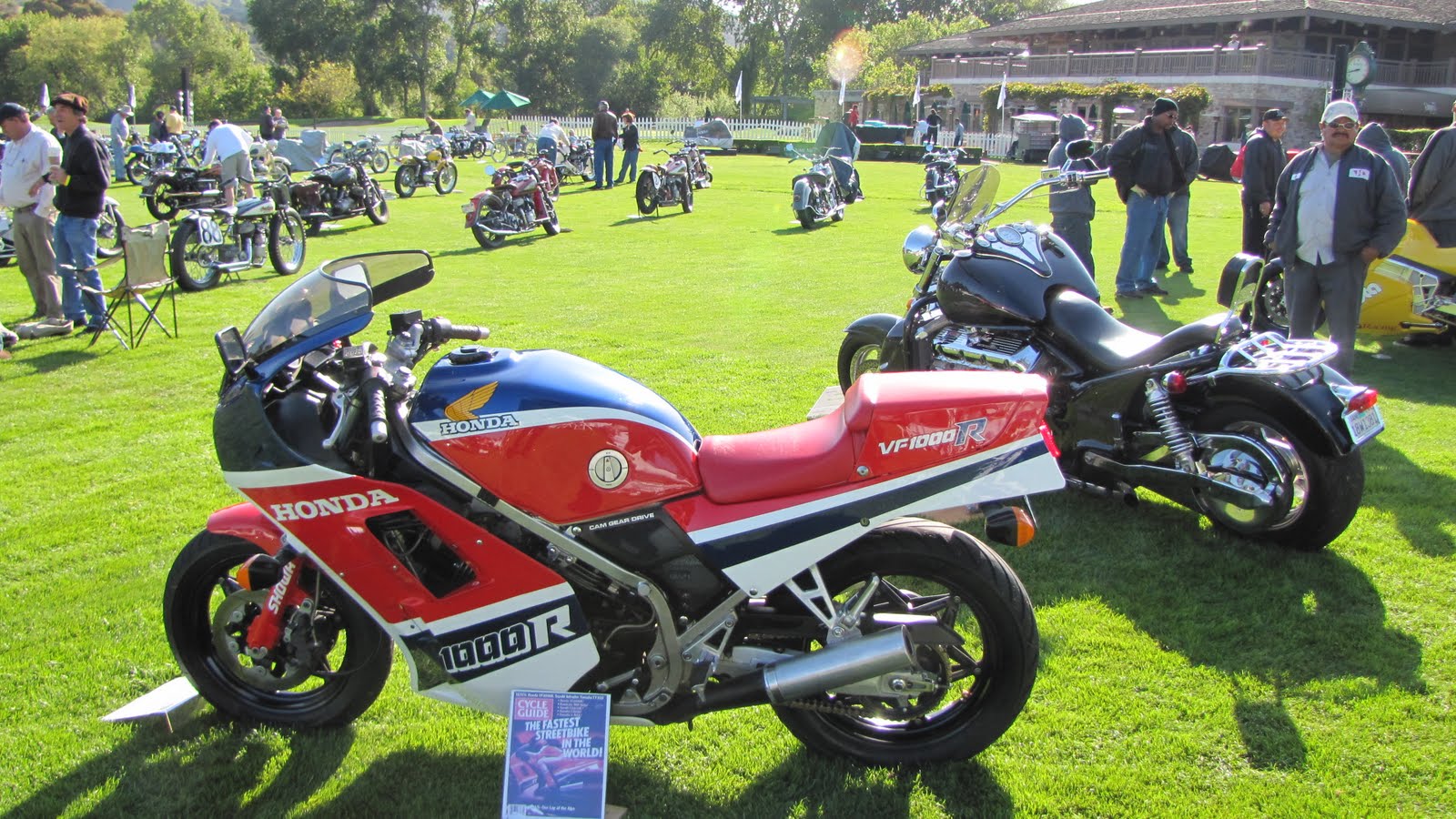

Here are a few pics from the Quail Lodge Motorcycle Gathering where I had the VF1000R on display: That’s me in the pics BTW

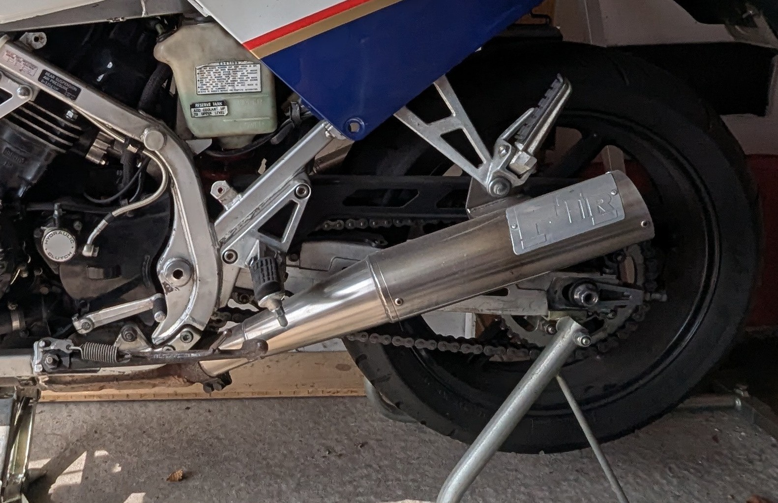

Nice to see your slip on canisters. I got mine with Cobra ones but they seems to be stainless steel.
They were fitted as I got the bike. I have no docs. To be sure they are still silencer I made a noise measurenent and they are with a margin of 8dB inside the limits.
Those cans look nice :+1: The F1 brand was made of aluminum, so probably a bit lighter. and a LOT lighter than the stockers.
The F1’s are too loud for my preference, but, like you, they came with the bike when I bought it.
I probably 3rd or 4th owner, but have had it longer than any of the others I’m sure., since 2012.
I’m running it with the OEM collector box ‘delete’, so that makes it a lot louder right there.

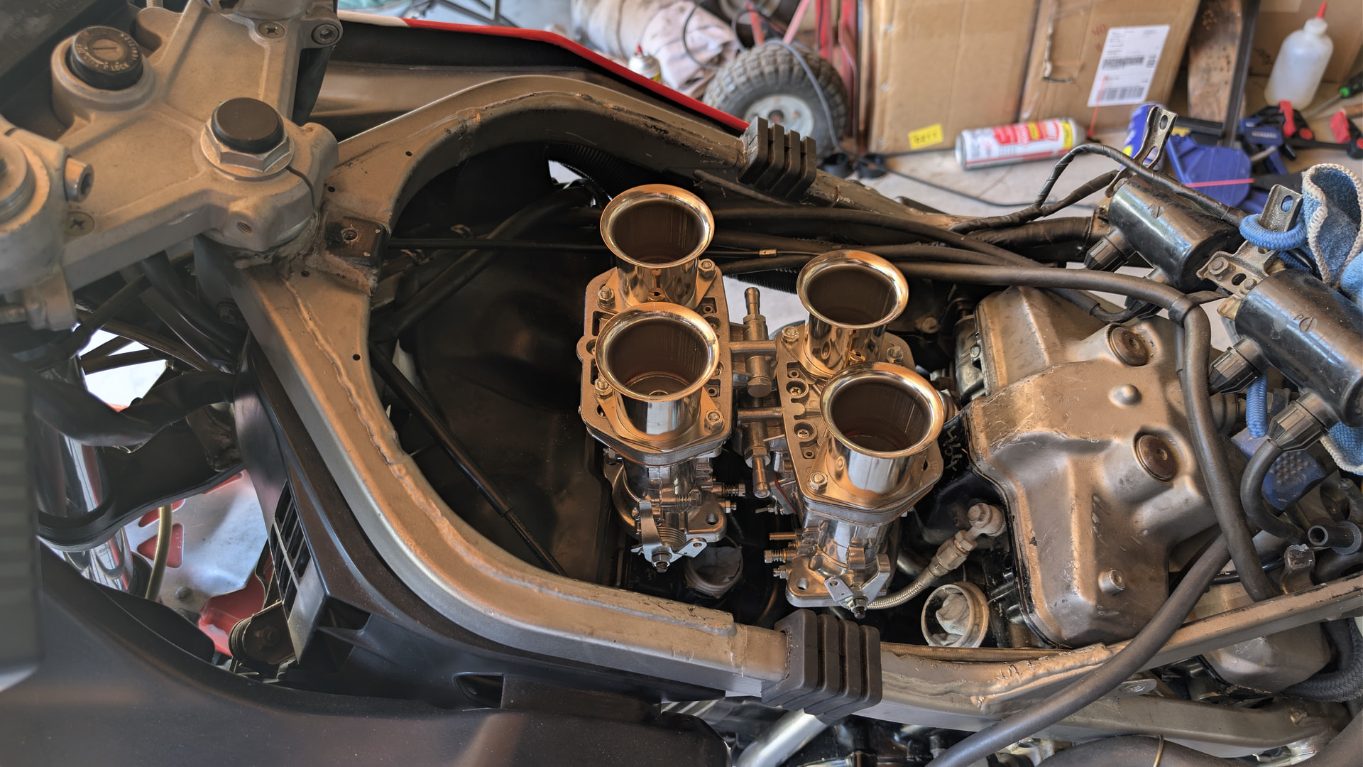

Well, the bike wouldn’t start after replacing the fuel pump, fuel tap and clearing the file by blowing compressed air back through it. Fuel was flowing, but the bike wouldn’t start, and only just catch on full choke enrichener, then die in 2 sec., so then yesterday I pulled the carb rack out again so I can go through it and look for reasons it won’t start. BTW, I squirted some starting fluid into the carb intakes and it did indeed fire briefly on all 4 cylinders, so it does have ignition! At my wits end with these 40 yr. Old carbs. I previously toyed with converting to Weber IDF downdraft carbs but the inlet manifolds were really difficult to fab so I gave up. I’ll add a pic showing the carbs in place… So now it’s back to more head scratching and frowning…

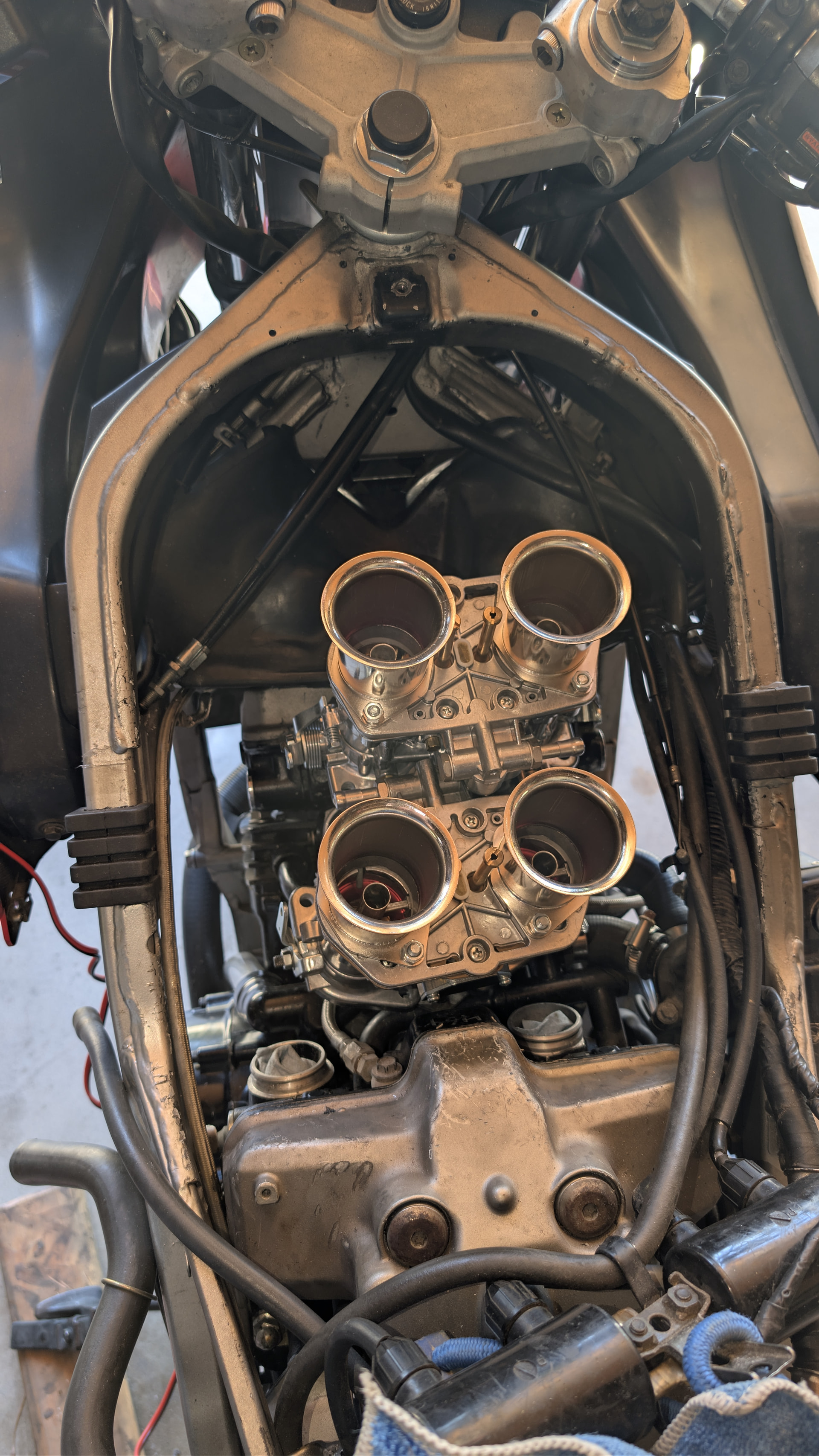

Here are a couple of pics from the Weber downdraft aborted conversion. These are Chinese Weber clone carbs and are about 50 USD per 2 barrel 40 mm carb on Amazon. The butterflys are 40mm, and they have 28mm chokes suited to run very well on air-cooled beetle engines of 1300 to 1600 cc typically. And each boxer engine runs on a pair of these twin choke downdraft carbs. I gave up the project mostly due to the difficulty in fabbing inlet elbows to the angled boots
to square everything up, and overall space issues. Then there is the likely nightmare of synching the front and rear carb pairs, jetting, etc. The conversion looks cool, but you lose all “bling points” because these carbs are completely hidden underneath the fuel tank and fairings.
I still think efi would be the best way to go, and I’d use a VFR800 efi throttle body rack modified for inlet spacings.. front/back/left/right… a big task there too.

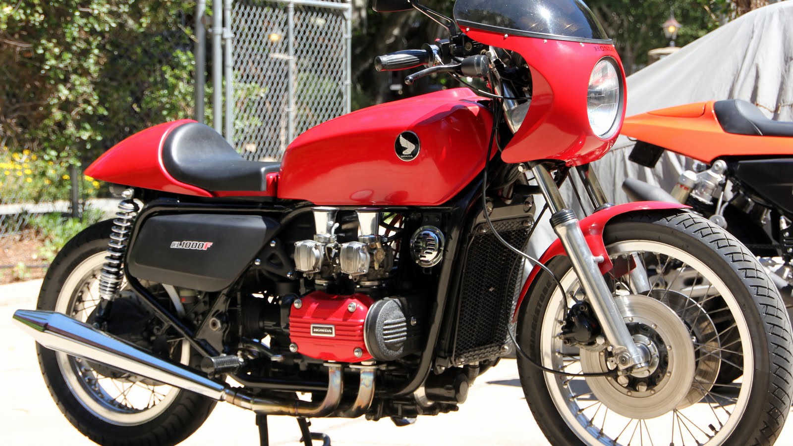

I do have another idea in my head, that is to modify and fit downdraft Mikuni CV carbs from a Yamaha Venture/VMax. I did this on my 1975 Honda GL1000 Goldwing Cafe bike, and they ran very well. The OEM GL 1000 side-draft carb bank is heavy and troublesome too. An alternative here for the VF1000R is to buy two pair of carbs from the Virago 535 v twin, brand new on Amazon for about $170 USD ea. Here is a pic of the Venture downdraft carbs I put on my GL1000: I had to modify spacing and tie the left and right banks together with an adjustable tie-rod just like the Guzzi setup. Synching wasn’t bad at all because of easy access.
