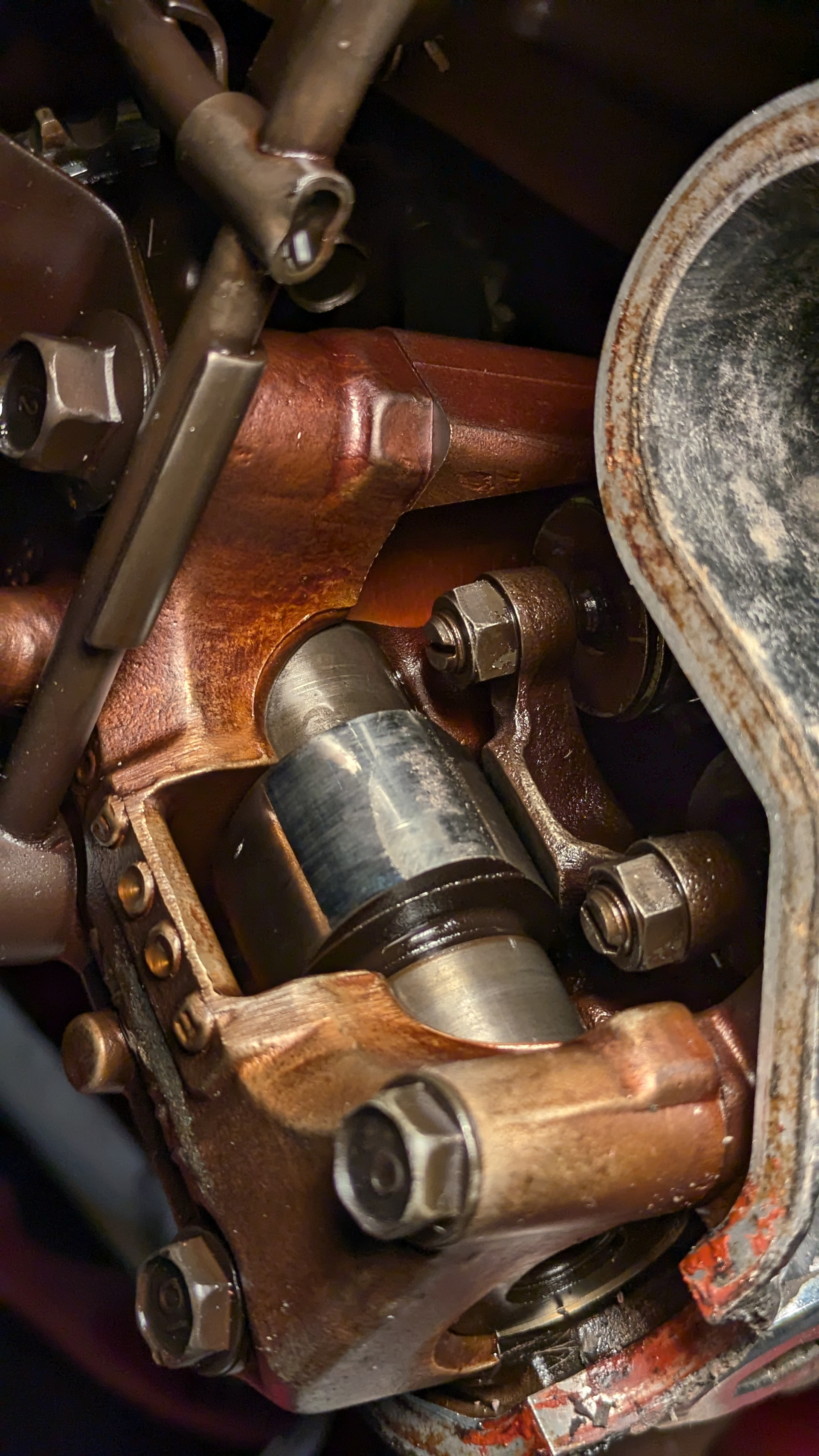

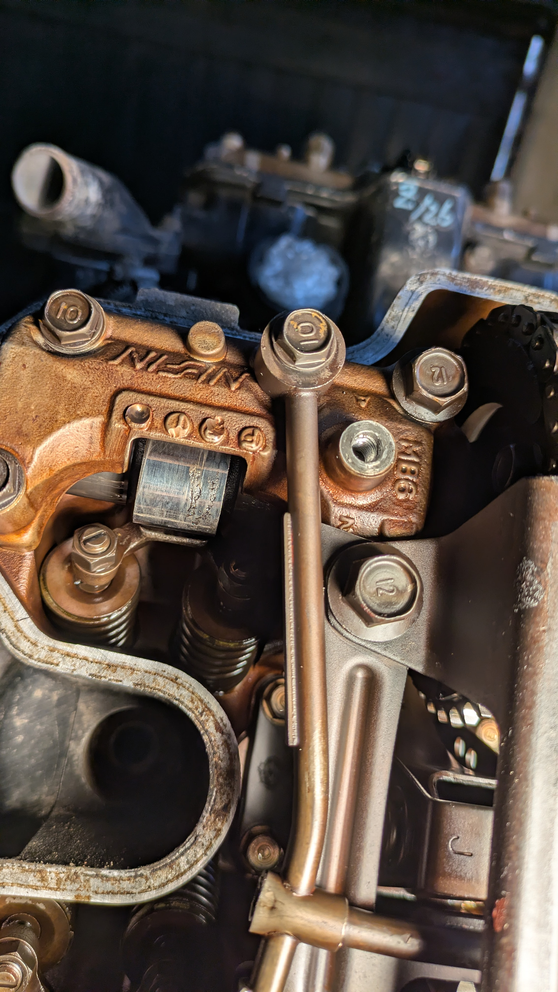

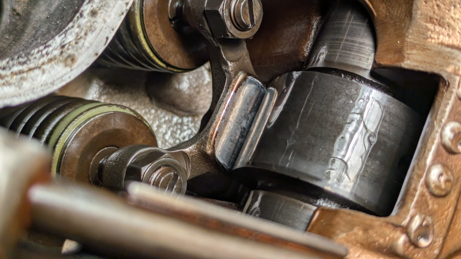

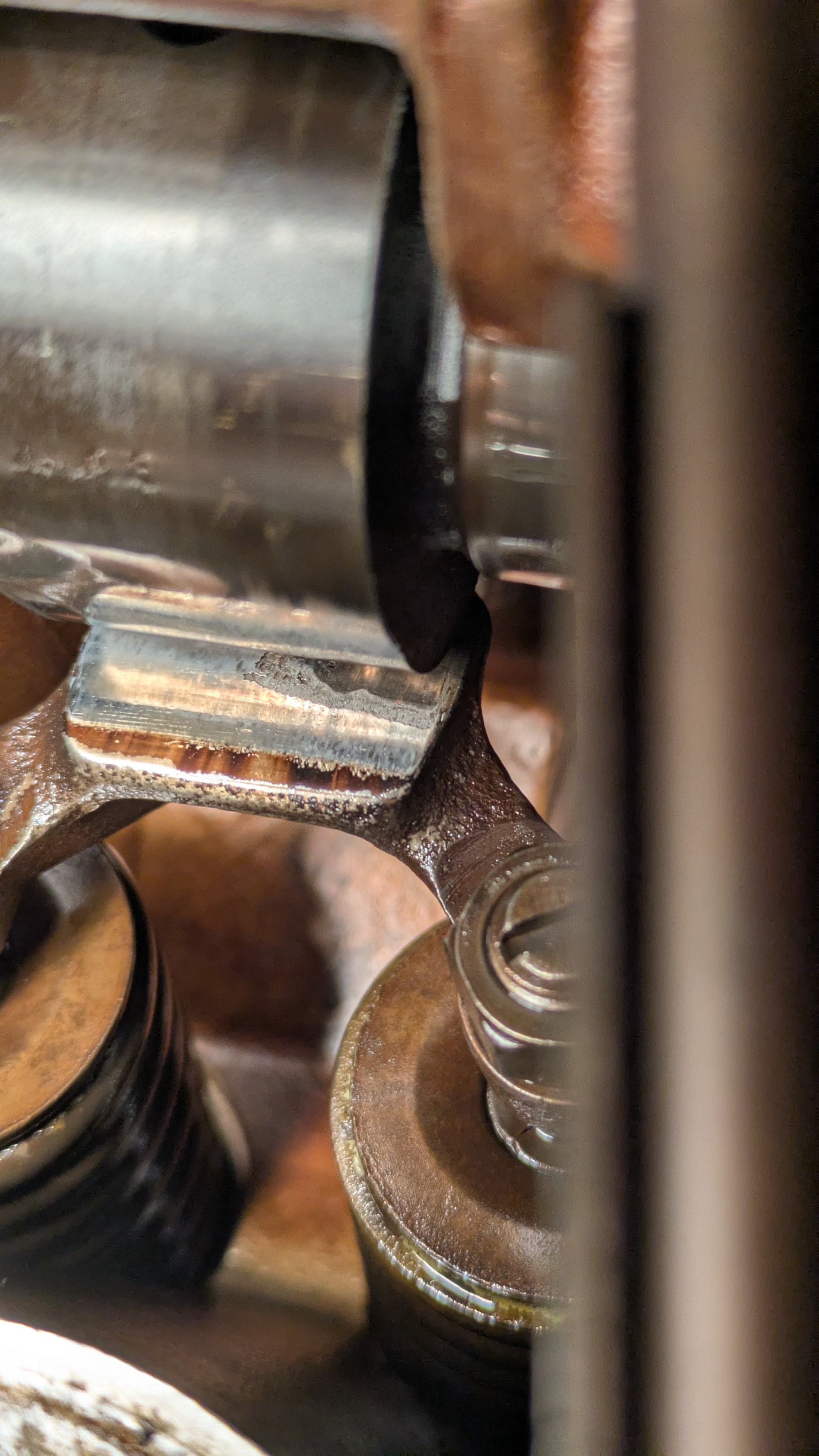

These are the worst ones. Some look fine although might not be when I strip them out. I think even with modern oils these cam lobes are going to tear up quickly if I don’t do something. The 1st photo shows the worst lobe on inlet of cylinder 2. The last photo shows the eroded chrome on the follower that has caused the damage to the lobe.
