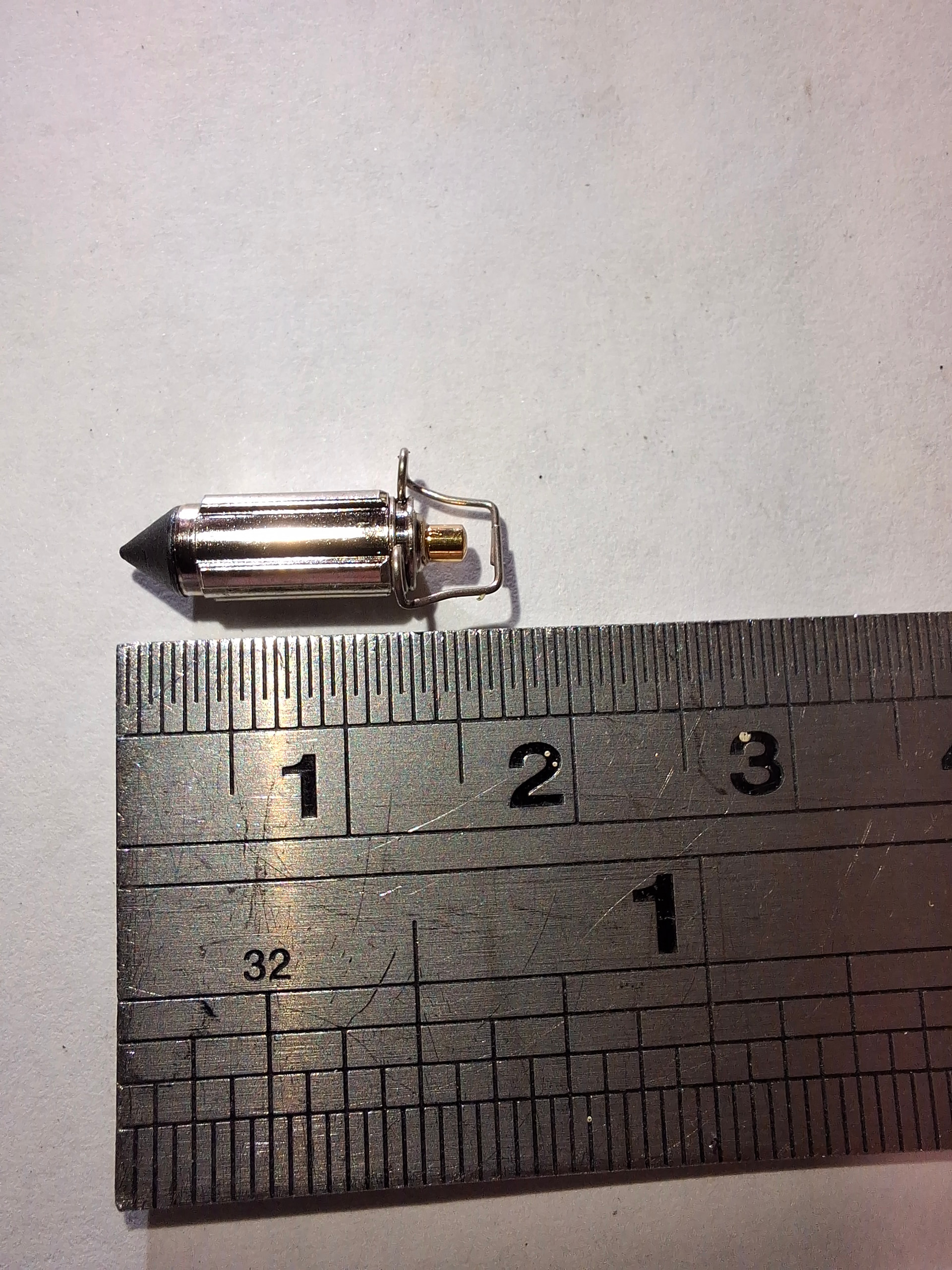

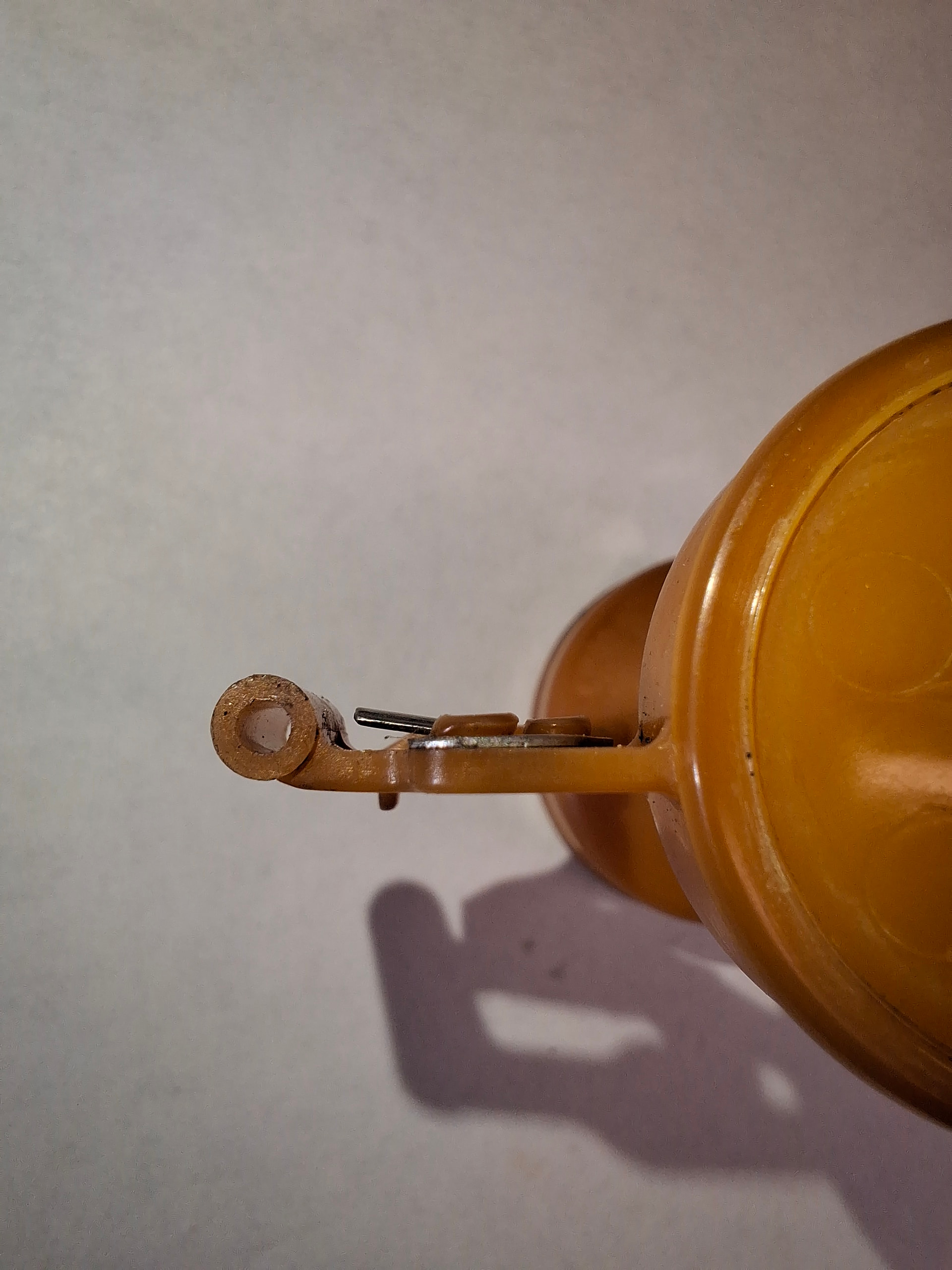

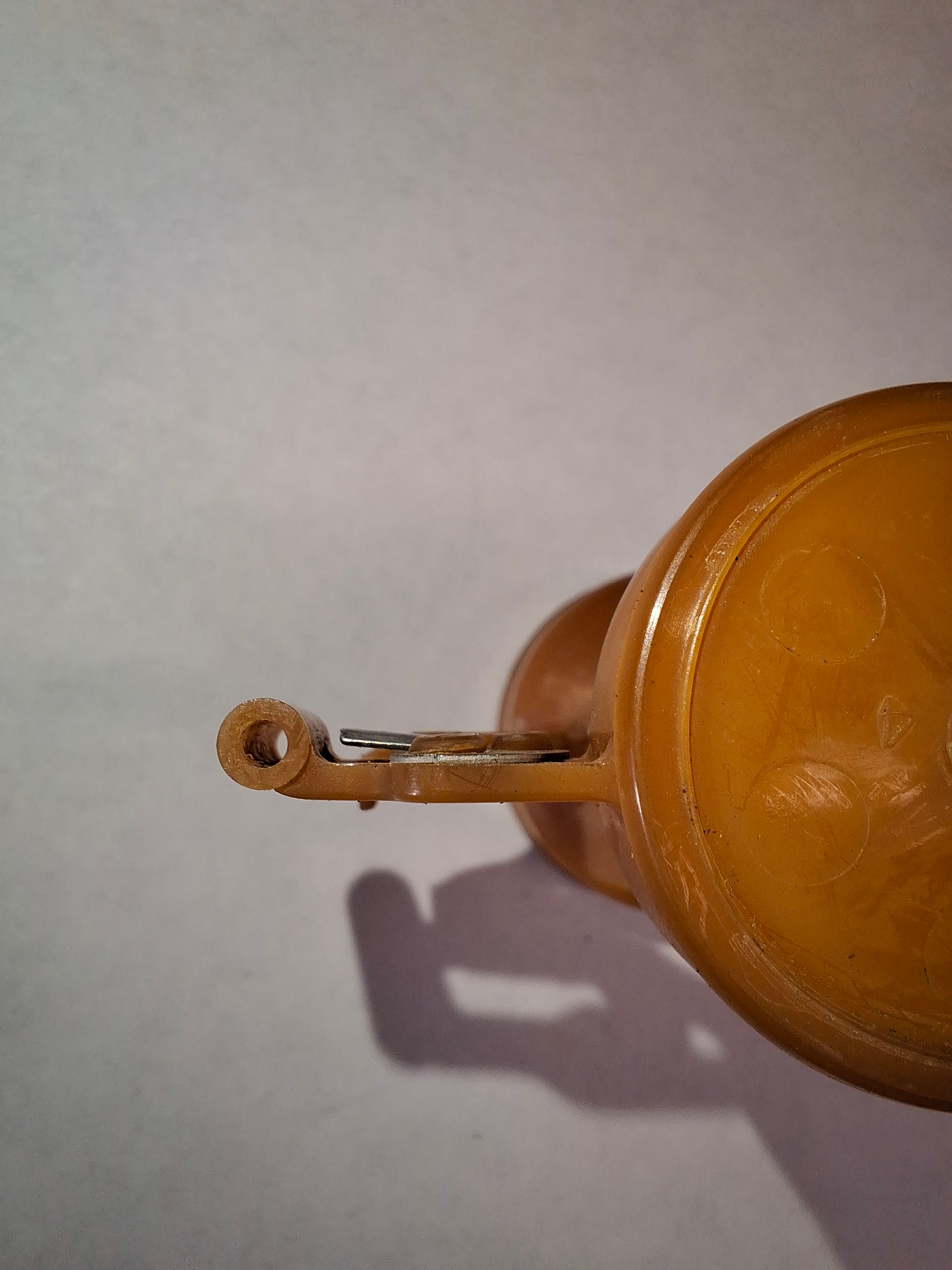

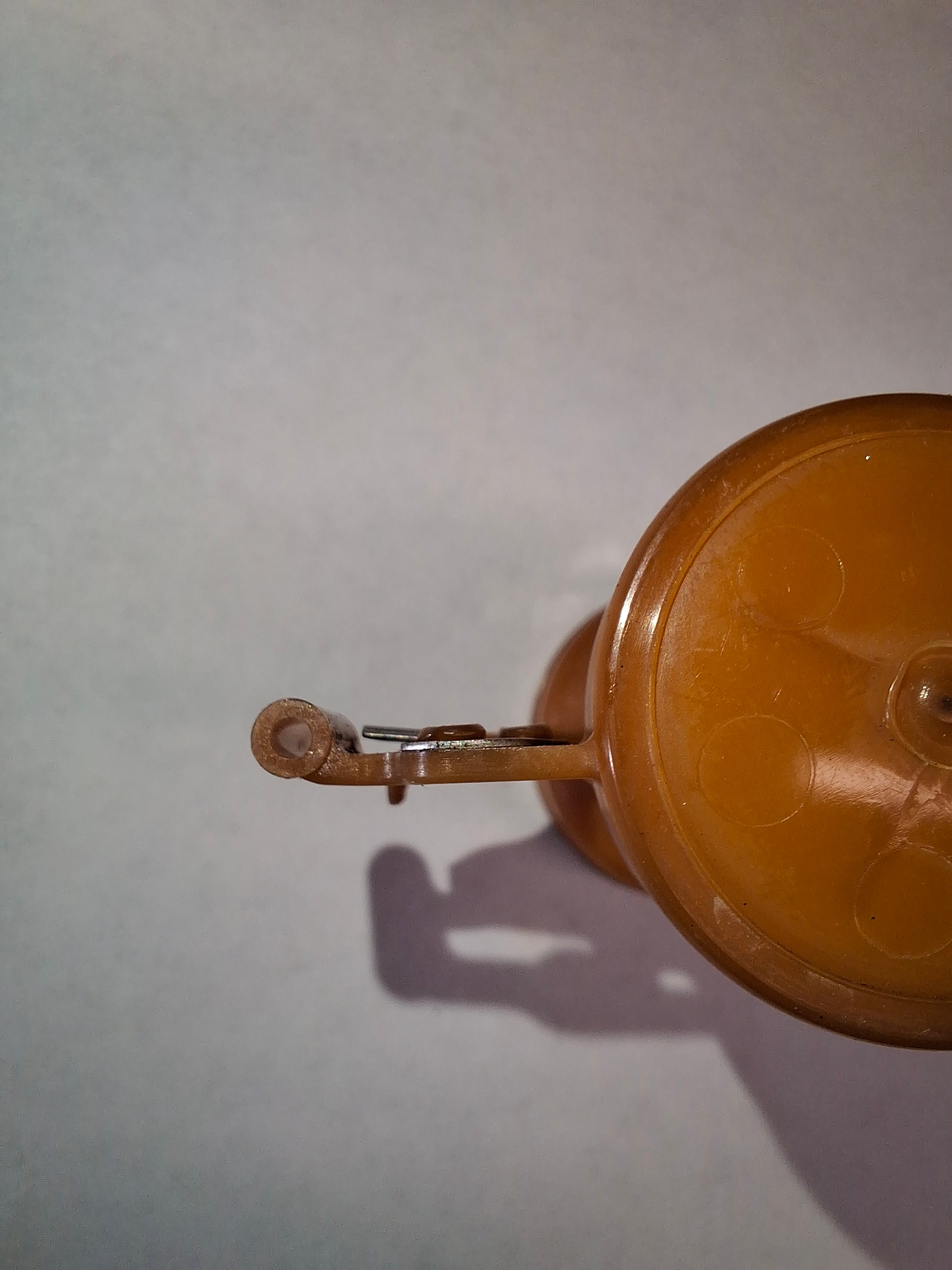

Hi there, I’m new to the world of V4 motorbikes, just having bought a VF1000F2. She is in a pretty sorry state, having been off the road for 20 years, most of that outside I believe. The carbs were in poor condition, they have been stripped, cleaned and rebuilt(V4 carbs are something else!!). I have them on the bench and carried out an initial setup. I’ve hooked them up to a fuel supply, but can’t get fuel into the float bowls. The previous owner had supplied new replacement float valve and seat kits (Tourmax 221104) - I believe they are correct for the bike. The float don’t appear to have been adjusted(I’m probably wrong :rofl: ), but I can’t think what else could be causing this issue. Hopefully someone on here has come across this before. Thanks in advance.
You have to adjust them in the same angle as they sits on the engine. Inclined 15-45 degrees from vertical. Level is 0.30 inch - 7.5 mm
Thanks Oysbot. Appreciate you providing this advice. I’ll check and adjust over the weekend. I think a PO has messed about with the floats at some point (clearer in the photos than it was to the eye). Thanks again.

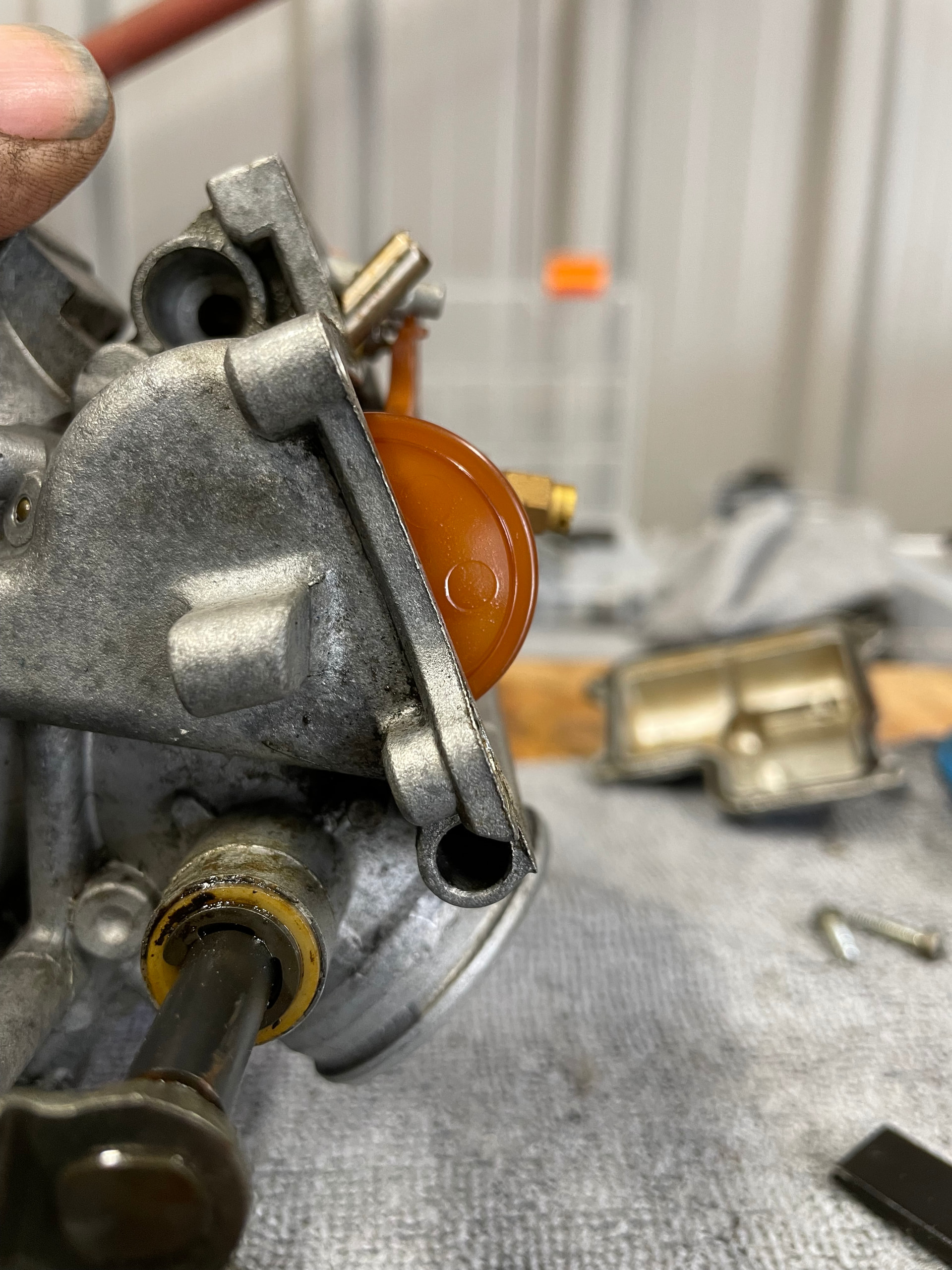

The float valves and seats are correct as is the float height quoted.Setting done with the bottom of the carb tilted back from vertical until the float tang just contacts the needle without compressing the spring.PAJ has set up VFBob an Ai assistant you can access from the front end of the vf1000.com site that explains it well,the picture may help too
Best regards bif
Thanks bif, that picture is a big help. I wasn’t sure which part of the carb was to be set at the angle but that makes it clear. I’ve a long way to go, but it’s all good (so far). Cheers
