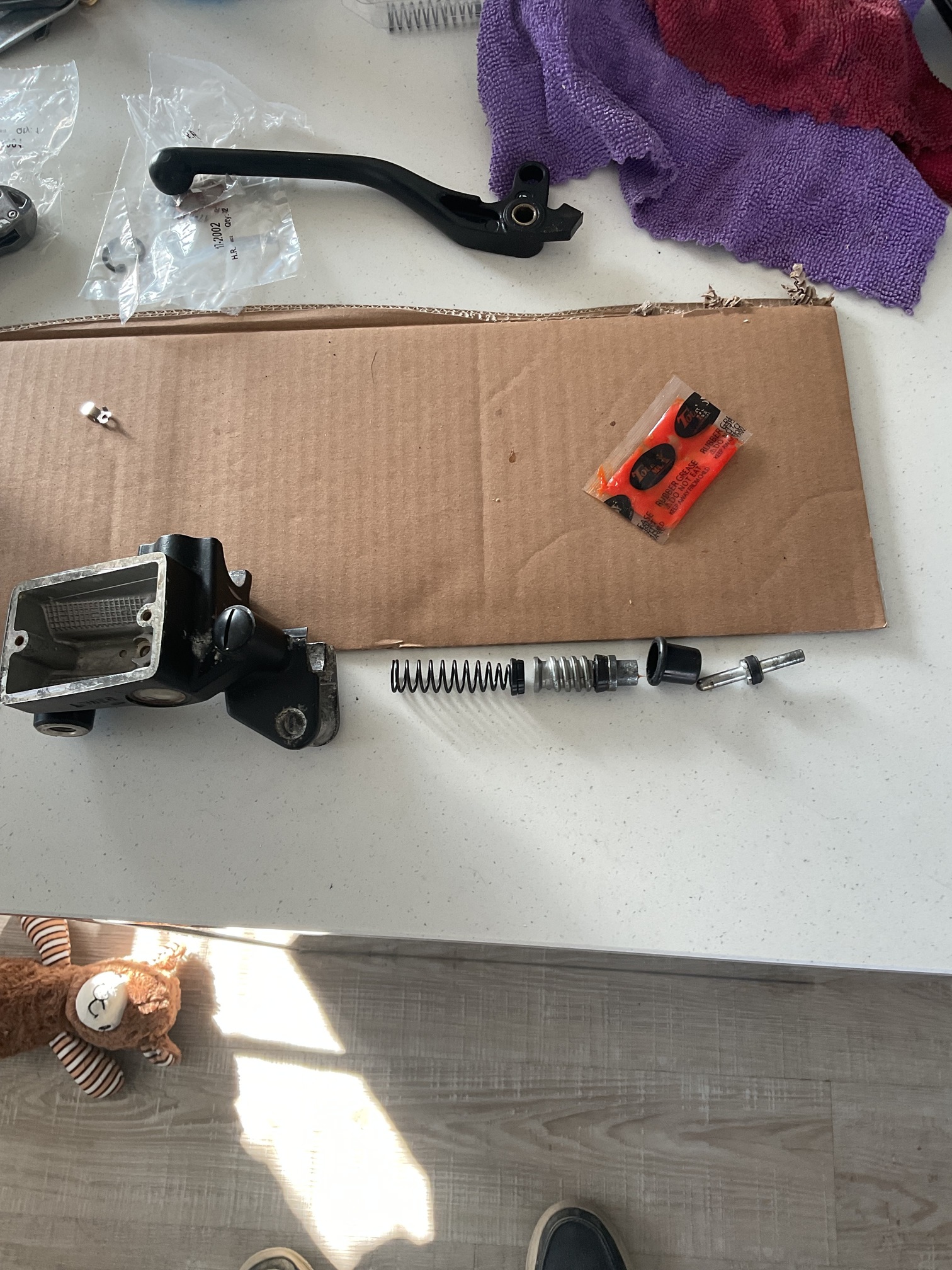

Hi can not remember which way this clutch lever kit goes… it’s been some weeks… any help please… thankyou.
Is it spring, rubber end cap, piston as pic, washer, c-clip, boot and push rod… it’s the spring I’m not sure off… it looks ok
The way you have it is correct, you just have to think about the way it works against the fluid.

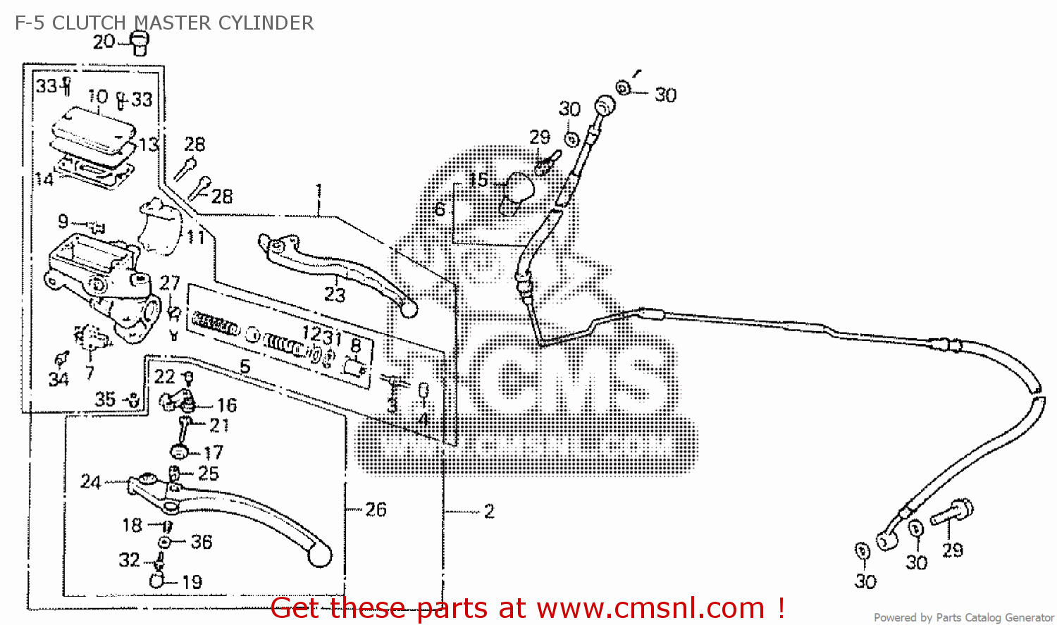

I such cases I always take a look the cmsnl partlist site. It’s not perfect, but mainly it fits my needs.
