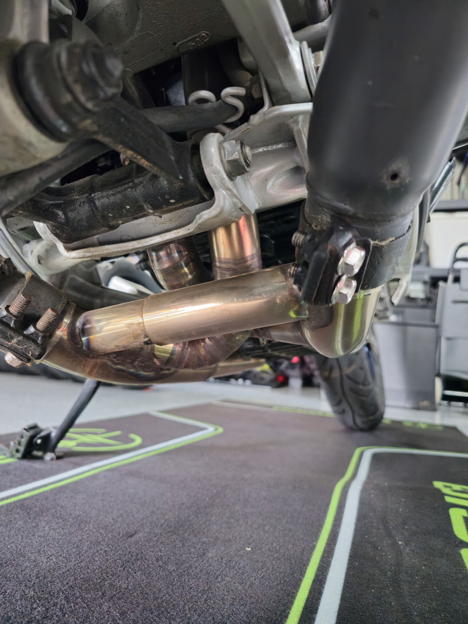

The front cyl "collars"are fitted to the collector assembly before it is welded together…no way to remove them unless you cut them off. Best thing to do is get custom headers made up. I made my own stainless “crossover” headers and did away with the silly collector setup…1/2 the weight and will never rust. Pic below looking from under the rear towards front.

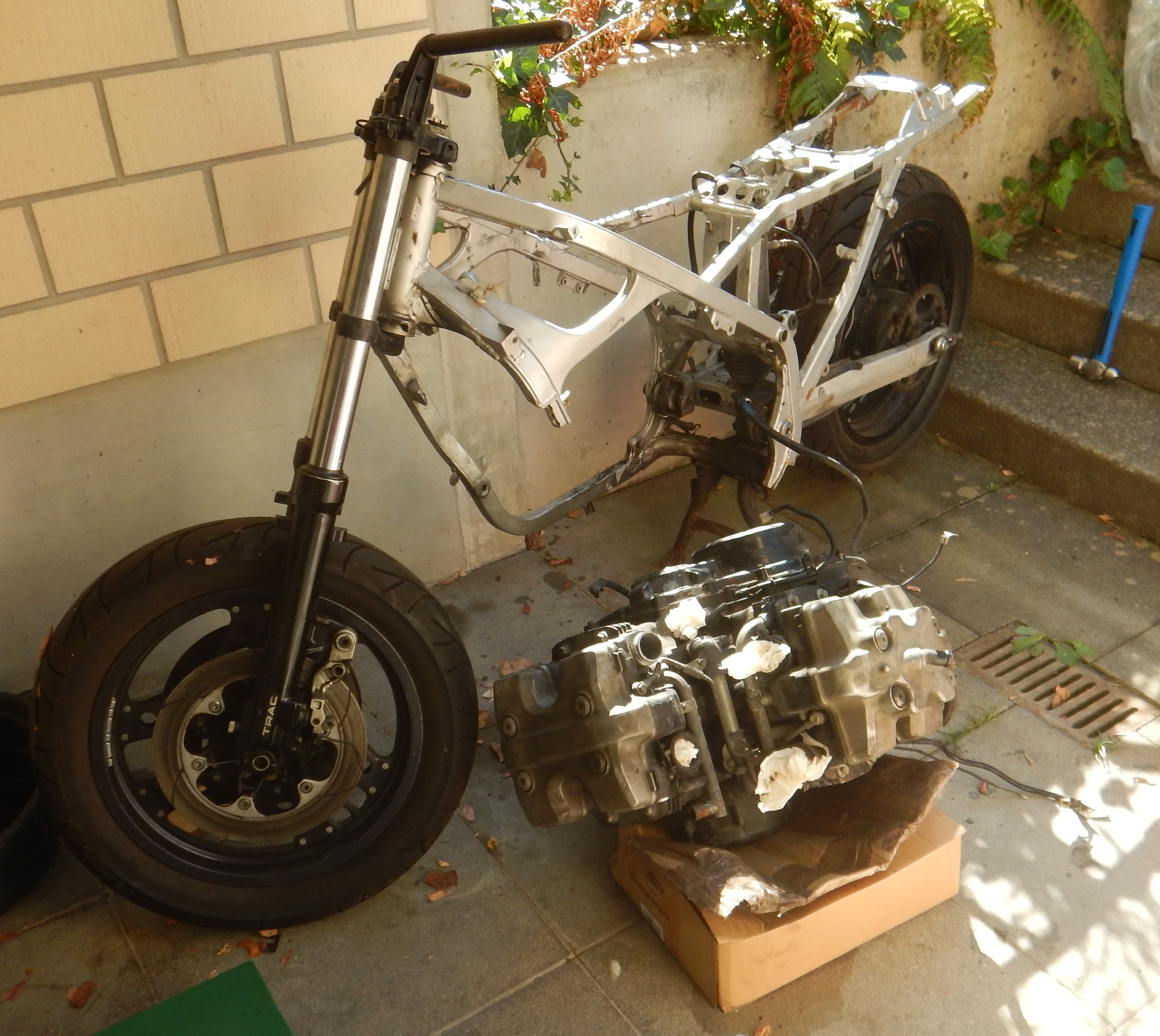

Engine is out - wasn’t that a job by myself!!
The engine weighs upwards of 90kg so its not a lightweight thing to easily man-handle. I winding up putting a jack under it just to take the weight and make it easier to remove all the mounting bolts. Once most of the mounting bolts were removed, I removed the left hand side sub-frame and then the final bolts. I just couldn’t manipulate it around enough to clear the frame and get it out, and I couple just see it crashing off the jack and onto the concrete, breaking things that either a) Cant be found, or b) are very expensive.
After a little bit of a rethink I decided to simply put a load of cardboard boxes, blankets and other various bits of padding on the ground and then lower the whole bike down onto its left hand side, with the engine landing on the boxes/padding. -Worked like a charm - O didn’t so much “remove the engine” as I did “remove the frame”. Once the engine was resting safely in its little padded sanctuary, it was quite a simple matter to move the frame around until it was clear of the engine and then just stand it back up again - leaving the engine in the boxes.
And the good news if once I could get easy access to the engine - one of the cut exhaust studs came out quite easily. There was about 2-3mm sticking out higher than the head and I was just able to get some Vice Grips on it and it backed out fairly easily. Now I’ve got to figure out how to get the last one out.

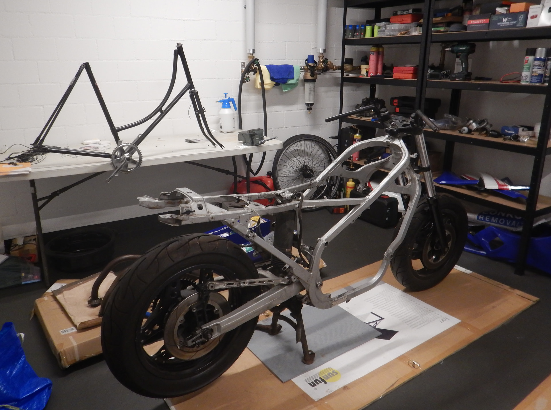

So now the whole bike - except the engine, is downstairs in my workshop. The other twin is still pretty much complete so time to get into that one as well.
Now - how do I get the Engine downstairs by myself - I’m living in a rented apartment so I’m being super careful not to damage the stairs/walls/floor etc.
