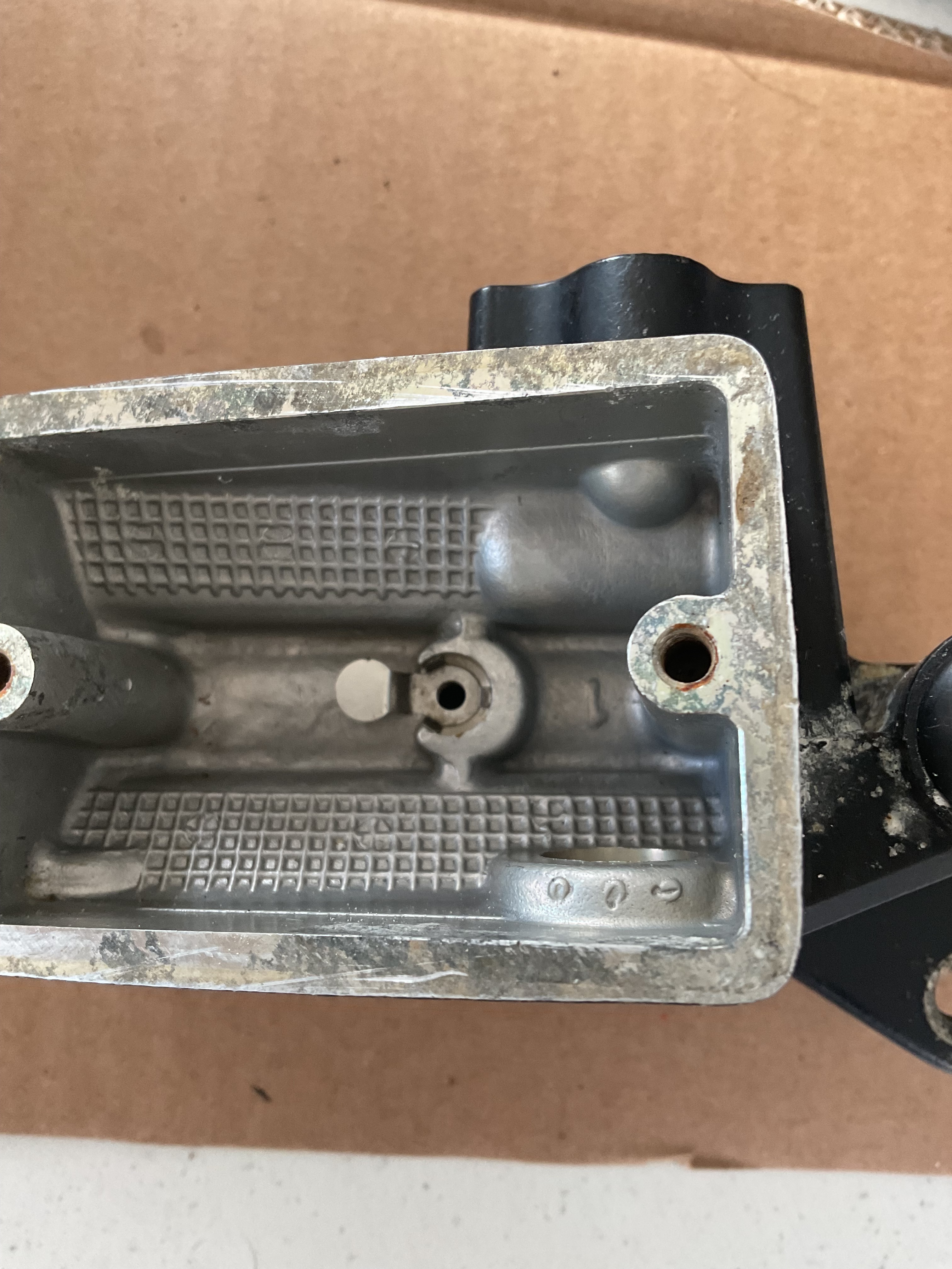

Fluild reservoir protector
Hi again Is this reservoir protector the right way round? I should’ve took photos. :sob:
Yes, underneath is a tiny “relief hole”, stops the fluid causing a fountain inside when bleeding the brakes.
