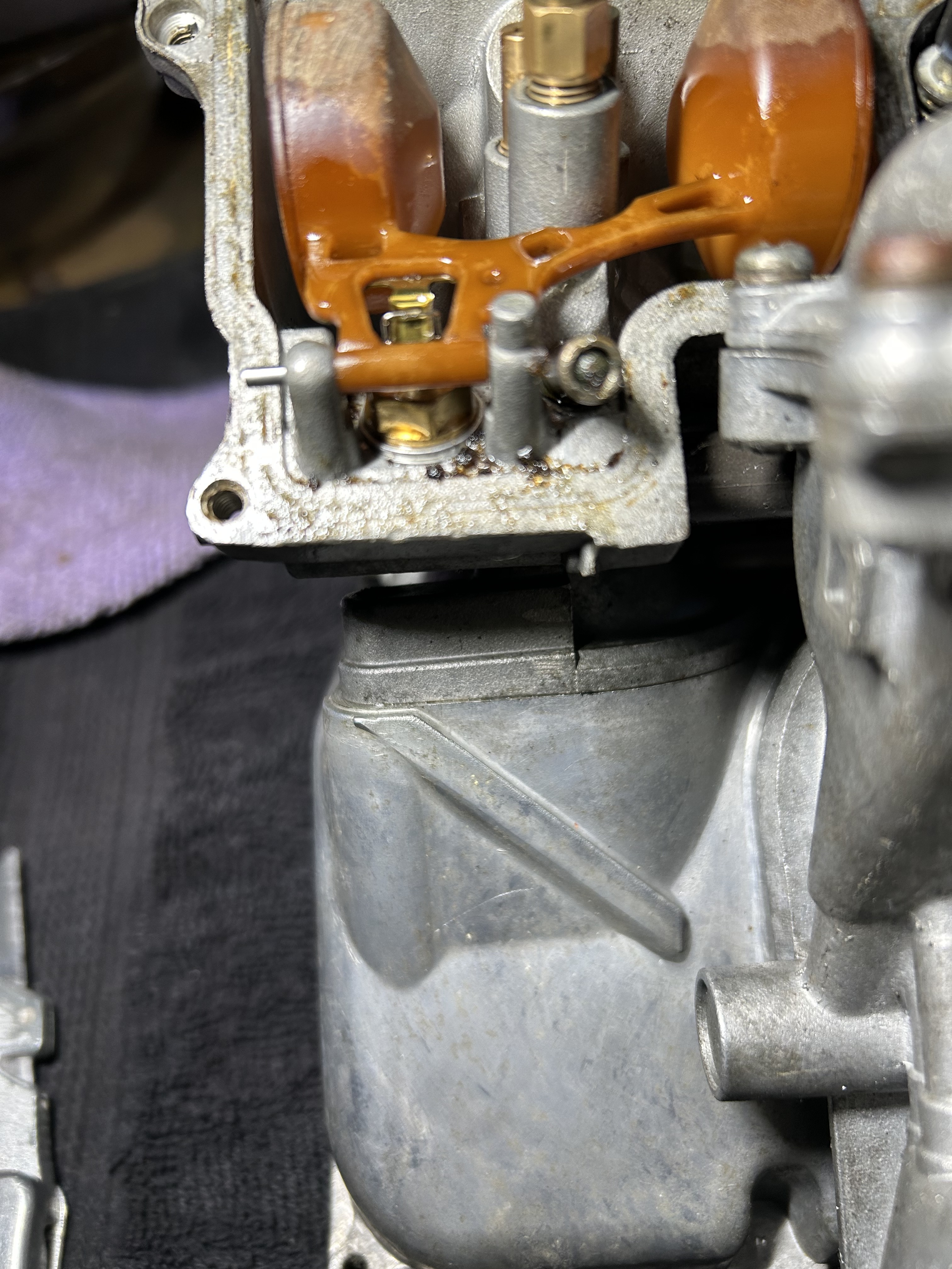

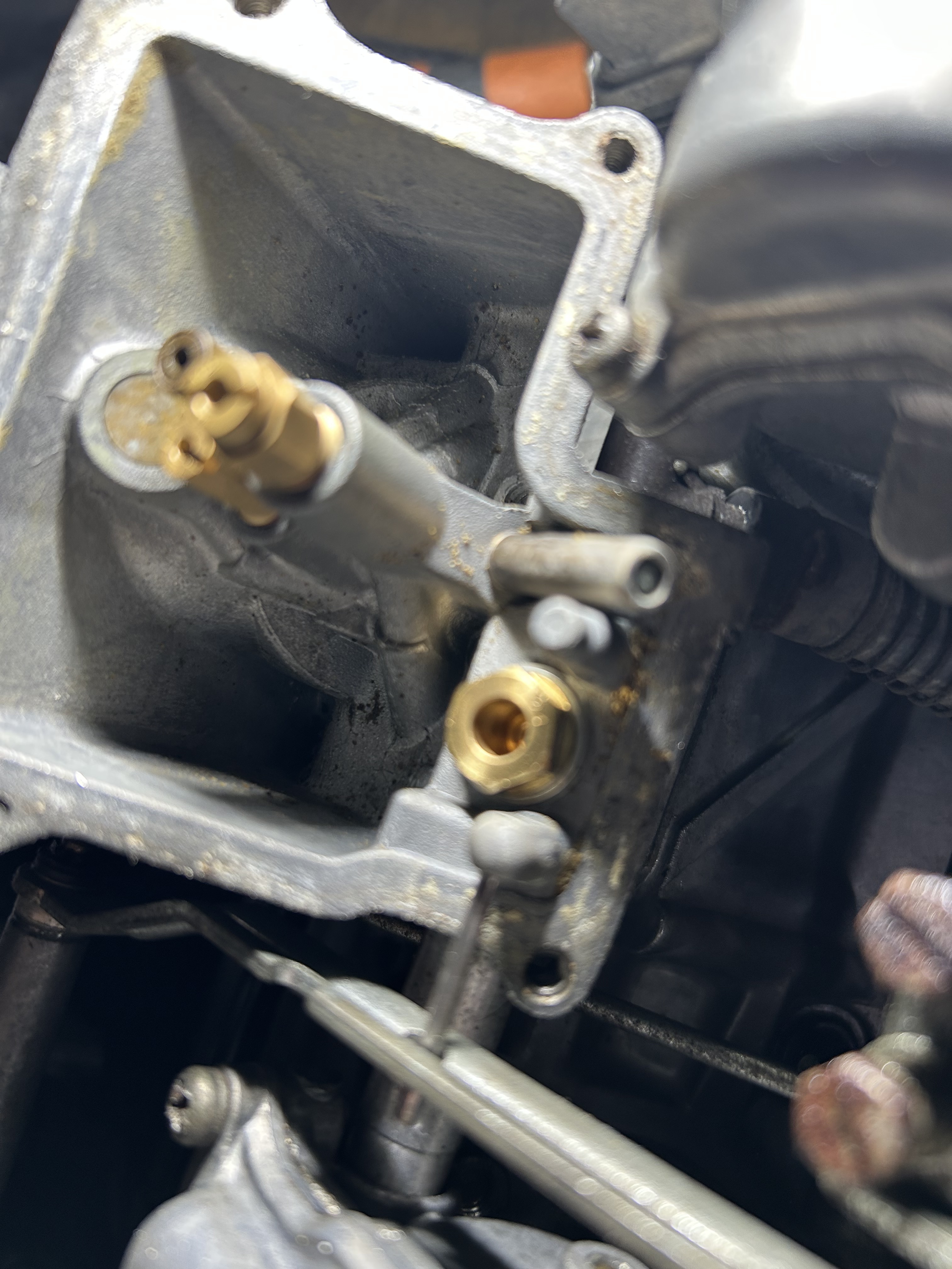

Hi, after getting my carbs stripped down sonic cleaned new parts new Fuel lines it’s been starting okay, but recently hasn’t been… so I stripped the carbs out again and took the float bowls off and found quite a lot dark orange debris in them… It’s had a new filter, but there’s no muck in the filter. I’m not using the main tank just using a fuel drip bottle. The only part I haven’t changed is the fuel pump, but surely the filter would’ve caught any debris in that very frustrated. :weary:
Hi, I’m sure the filter is in front of the pump. So if the parts have been before your cleaning activities in the pump, it goes directly to the carbs.
I made also the expierience that the filter is not fine enough to sort out rust parts.
Yeah, I think I messed up there. I didn’t think about the fuel line between the filter and the carb… :pensive::+1:
