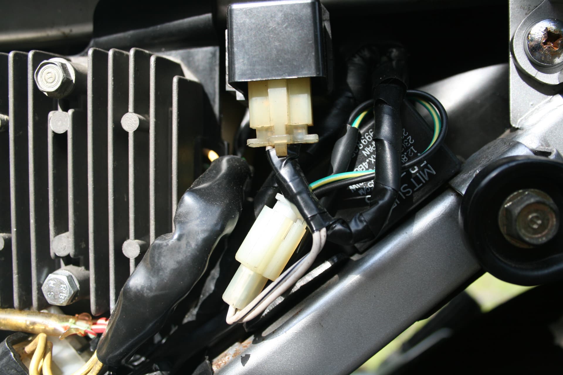

They run only when the engine is running and the fuel pressure in the line drops below a certain point. There is also a pump relay behind the left side cover which you can bypass to make the pump work if you need to “fill” the carbs.

I bypassed mine because of a bad relay.
The only neg is that it will pump fuel if the ignition is on and pressure can’t build up as in a leak or fall off.
Positively though. It will fill the carbs when you turn ignition on so you are not cranking away for ages knackering the starter system and battery.
You will hear a reassuring fast click click click…..from the pump until it’s pressurised. Way better starting after a lay up.
I still help mine along with a squirt of easy start

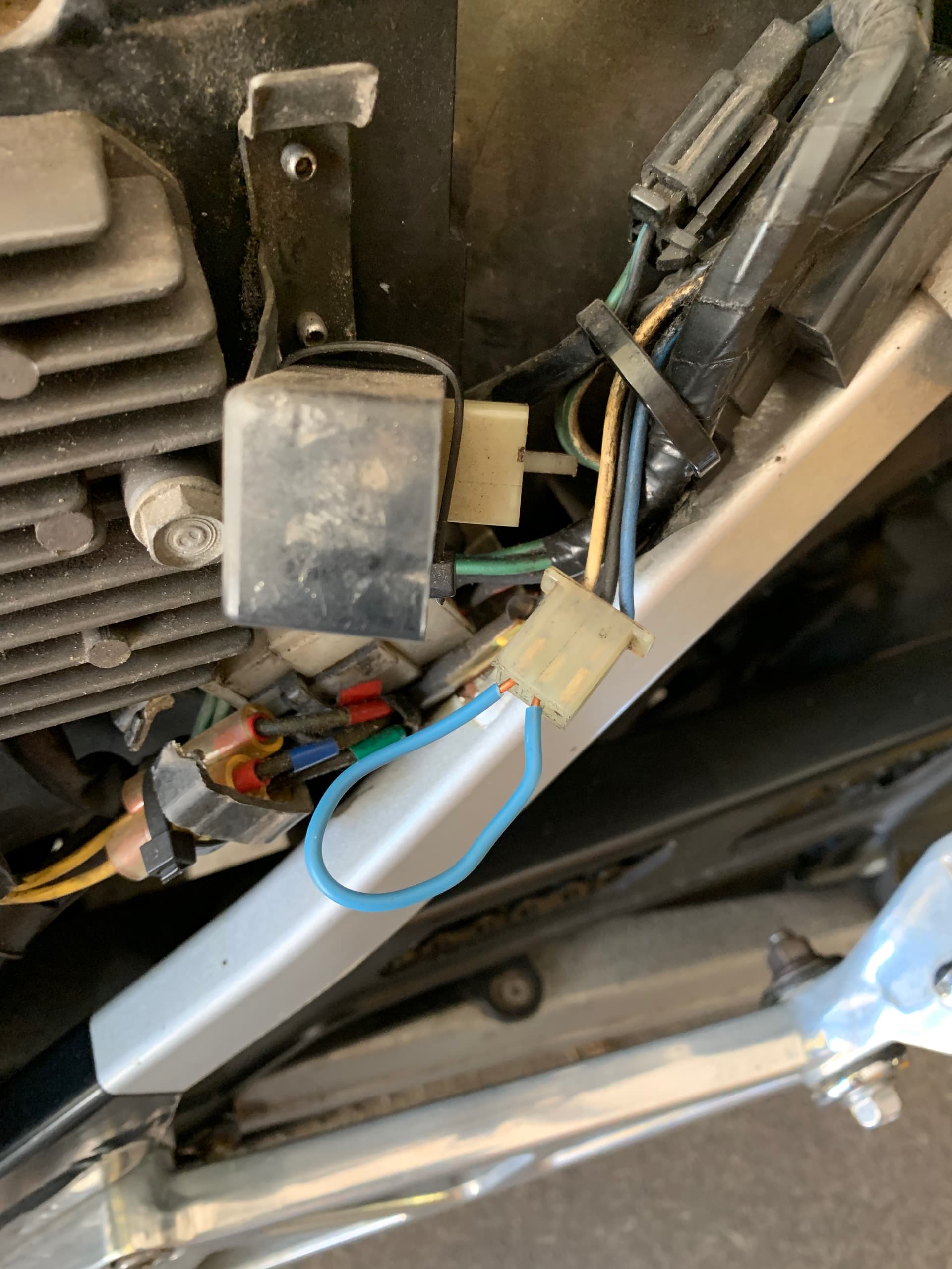

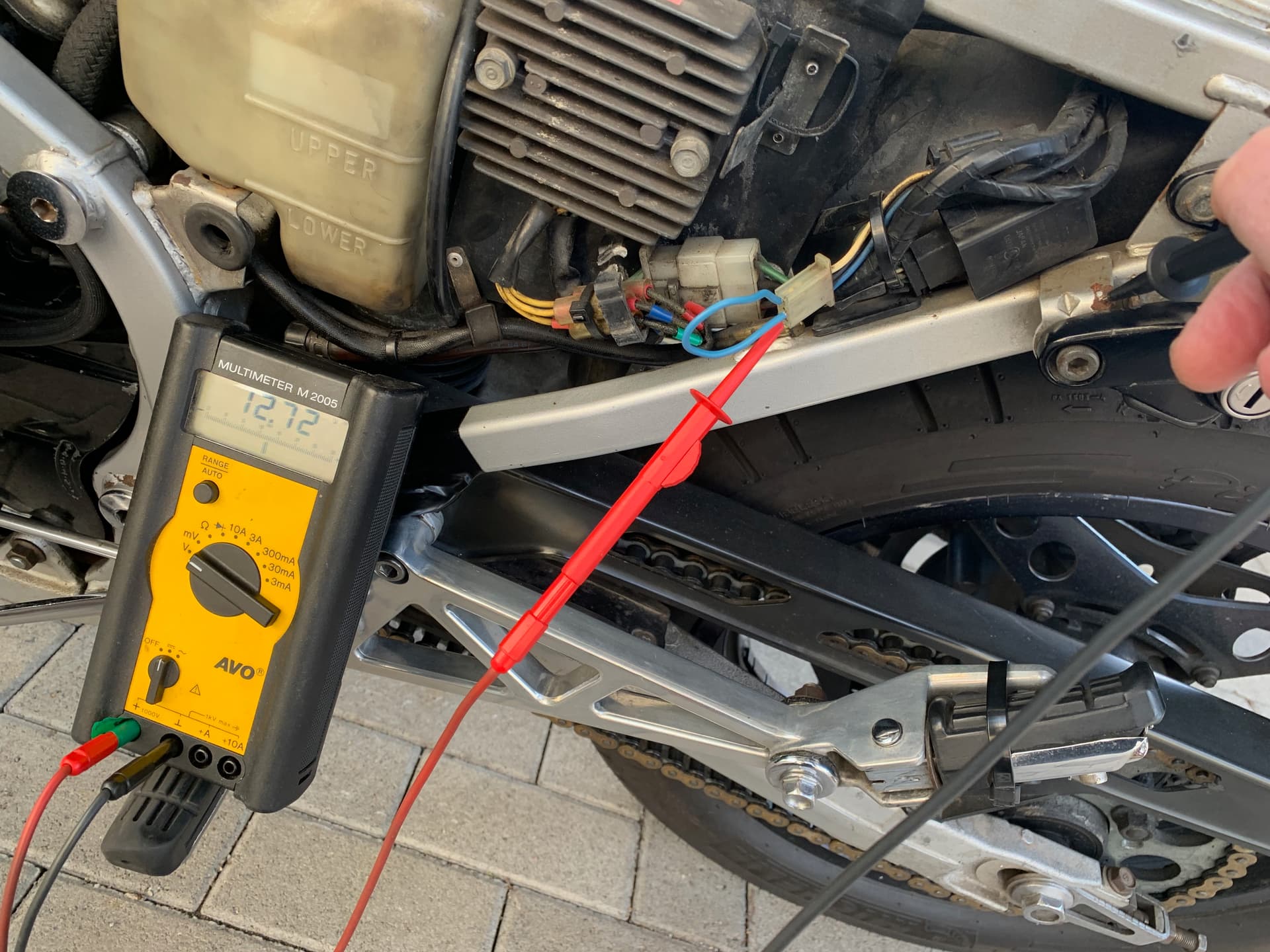

Hi good info- r u saying you’ve put 12v directly to the pump (from acc) and if so is it the black/ blue wire positive and green neg ?
My FE is always stored over Winter and I always empty the carbs. Come the spring I jumper the fuel pump (see photo), ignition on for a few mins until the carbs are primed and it starts first press of the button.
On the FE you should see 12V on the blue when the bike is running - this is what runs the pump (via the relay) during normal operation.

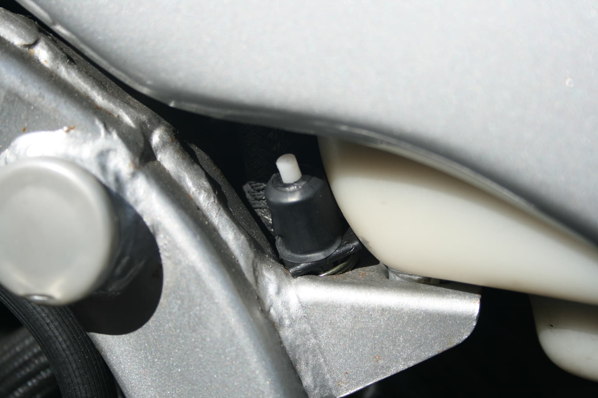

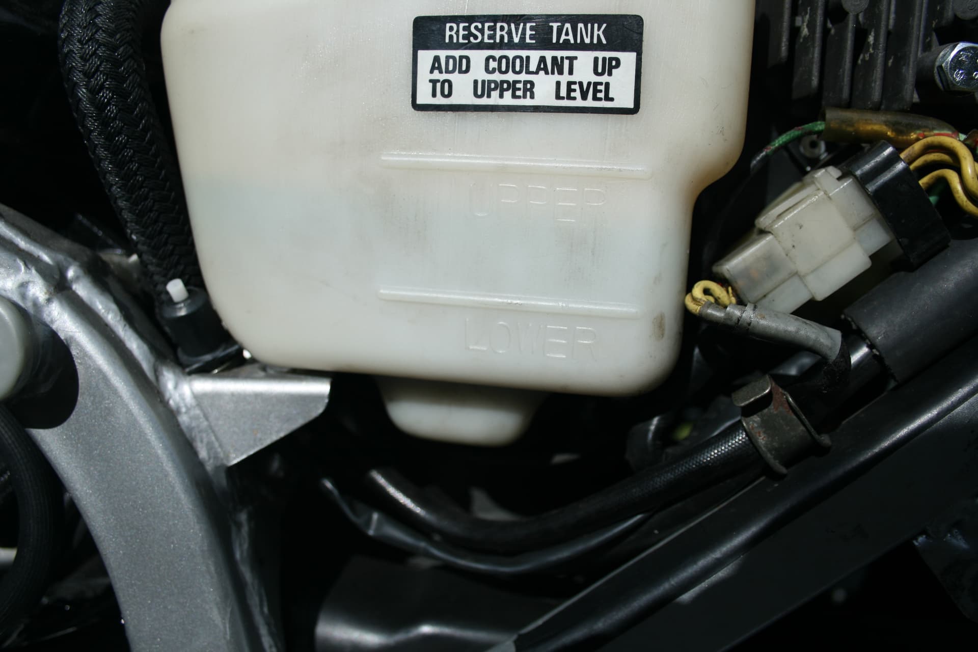

After an earlier reading of this post I added my own “carb tickler” using a front brake switch I had lying around that I converted to be “on” when pressed, rather than “off”. I siamesed the wires into the existing connector - the black and green/yellow wires in the picture. Now I can prime the carbs on every cold start.
