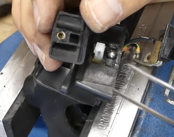

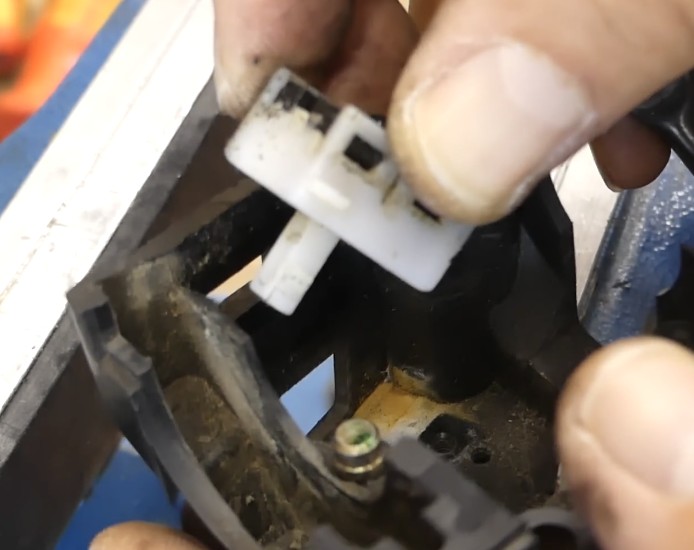

I found a video about CB400N and took some screenshots. Maybe it is the same, but If anybody knows it, I take that information.
There you pull it to the front and a ball/spring ist used to determine position. And there ist a hook in the white housing.
