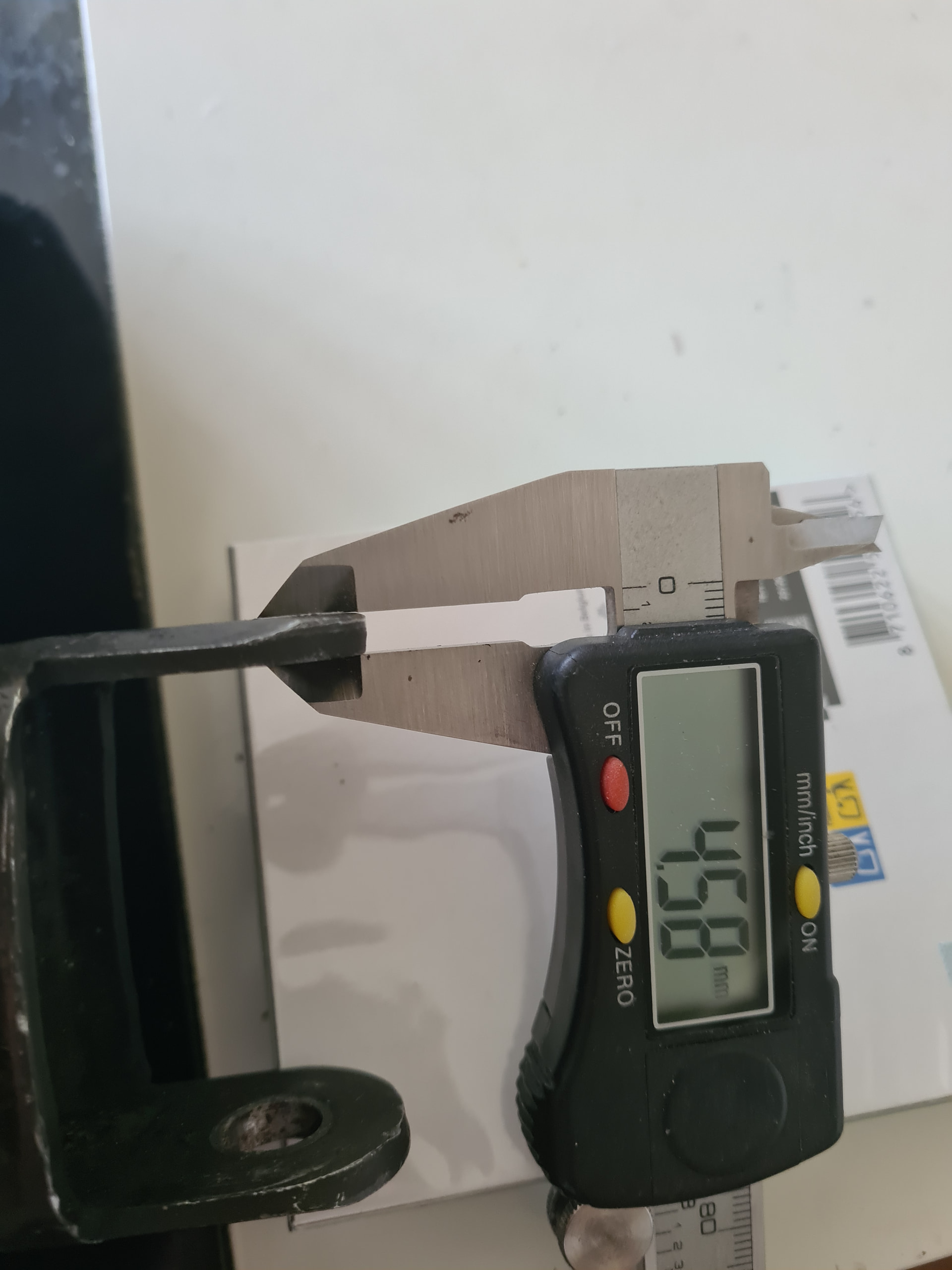

Unfortunately bike rear continues around 3 cm lower than it should, (Can’t hardly raise the bike to central stand) and I’m unable to find what is wrong, as told in old posts.

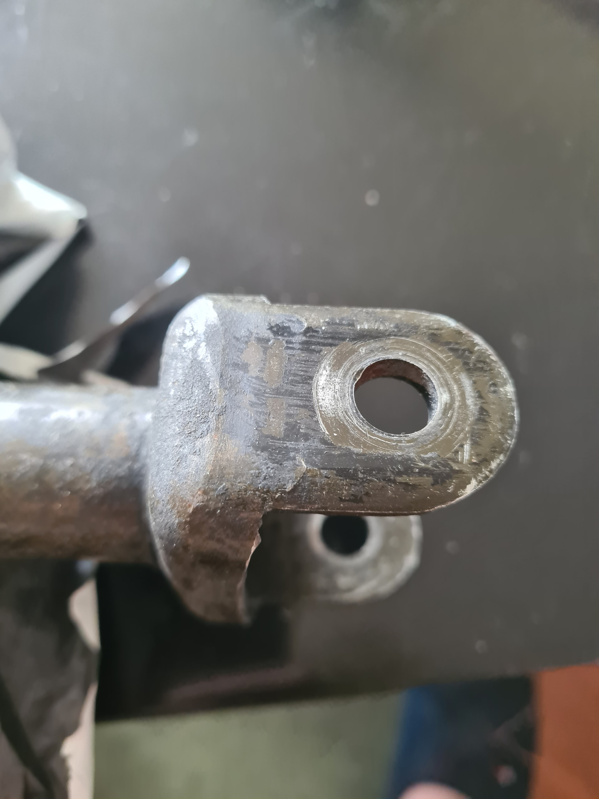

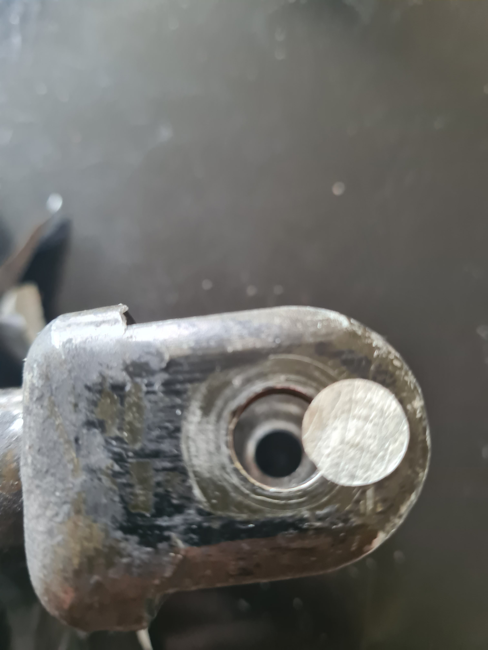

I though the possiblity to extend the shock efective lenght by adding a new hole to the lower support.
In the photos is shown the new hole position, it’s 7mm away, that will raise back around 18 mm. Enough to raise back and ease lifting to the stand, as tested adding some heigh to the rear floor.

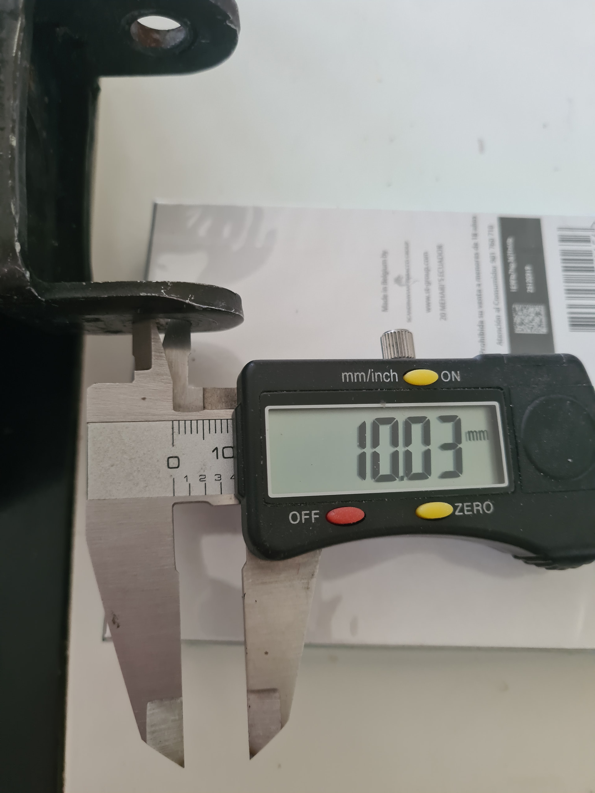

My concern is if it will be resistant enough, simply filling the old hole with a 10 mm. molded (half moon) bolt section.
But the lower section of the support, will be roughly 2 mm,
May it be enough to withstand normal routing and bumps ???
In theory yes, but I’m not a mechanic, so don’t know every secret of nuts and bolts.
Any comment or experience will be most appreciated.
Thanks again and best regards.

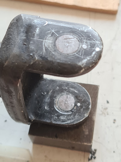

I started modifying bottom support, adding steel fillers to existing holes and making new holes 6 mm lower.
As I was doing it I noticed lower part of support, will keep only 3mm steel on the bottom part to support all bumps and returns while riding.
Although any engineer could maybe confirm it is enough to stand those, I though at last, I was being a bit stupid trying to improve a 40 years old shock that was far from perfection in first place.
So I will try to find a “budget” YSS that can be adjusted to 41 cm length and accept that some things are better than original.
Anyway thanks to all for your ideas ans support, only by means of you all I went a bit clever.
Kindest regards from Spain
Ricardo
