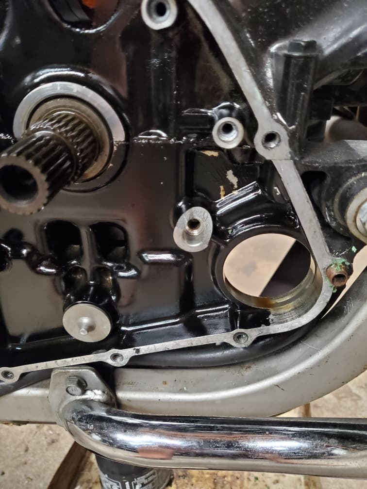

I’m new to the forum but I have been a VF owner right out of high school, buying my brand new “84” VF700F. A few years later, I was lucky enough to acquire the VF1000F. Both are kept in very good condition without any engine issues (cams) except the occasional carb rebuilds and both bikes have over 25k miles on them. However, recently I was trying to diagnose a slow starting problem on the VF1000F. It turns out that a vendor misdiagnosed a faulty starter and said the starter was fine. I then went internal and long story short, I broke the interim starter gear case sleeve (mybad)!!! This holds the gear shaft in place and I patched it with JB Weld but it didn’t last long (2 yrs). It turned out it was a bad starter.
Here is my question, I think I found a donor engine and would like to swap the lower cases from my perfectly running engine with the bottom half of the donor motor. Can I do this with minimal surgery to the engine?
What are your thoughts?

I would suggest getting it welded and re-drilled - using a really reputable welder. This may be a better option. Could it be done without removing the engine? The key is getting the hole re-drilled exactly perpendicular. An expert welder might know exactly what to do and could advise.
Another option would be to visit an engineering shop and see if they can machine away the damage with a cordless drill mounted hollow end mill or annular cutter. A threaded shaft screwed into the threaded hole that fits inside the cutter would pilot the cutter and maintain squareness.
The casting that is machined away can be replaced with an aluminium or steel spacer sized to suit. I did this with a broken oil pump boss but of course the cases were fully disassembled and the operation performed on a milling machine.
There you go. you have three suggestions already and I think you will get more.
Another one would be to check the numbers and letters on the donor motor. You never know they could be the same as yours? Weight them all up carefully before making your mind up. Getting a good machine shop to weld and redrill or drill and use a spacer while still in the frame would certainly be the cheapest and quickest way to go.

Go to a reputable machine shop or maybe by asking a Motorbike shop or showing them.
I found a couple of machine shops locally and will show them the picture of the damage and see what they say. How hard is it to remove the JB weld?
