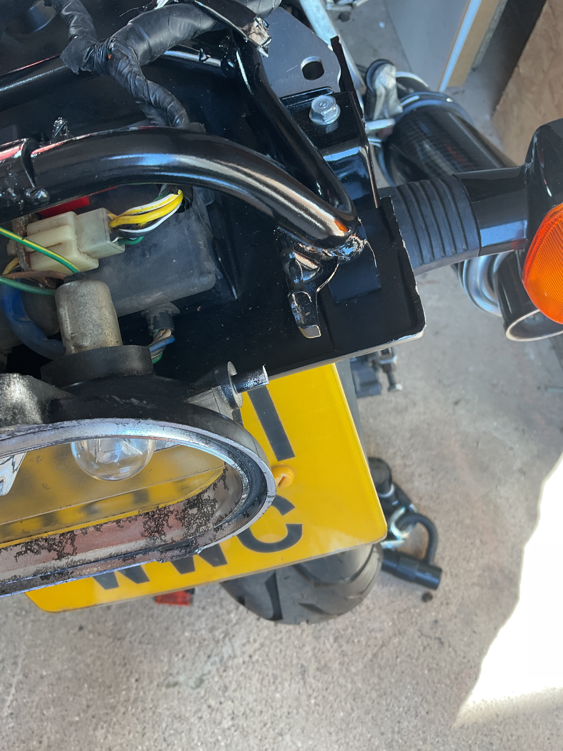

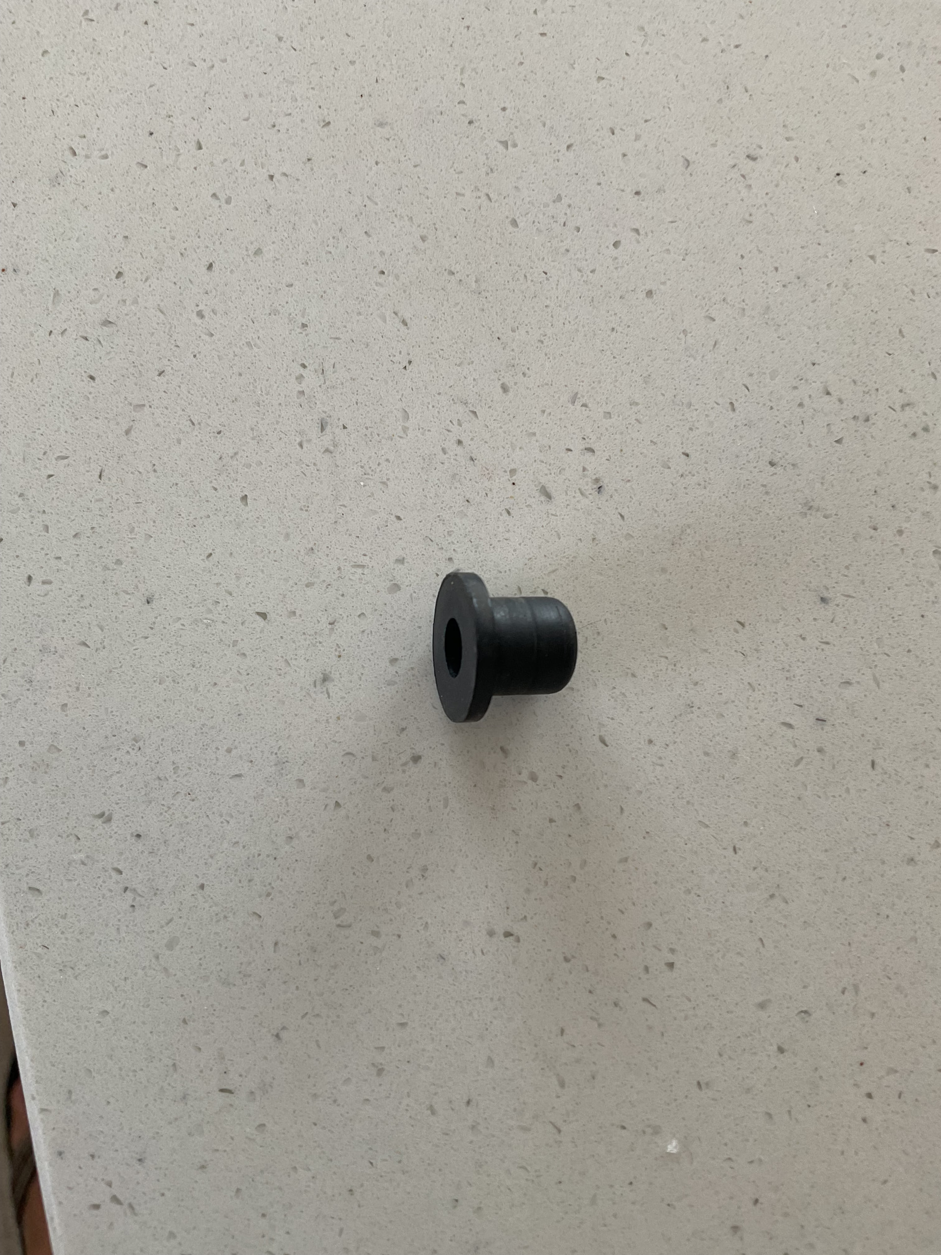

VF1000R 84 rubber mount for rear rail light
Hello I’m looking for the little rubber mount for the rear light if anyone has one for sale. Thankyou Sean
They’re cheap and available from CMSNL in the Netherlands…Pn: 19113MB1870. I bought a pair for my RE resto.

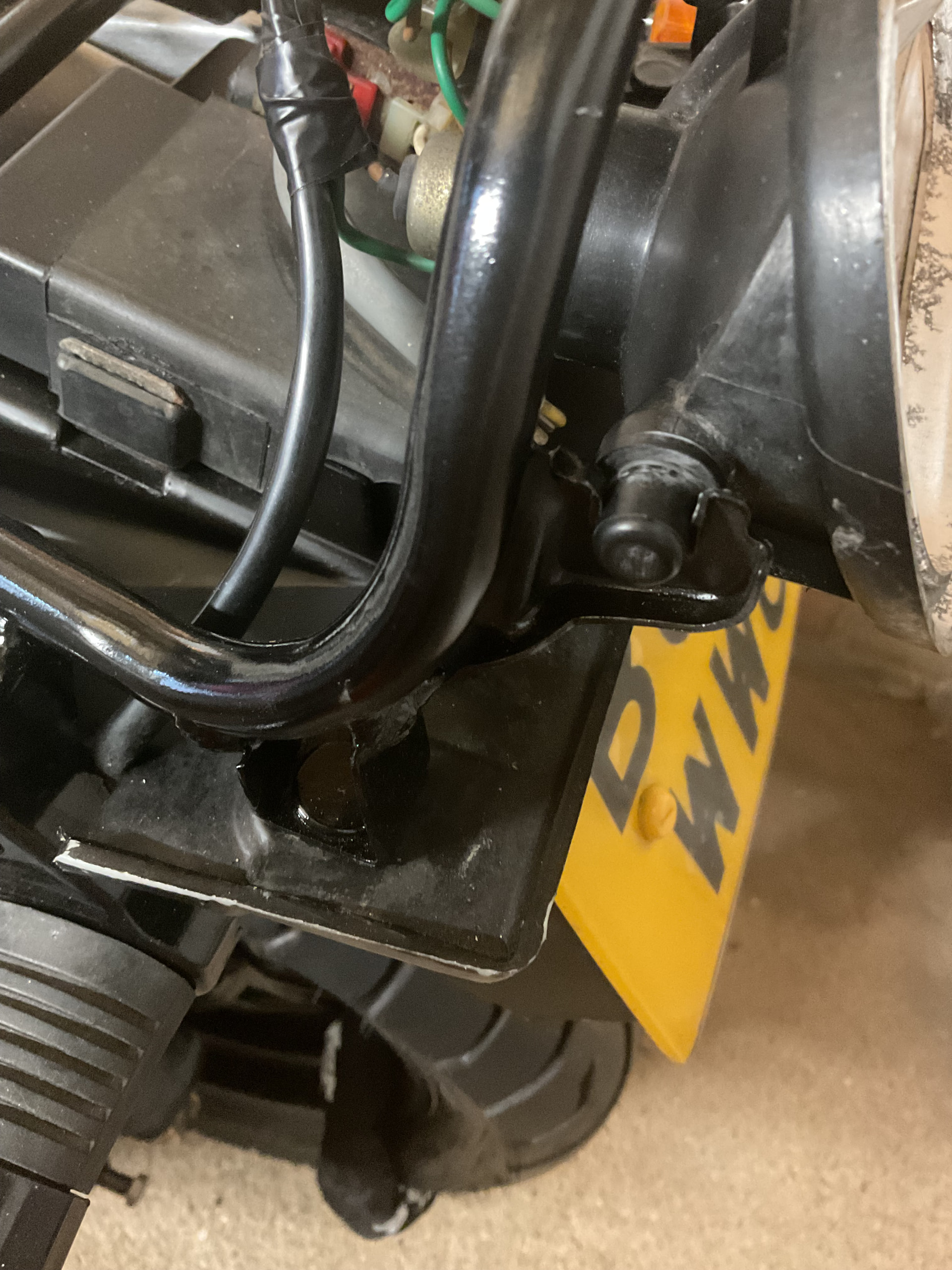

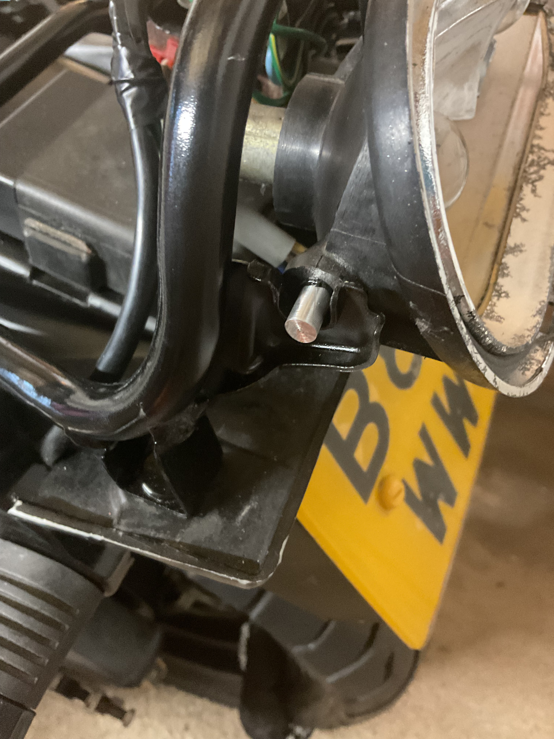

made a little 6mm aluminium peg to replace the broken one.. drilled a 6mm hole in the housing and glued it in place… new rubber bung.. happy days :+1:
