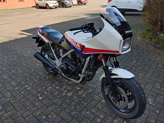

1984 VF1000FE Rebuild

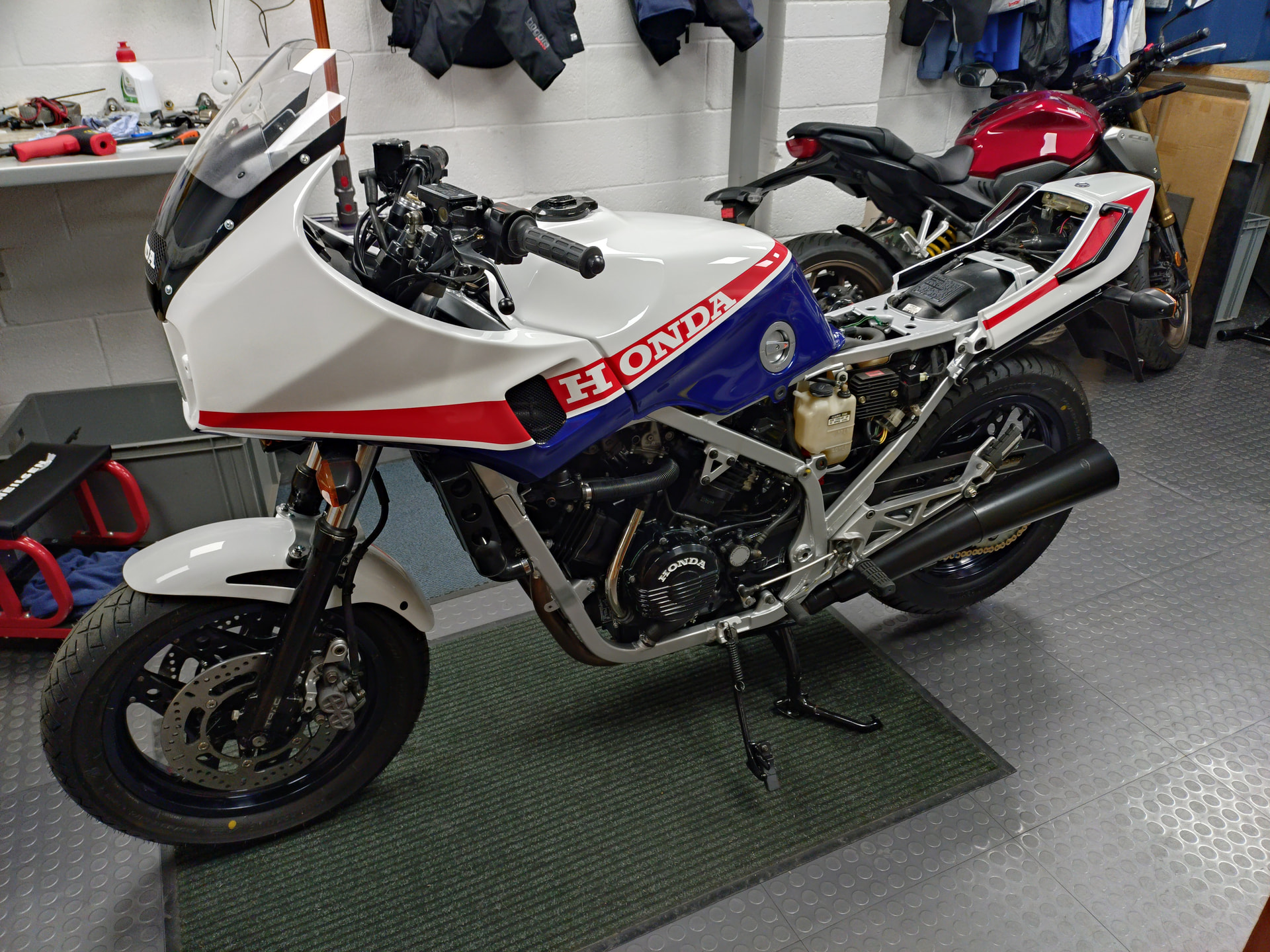

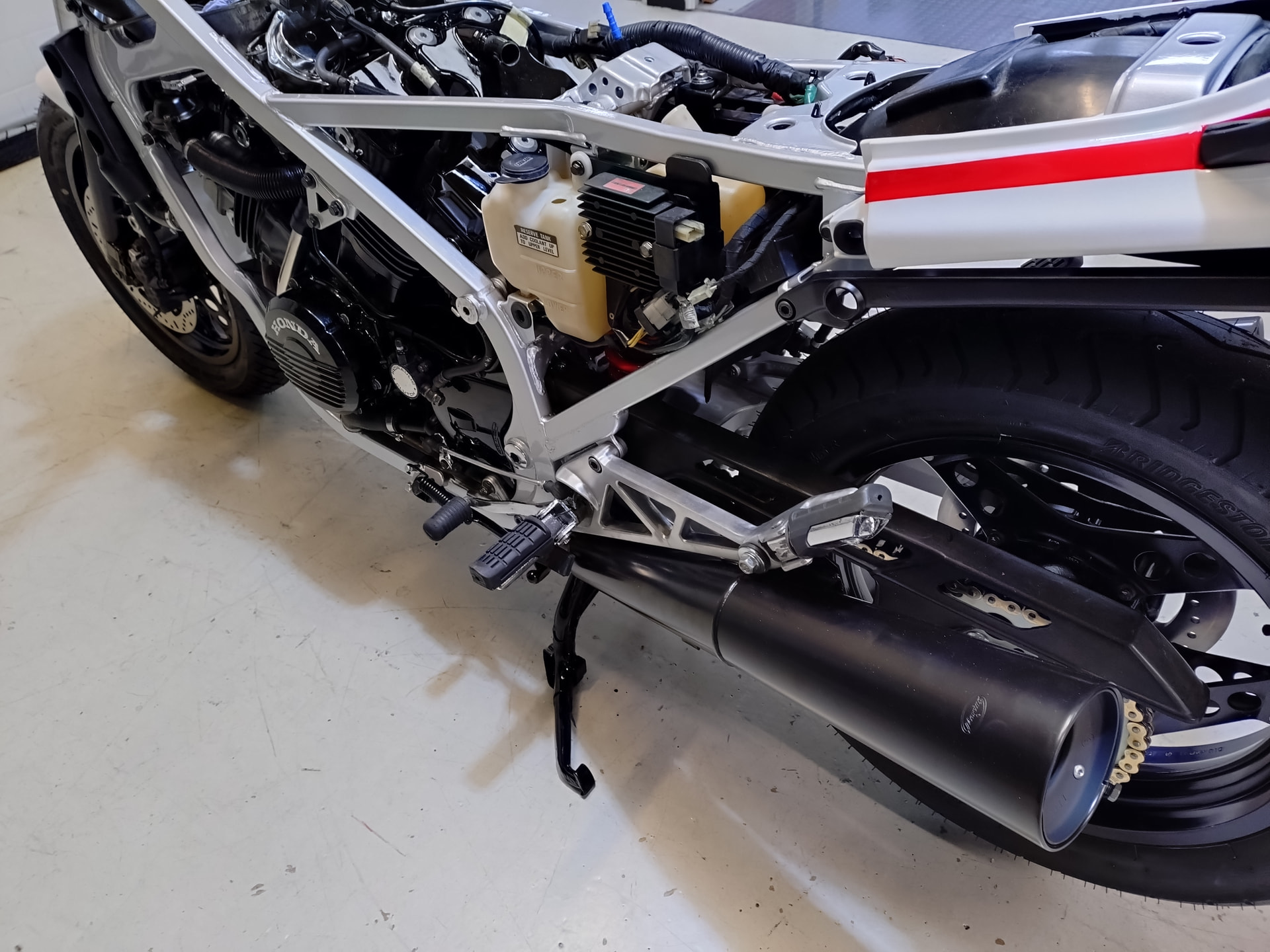

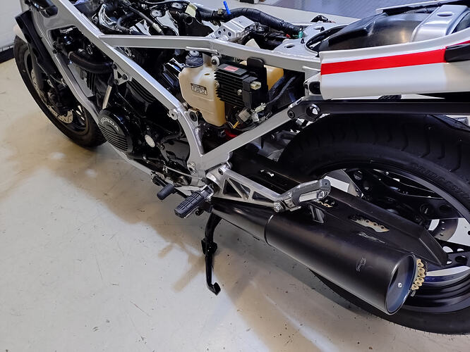

Well, she runs & for a lash-up first start she ran okay, no nasty noises etc :slightly_smiling_face:

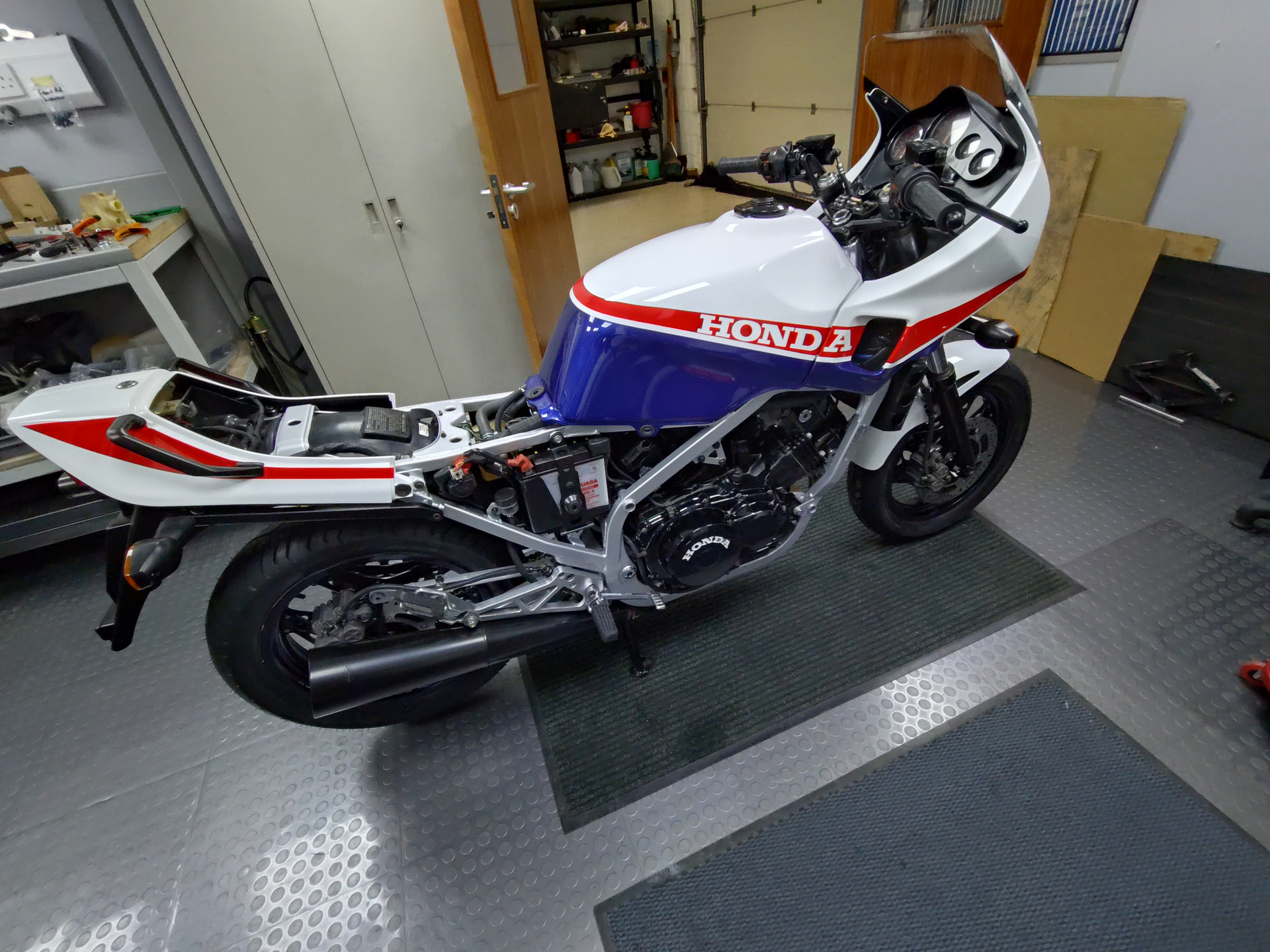

Looking great Norman, some excellent work there :+1:t2:
That’s a very nice job right there.
Great job and attention to detail
Looks like a great job you’ve done. Fabulous indeed :grinning_face_with_smiling_eyes:
There’s only one comment left to make: Looks like better than new.

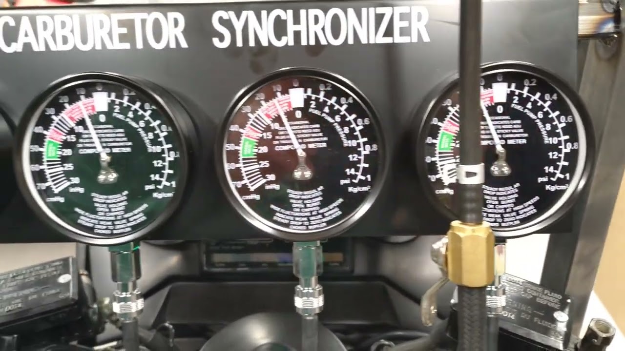

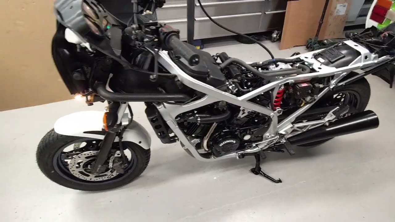

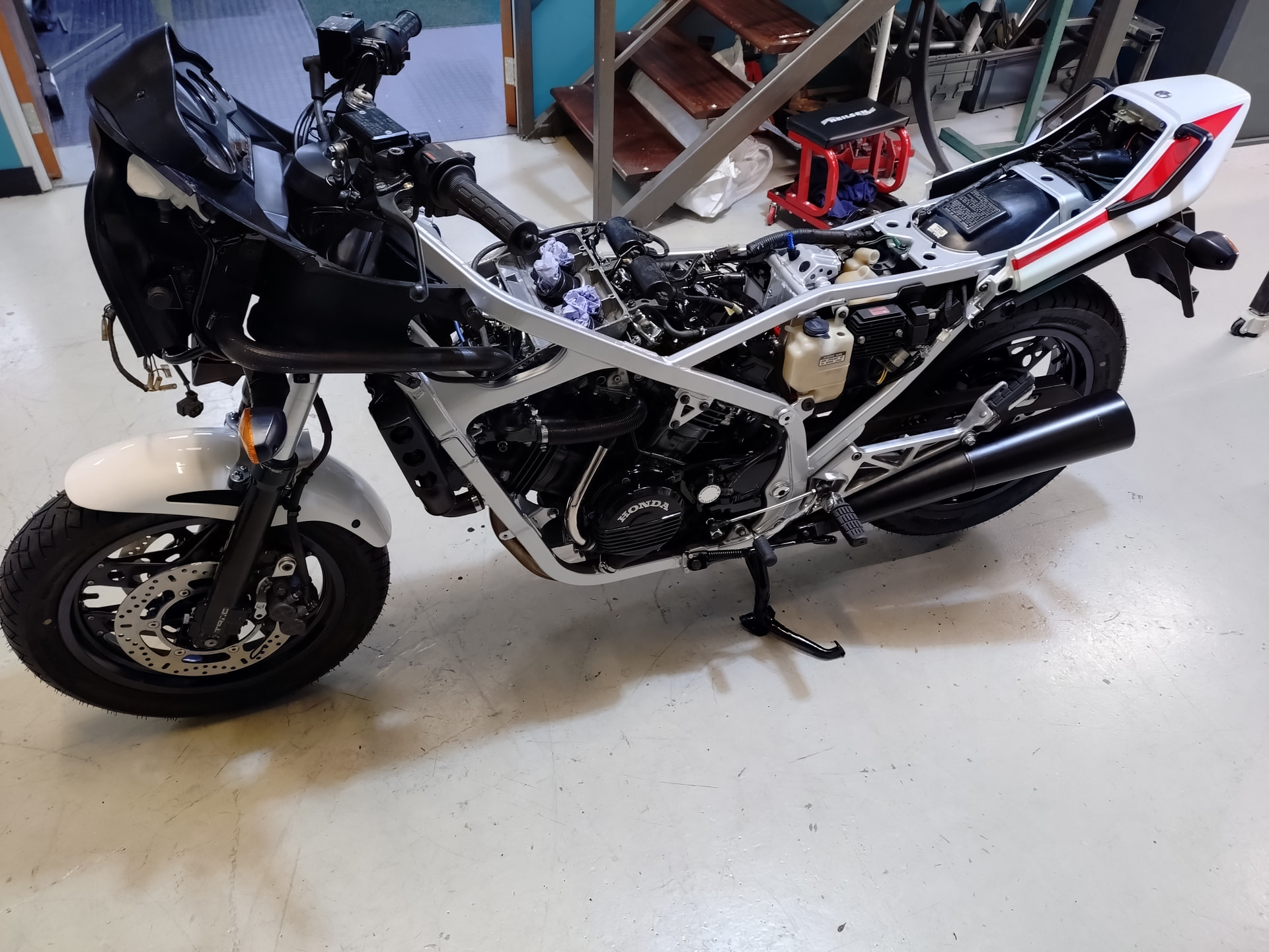

First run to warm it up for carb sync :
Carb sync results :

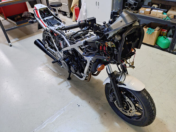

When i first tried to run the fuel pump after sitting unused for nearly 15 years it started smoking, then eventually made a popping sound & seemed to be okay.
After doing the carb sync i figured i ought to check the pump & fuel delivery was a dribble so i guess it’s caput so I’m now on with a VFR750 pump install

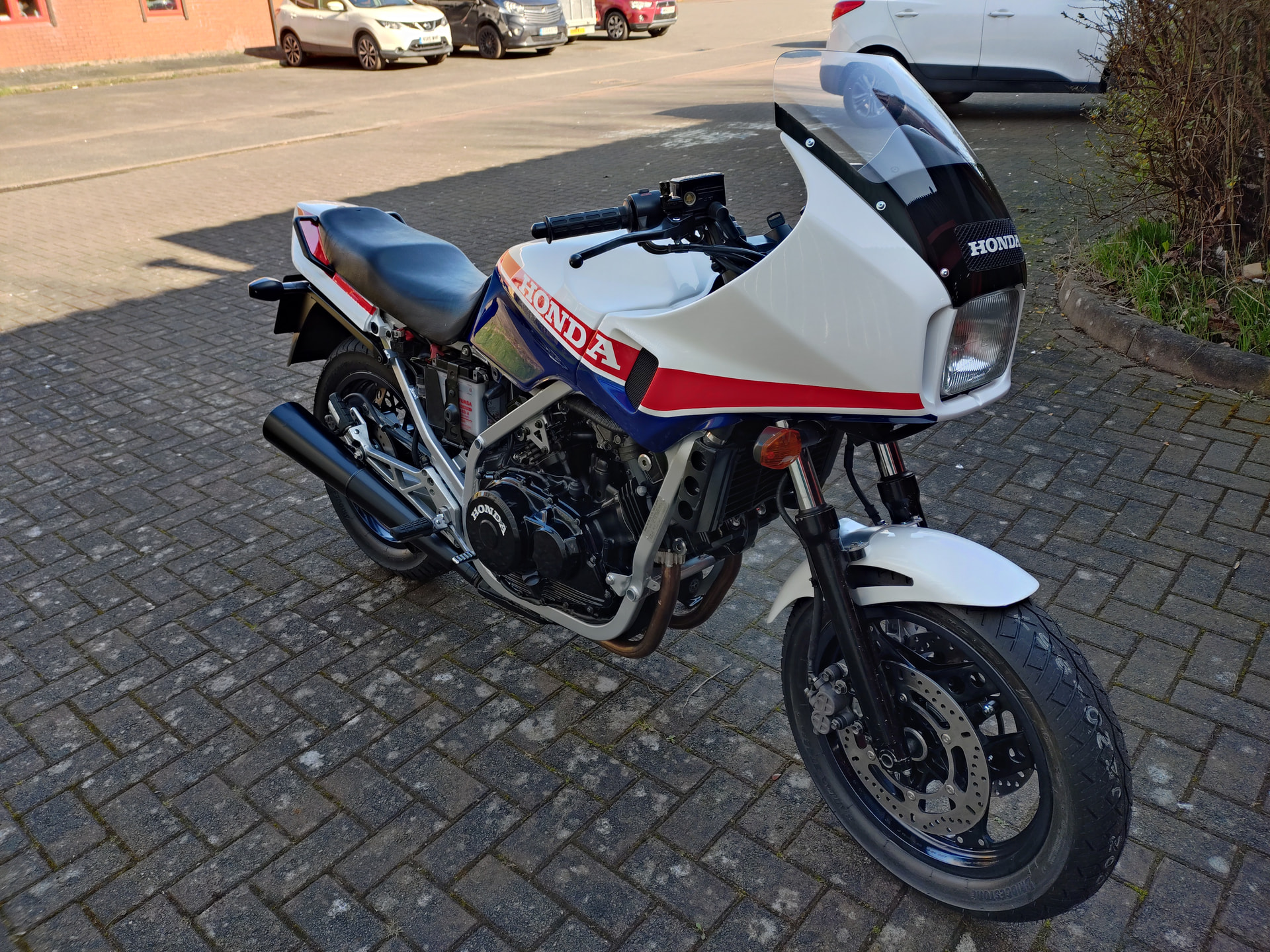

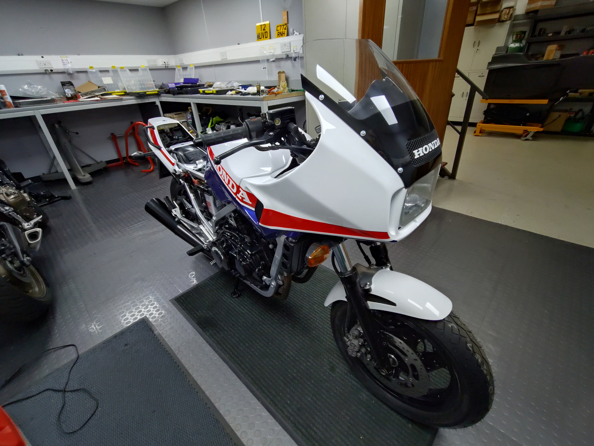

Test fit of the fairing, I’ve insured it today and I’m hoping to give it a first ride around the block maybe Thursday
Test ride completed & apart from something weird going on with the neutral light (stays on in first gear with the clutch in, let the clutch out & it goes off !) everything seems fine, riding position is odd after modern bikes ( need short legs & long arms), motor runs really nice, carburates nice a clean & its surprisingly fast too :+1:
