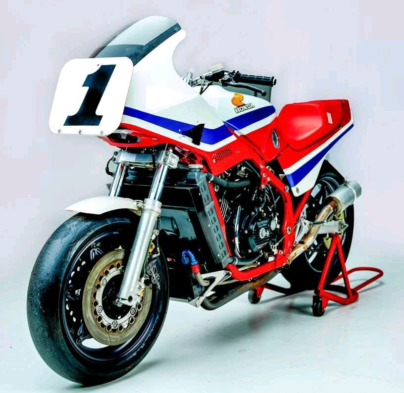

I contacted a company near me called tank restore but they can’t deal with pin holes so I’ve ordered a kit from sureseal. It’s a 2 pack epoxy. My next big issue is the frame which has rusted around the left footrest. It has been welded but there are still holes and I’d like another frame. Oh and the exhaust collector is very rust around the connection to the right muffler. Thinking of blanking it off and having a single less restricted end can. Hoping to achieve a similar back pressure but a bit more noise. Would be good if I can get this rust bucket back on the road looking more like this.
