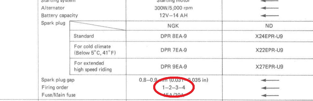

This out of my VF1000R manual:
This out of the V45 (750) Sabre/Magna Manual:
Hope this helps,
