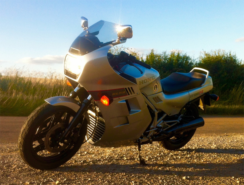

Anyhow - was really great to be back on the VF on Saturday:
[ul][li]Young lad working the till in the garage ‘That looks a nice bike - is it new? Not seen one of those before’[/li]
[li]Guy on a Honda VFR came up alongside on the main road @ 50 ish - looked the bike up and down and gave me thumbs up![/li][/ul]
Getting the impression that VFs may becoming ‘exotic’ all of a sudden!
