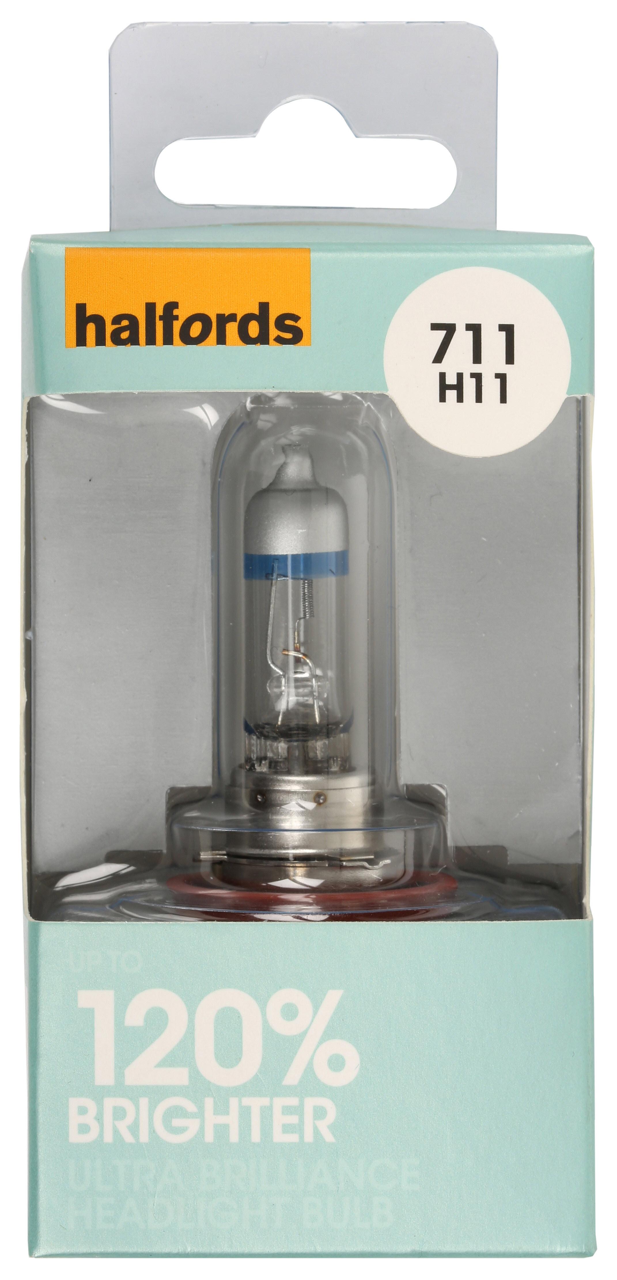

Halfords do their own range of bulbs between 50 and 150% brighter than the standard ones, i can confirm they are a good upgrade because i’m using one on my Magna.

I’m using those Halfords ones:
And they work very well with the OEM reflector.
Have looked at the LED ones, but they seem a bit pricey for now.

I also run a CB1300S which has a v poor headlight and after a couple of goes and reading the thread on AdvRider I have ended up with one of these in it, as they came in a pair I fitted the other in the VF and it works really well.
