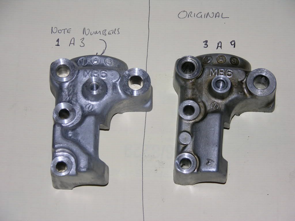

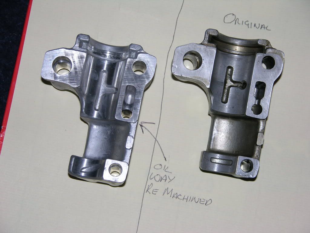

http://i305.photobucket.com/albums/nn222/barnsleypete/DSCN0183.jpg http://i305.photobucket.com/albums/nn222/barnsleypete/DSCN0181.jpg .hi scratcher, the part number on the new cam holders is (12211-mb6-020). the original oil feed hole is about one millimeter in diameter, the new one is considerably bigger probably over 2 mills ( sorry ive got nowt to measure it with).also if the links to the photos works youll notice the oil way to the oil hole has been re machined, i agree with what you say about oil presure,may be honda thought the problem was originally to do with the cam holders oil holes becoming plugged, i think they probably tweaked a few small items when realy they should have “grasped the nettle” and re routed all the top end supply “dave dodge style” . when i get round to fiting the (holeshot top end oiler)ive recently bought, drilling the original cam holder oil holes out to match the new ones has crossed my mind, this would keep every thing equal (the originals are so small i can imagine them getting blocked).but i dont know weather this is a good idea, could just foook every thing up,
