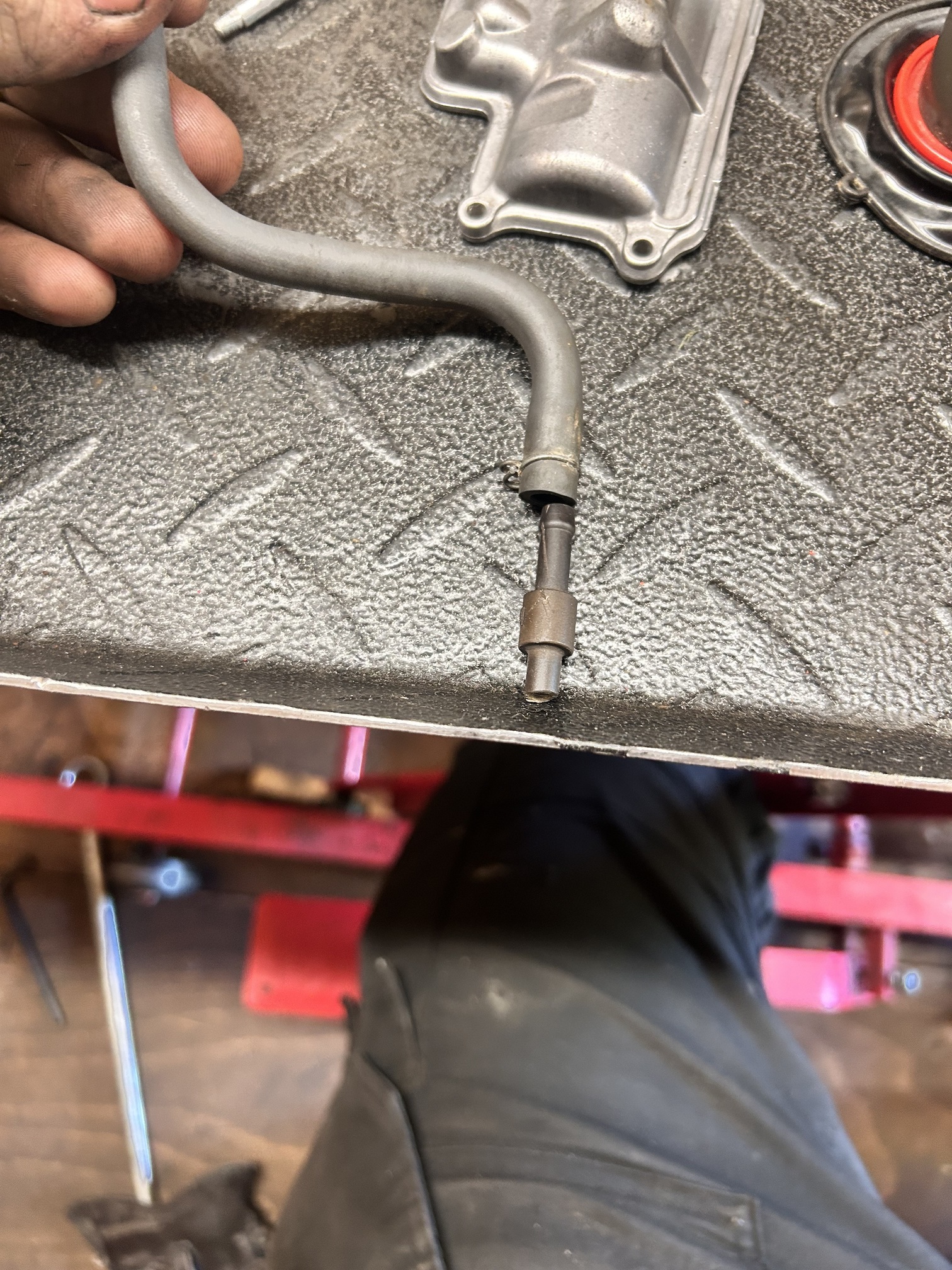

Starting to rebuild these carbs im hoping it’s a t piece but anyone know what this is for ? Thanks
I might be wrong, but this looks like the tube and connector that go to/ come from the tank - similar or the same on my F2?
As BobF said, it’s the connector between the fuel line from the tank which connects to the line to the carbs.

Right ok thank you guys !!!
It’s just a straight connector, they get brittle after 40+ years… I replaced mine with a straight “barbed” brass connector…works fine.
