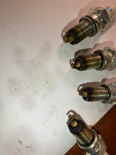

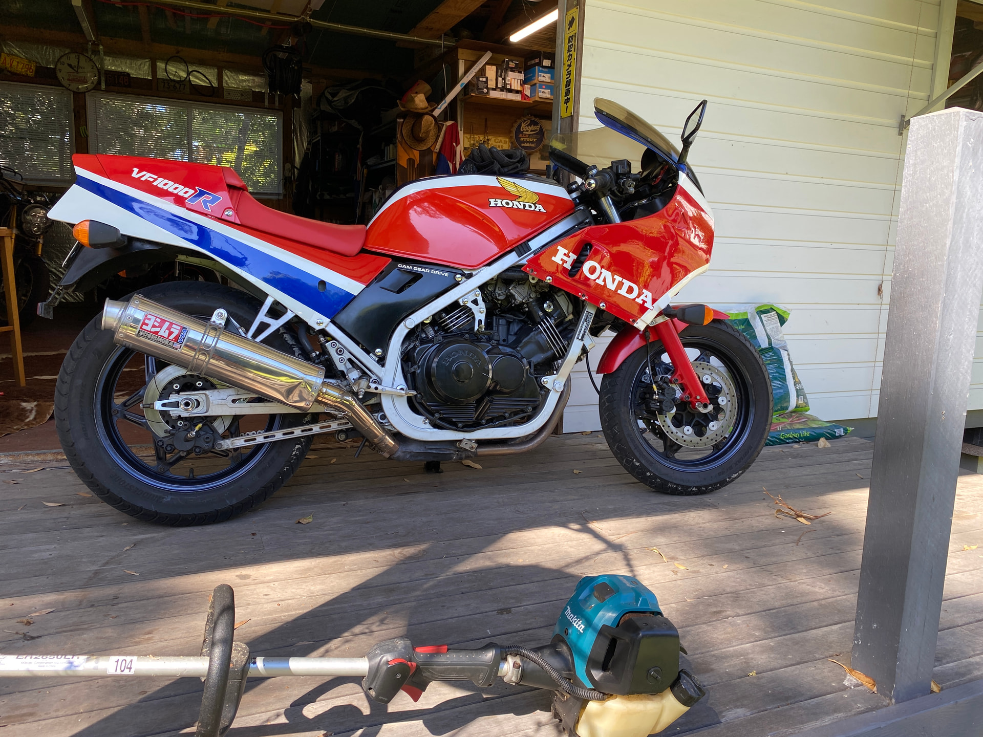

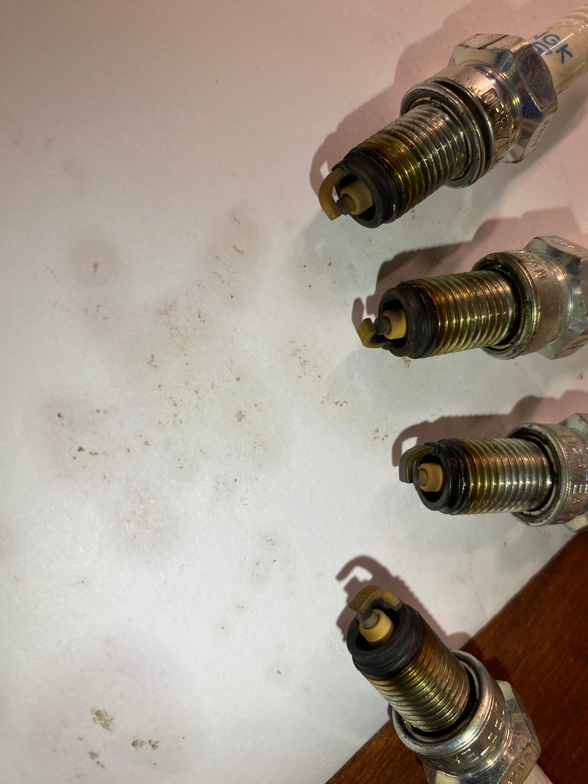

Hello, I’m a member for many years, with few contributions, but I hope this forum’s wonderful experts can help… I’m in Australia, have an Australian-delivered 1000R. Runs well (quiet engine), I’ve spent many hours and angles figuring out my overheating problems, now working on fuelling… Carbs are restored, and the bike runs well. Until higher revs & big throttle, then it totally flatspots. Everything in the carbs checks out, no blockages, good diaphrams. I think maybe main jets are wrong (just installed open mufflers, thought it must be running rich, but that made no difference!). It’s got 145 mainjets, front & rear. I’ve ordered some smaller jets (140, 137.5 and 135) to try them. Plugs don’t look sooty (after longer ride, not when it happens). Is it likely that reducing jet size may help (so many different jet sizes are mentioned in forum discussions, but mostly seem to use smaller than 145s):

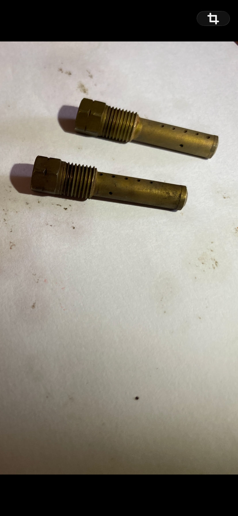

Extra question- Which emulsion tubes go front vs. back? They’re not 5-hole vs 4-hole tubes- instead they’ve got their holes in different spots along the tubes (crap photo):

Whereabout in Aus are you..?? The Aussie “R’s” came with #140’s I believe. The diaphragm springs are a different length front to rear cyls, the rear cyls are slightly longer as the rear carbs are more “upright”.
Your spark plugs look ok, not too rich…and definitely not too lean, a nice tan colour. To get an idea if the mains are the right size….do a full throttle 2nd or 3rd gear pull to fairly high rpm, 9-10k so you’re on the mains, pull the clutch and instantly shut the engine down, now check the plugs for rich or lean condition….this will give a good idea if you have a main jet sizing issue.
I have a “Factory-Pro” jet kit in mine and they use #145’s front and rear, with new needles…they also get you to drill the pistons and cut the longer springs to match the shorter ones….throttle response is much improved.
