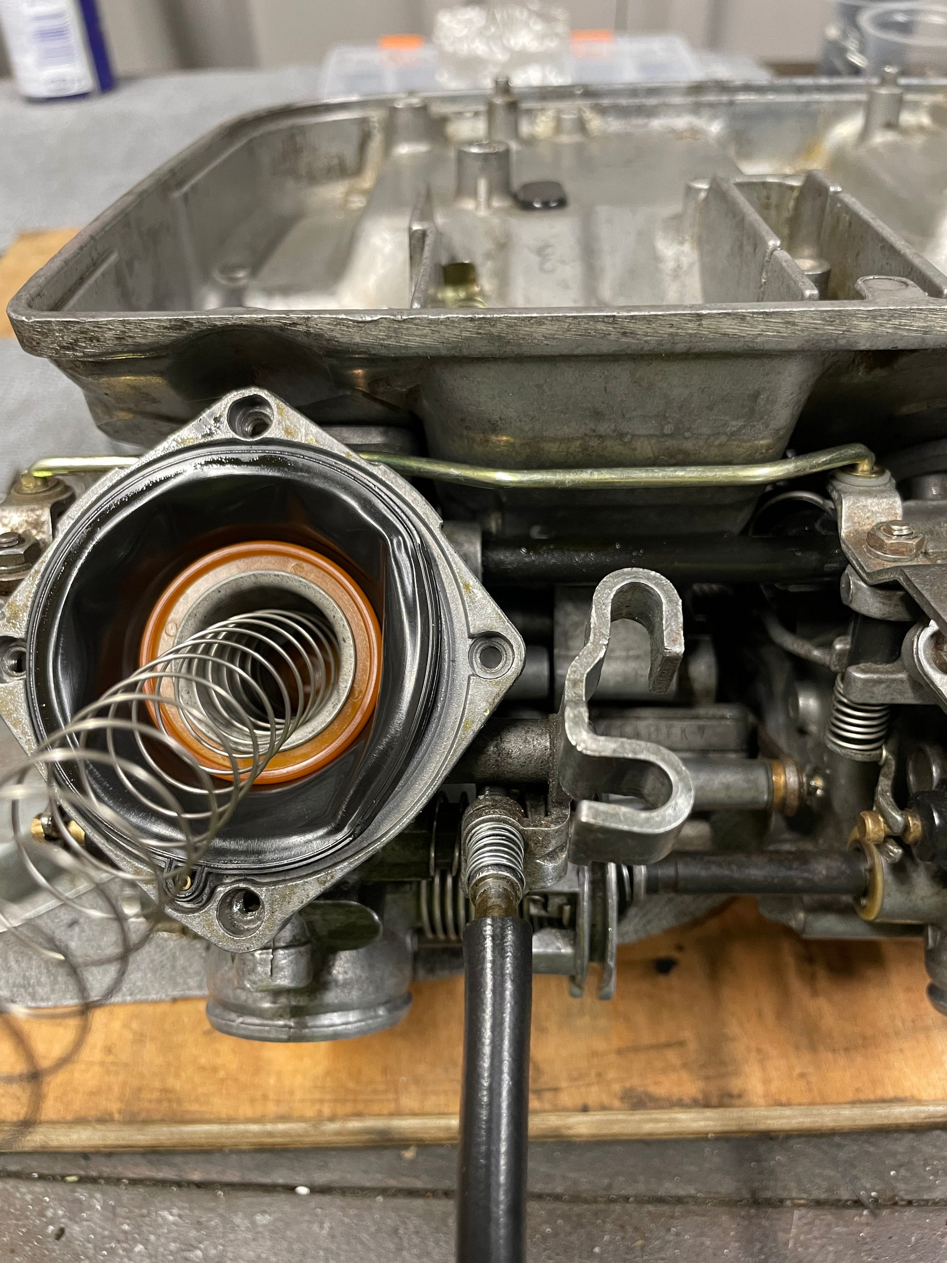

Finally got to the bottom of my mates VF500 not wanting to pull more than 6k under load.Two carbs were like this on inspection.The diaphragm was not correctly seated in its groove.Correcting this has the bike reving to the red line.One happy owner
Good skills come to the fore
Well done. Theae kind of problems can be very hard to diagnose and find. :+1:
