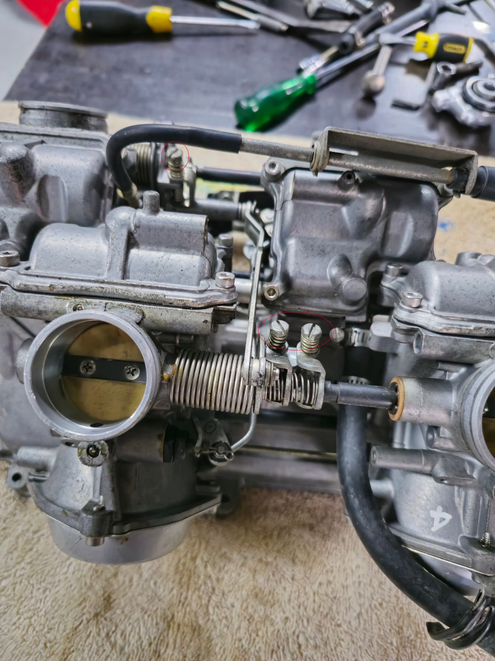

There are 3 adjusting screws aside from the idle screw which just acts on the #4 carbie, then all the other just follow the leader.
This is a pic of my VF1000R carbs, obviously upside-down, the 3 screws circled in red are the “other” adjustment screws.

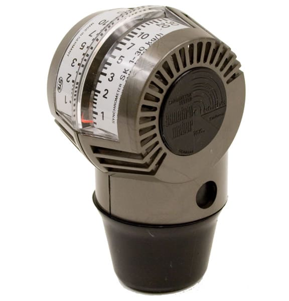

I used to use a set of vacuum gauges but found them cumbersome and time consuming to use, I now use one of these below.
The nozzle of it fits perfectly into each rubber velocity stack and gives a quick and easy to read result.

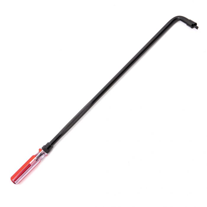

You’ll also need one of these to get at the adjustment screws under the carbs, also a pain in the ar$e.
You adjust the idle screw first to get the idle speed you want, check the vacuum setting with the vacuum tool, then adjust #2 to the same vacuum value…then #3 and finally #1…Just be aware, ajusting one will affect the others so you’ll be going back & forth constantly.
