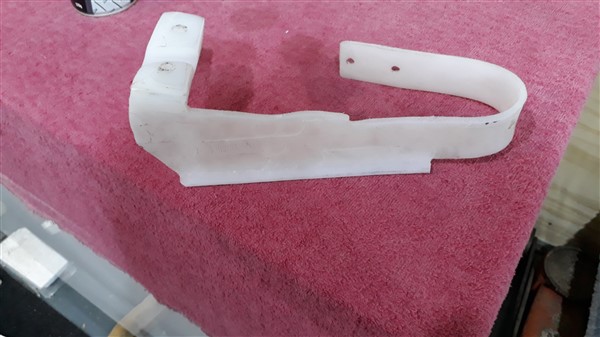

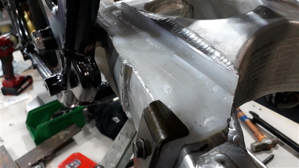

I had to make one for my cb1123f project that had a gsx swing arm.
Made out of umphy plastic which can be bought at ang engineering suppliers.
easy to cut or plasic weld,used a wood router to cut grooves
