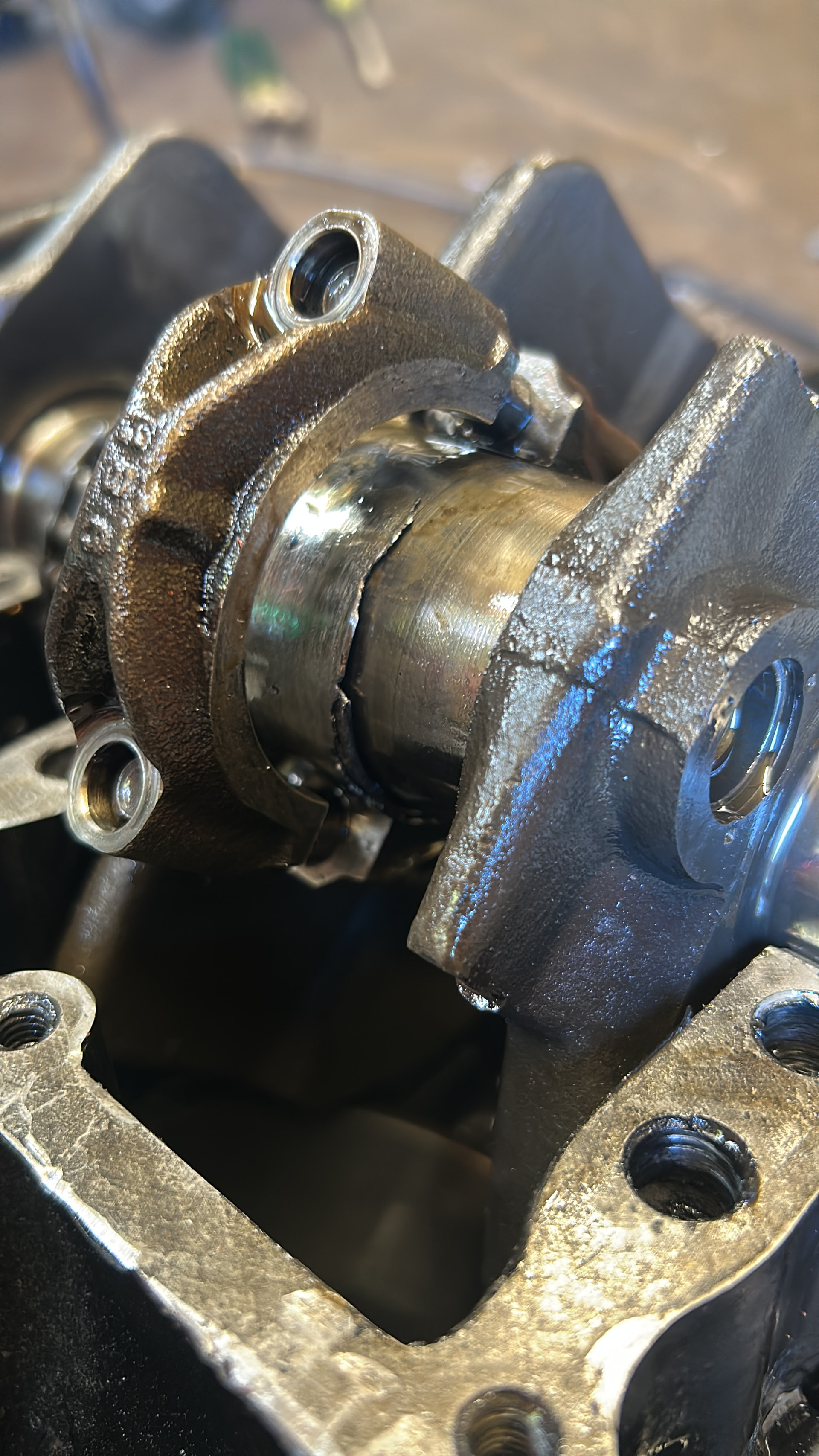

Welp that’s that then the engines dead on my vf main bearings paper thin it randomly seized up on me when I tried starting it for the first time in my ownership rip this engine dunno what to do now
Dunno if I break it for spares do I get a new engine sell what’s worth selling from old one I don’t know I’m at a loss now
That’s a big-end, not the main. If the crank is salvageable and no major damage to anything else, just rebuild it….cranks, rods and bearings etc are still availble.

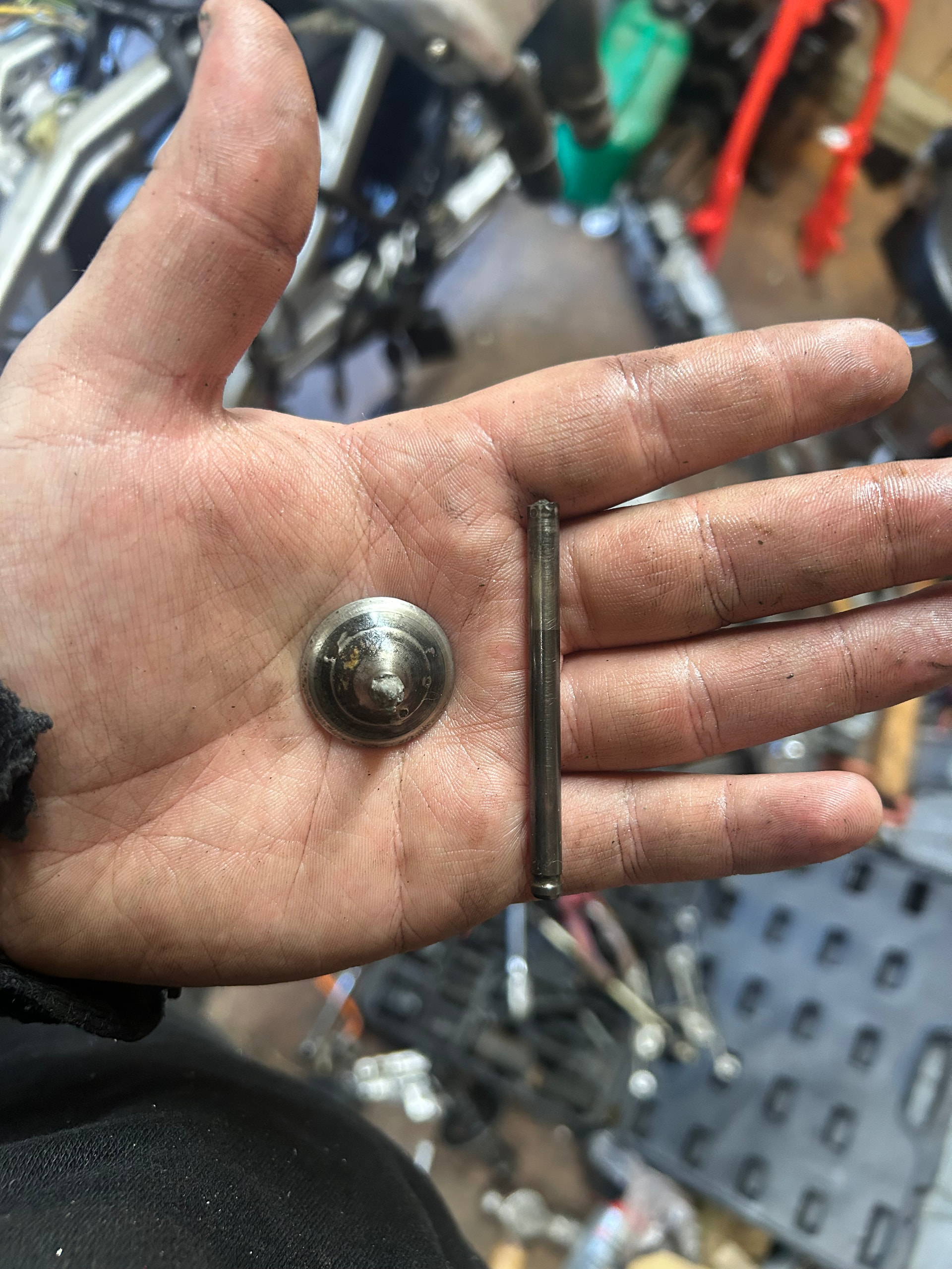

Here is one of the valves:
Hope you will find a suitable solution.
Eagle eyes, Smithy.

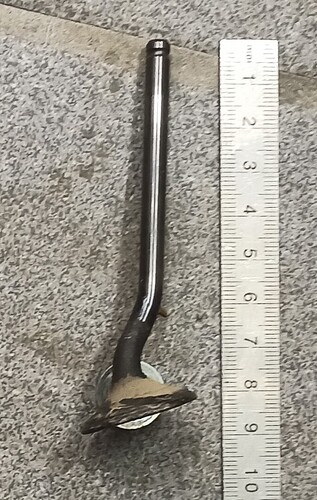

I can beat the valve mines deteriorated and snapped
Must admit, I’ve never done any major damage to any of my VF engines….the worst I’ve had is a broken cam chain tensioner in one of my old VF1000FE’s…rattled like a tin full of nuts and bolts…!
Well I tried to save this engine none off this damage was me

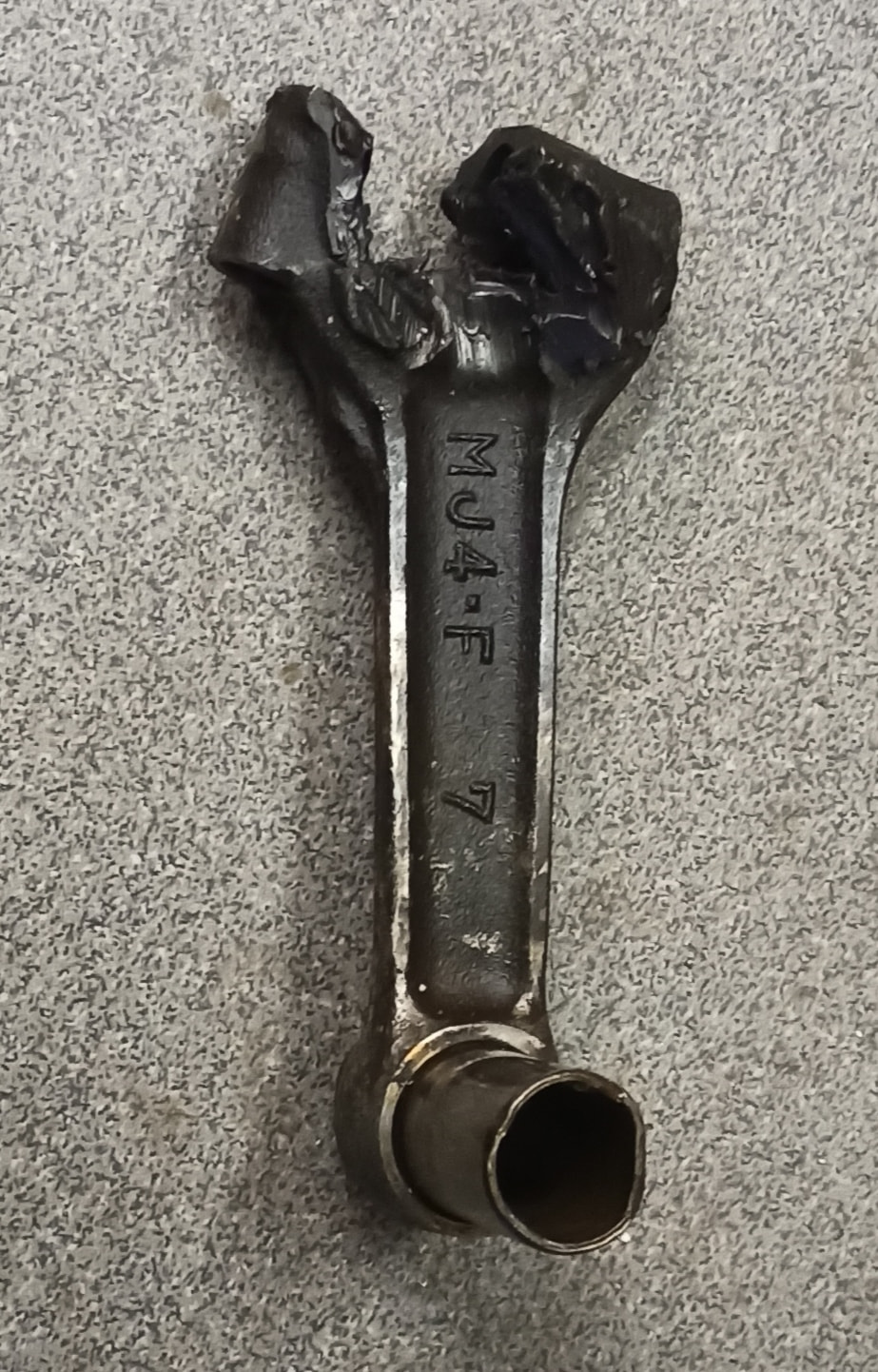

The rod and the valve belong to an engine that was former in my VF1000R. I had a broken 85 US with damaged rocker arms (and cams). The 86 GER was a very cheap offer equipped with F engine and I got the old one where the parts are from.
The guy was runnig it on highway when the red oil warning lamp went on. He thought just make the last 50 km very fast :zany_face: . So he had to change it to a cheaper F engine. It even had a hole in the housing.
In the end it was not making one working out of two broken …. I bought a reworked one and set up the Rothmans.
