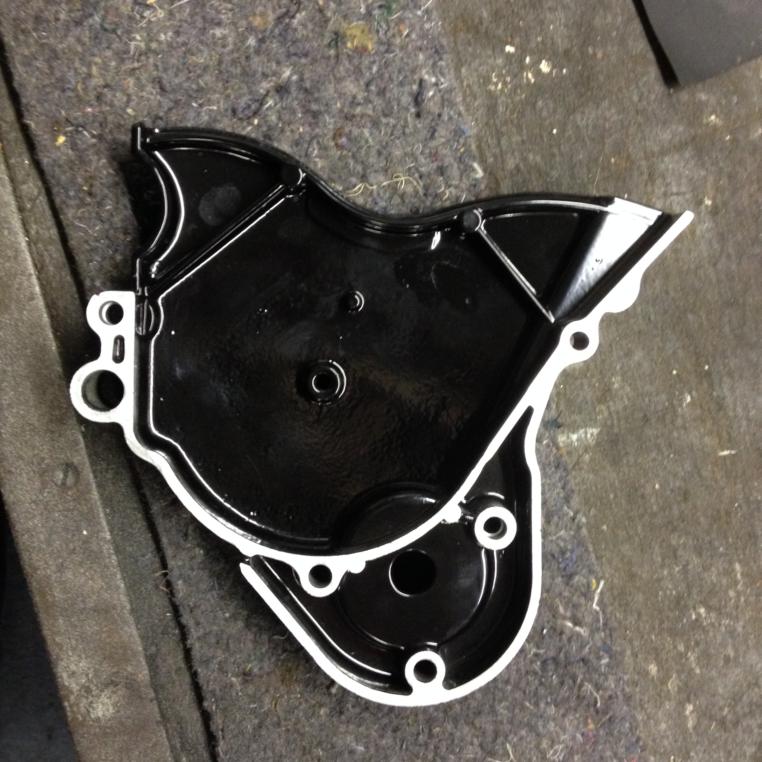

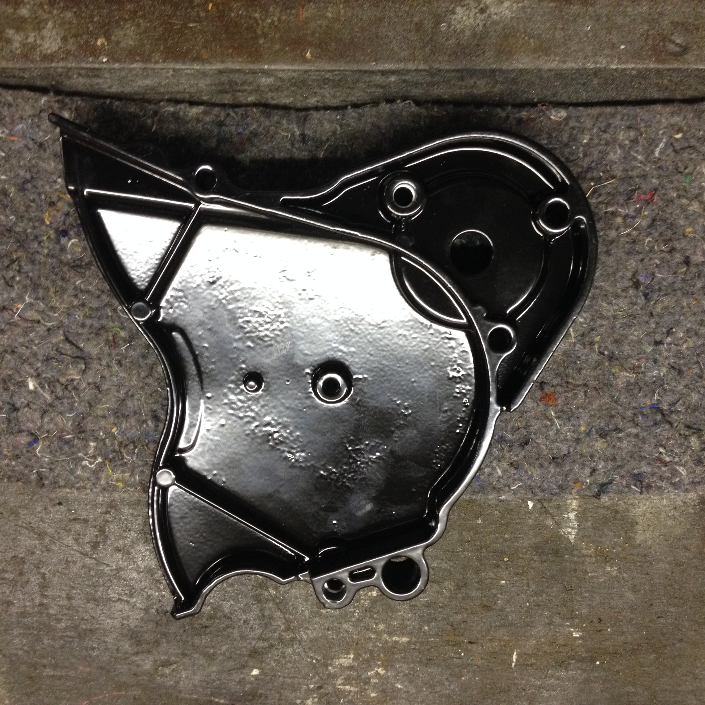

I think I’m getting there
Before
After.
The final finish was achieved using Tony’s idea of a sheet of wet and dry but on my good ladies granite worktop as I didn’t have a sheet of glass to hand,plus an hours labour

Great result though.
