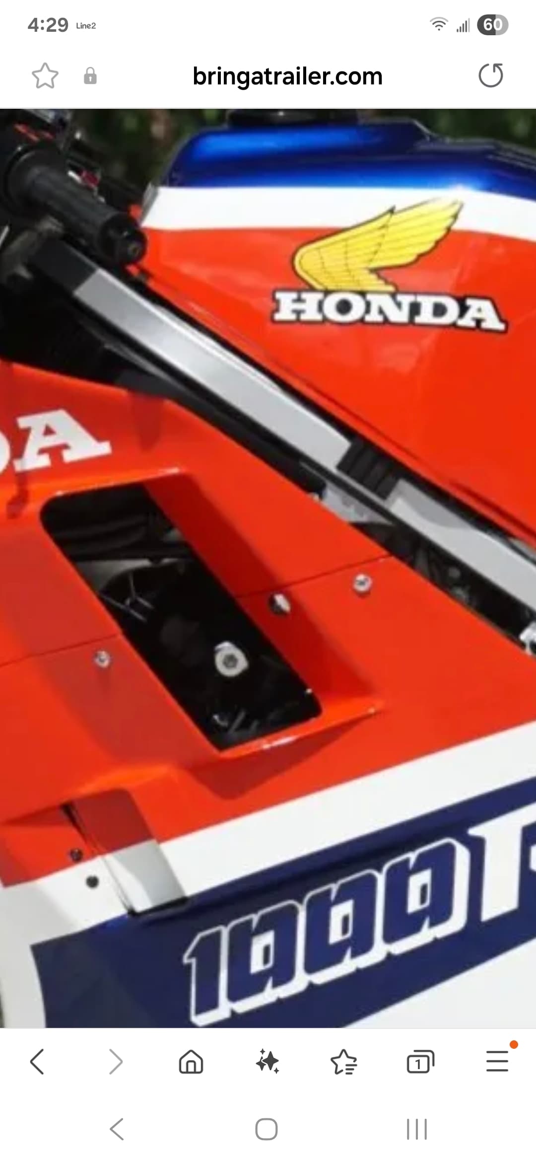

I’m picking up an 86 VF1000R from a friend who has owned the bike since new. Hasn’t been ridden in the past 29 years. There are a few parts that I need to buy. I’m missing one fairing bolt on each side. It’s the middle one on the side vent area. Does anyone k
now the part number for this bolt?
Also, I need tail section bolts (4mm thread / 13mm head) as well as a rubber frame support for the gas tank.
Any help would be great…

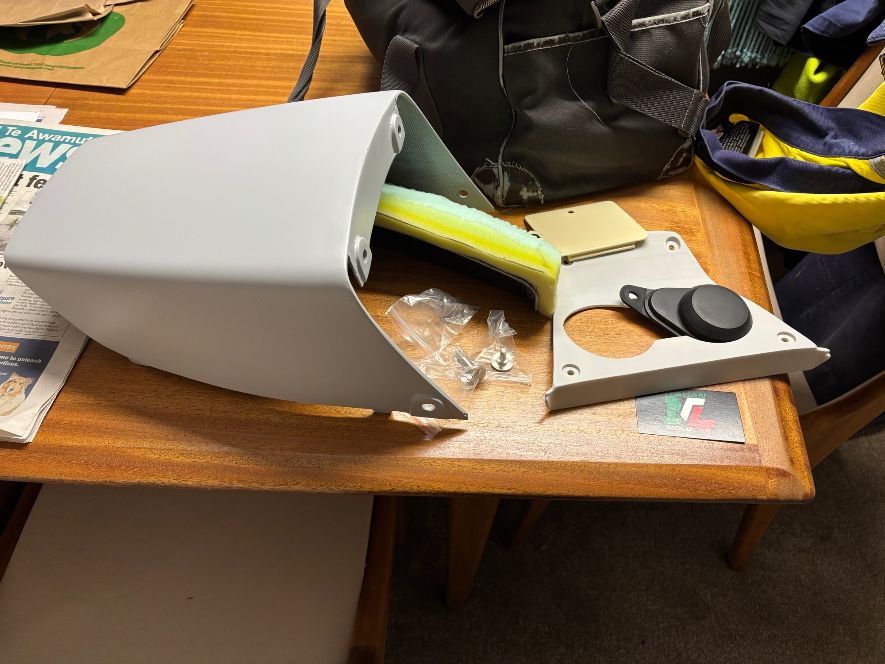

The bolts you are looking for are part no. 90112MJ4670.They have a shoulder twice as deep as the side cover bolts and are readily available.The tail light surround screws are no longer available but Italian mould lab produce a good replica for reasonable money.
This is from Italian mould lab
They have the longer screws as needed to hold rear seat cover in place
