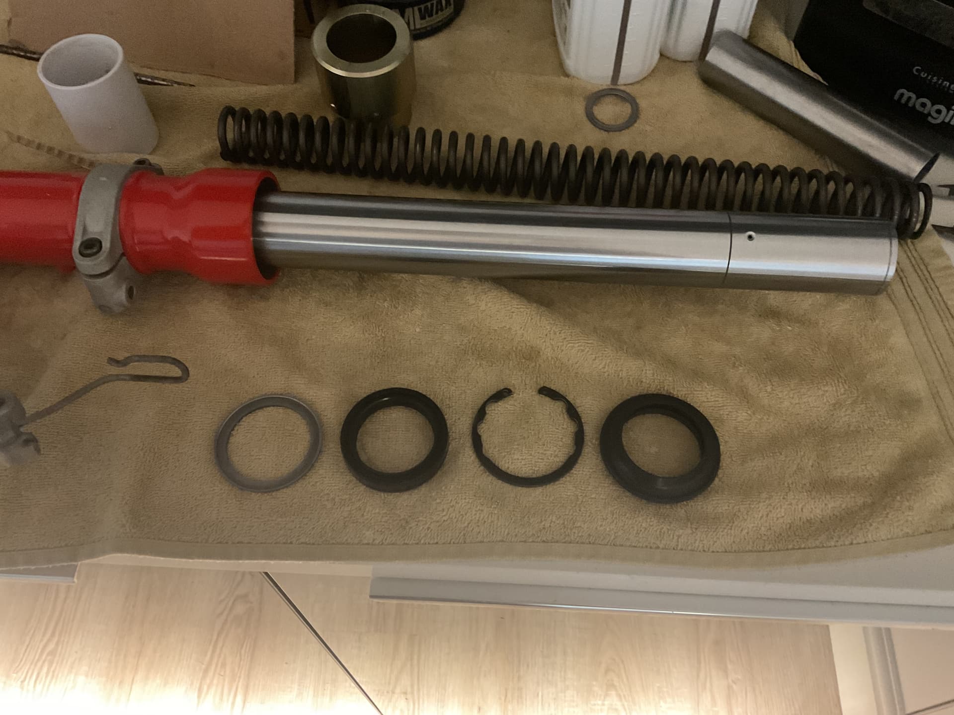

Fork seal what order?
Hello I’m not sure what order the washer, seals, clip go in.. I think this order is right.. can anyone confirm. Thankyou :clinking_beer_mugs:
No prizes for the correct answer :joy:
I believe that is correct Sir..! Same as mine.
I understand the original VF’s had another plastic washer and a felt slider as well but they were discontinued after a VIN# 2003151. They’re not shown in the later “RF & RG” model parts list.
Thanks Smithy.. I wasn’t sure on the washer if it went before the clip.. all good :+1:
Smithy,
Isn’t there an up/down side to the oil rings?
Yes I think it’s the writing on the seal goes upwards
As Mollrs mentions, generally the writing on the seal will face away from the oil it is trying to keep in..
