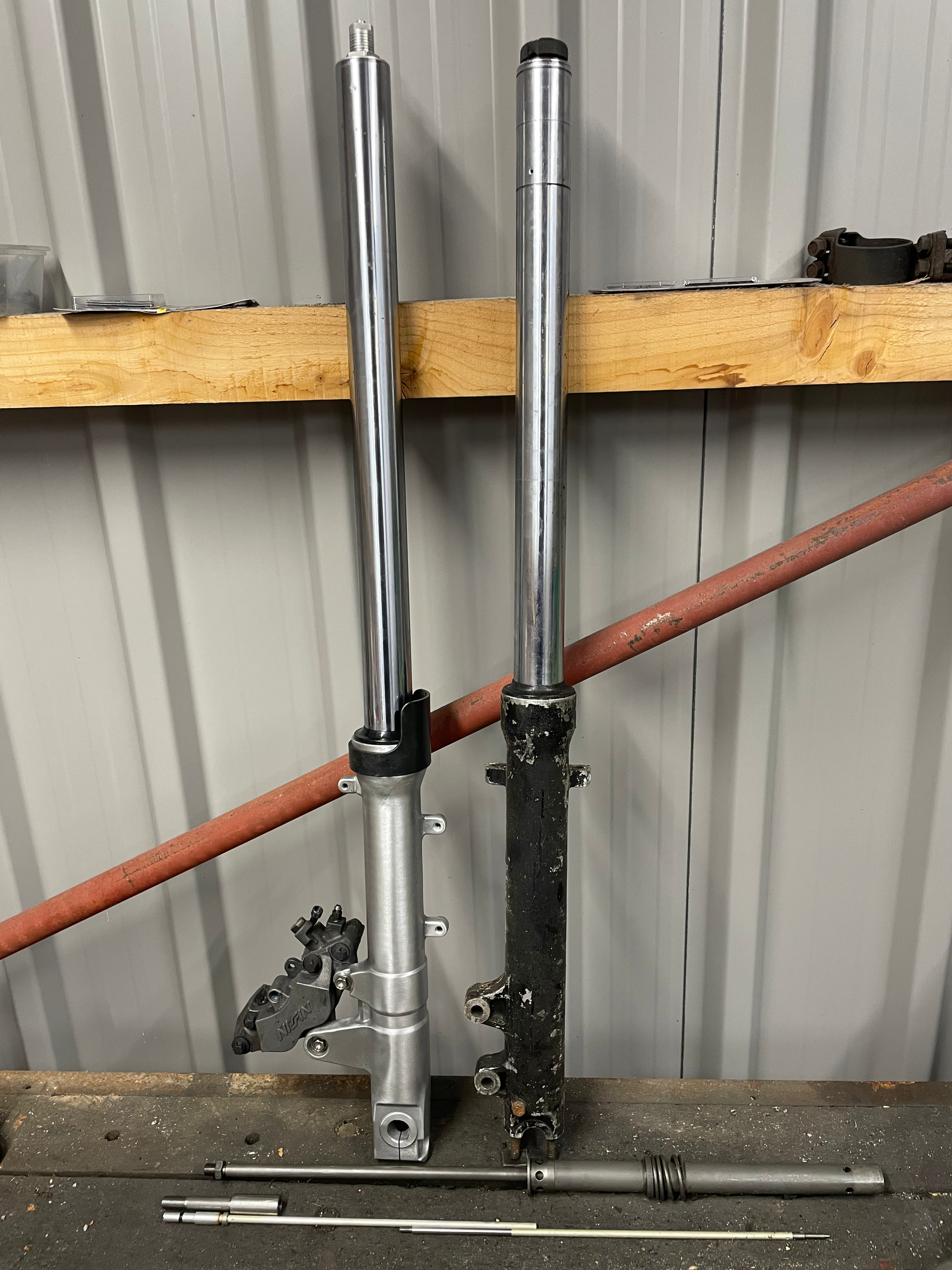

This time I’ve gone down the route of extending the firestorm cartridge internals to match XLR650 stantions.The result gives me both preload and rebound damping adjustment.
Both the tube and needle rod required an 80mm extension,this is shown in the foreground.

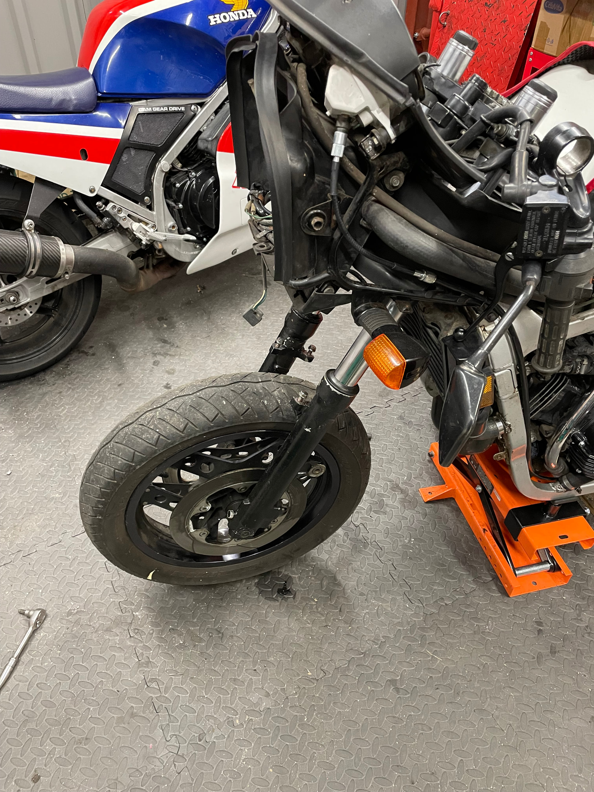

So out with the old

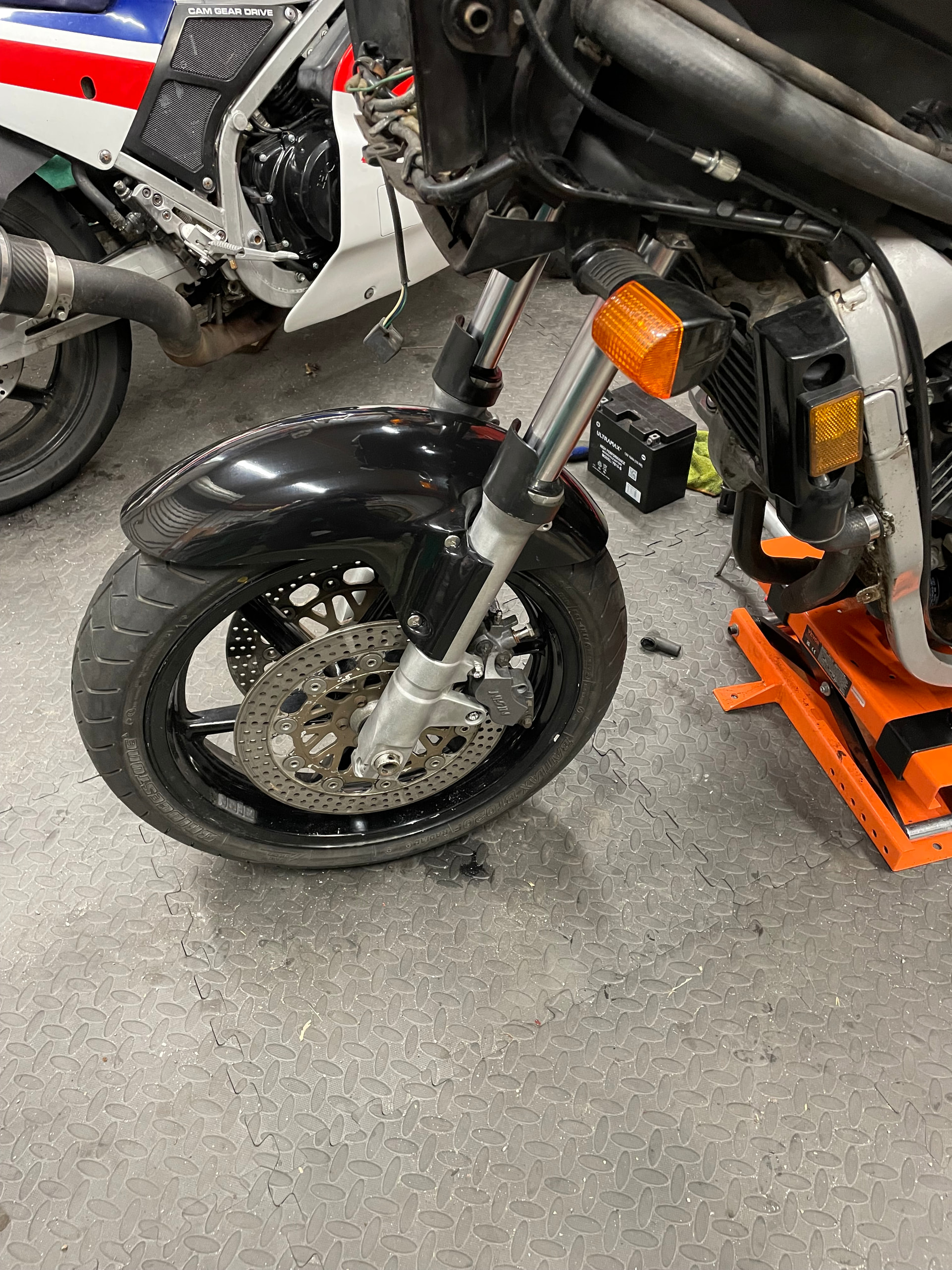

And in with the new(ish)
