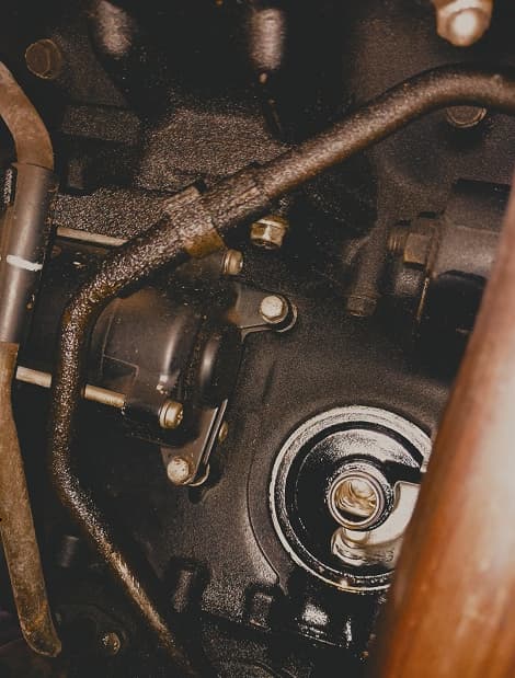

Looking at the pictures attached, what would you guess where the leak is coming from?It is the front of the front cylinders on my 1000RF. It is not really bad, but ….annoying.
I would think the oil mist comes from the left connection of the of the oil cooler pipe. At least CMSNL doesn´t even have the partsnumber of the sealing o ring. Is that a common part which can be used from other Hondas? Thank you for your tips!
Best wishes
Joe
Joe, the original Oring is 9.8x2.4
I’m using 10x2.5 on my R and Boldor with no problems
