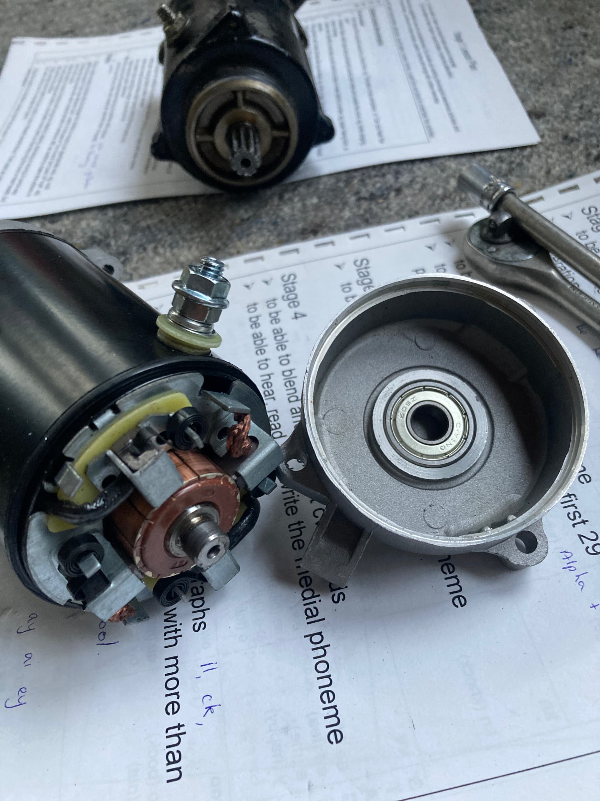

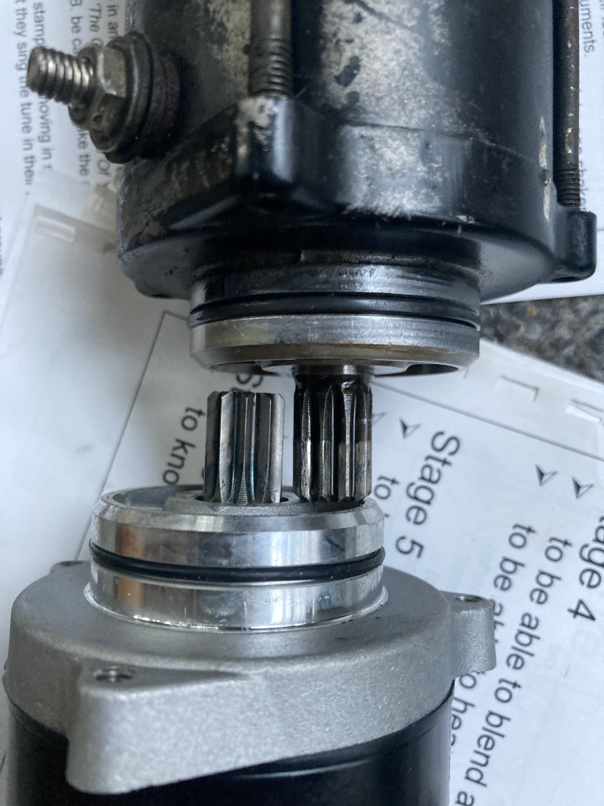

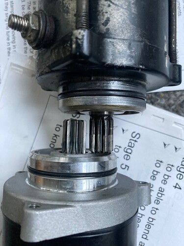

I got my new chonda starter and was checking the brushes to be sure.. and noticed the much fewer windings there. Also I got the wrong 1 so had to rotate the brush plate by 90 degs to make it run clockwise- well it’s a much stronger starter than the original- so it can stay on there. The other pic is of how short the (10) splines are, but once mounted they fit the same because the protruding part with the o ring is longer.
The old one still works- but is weaker/ slower..
Starter may be for a VF750 Sabre or Magna…their engines run backwards. The VF750F has a shorter starter gear than the VF1000F/R.
You’re right. It does fit now and turn the right way though after turning the plate 90 degs and the splines line up well too- I’ll put a pic up when I take it off again as 1 of the mounting holes misses by a mm or 2.
