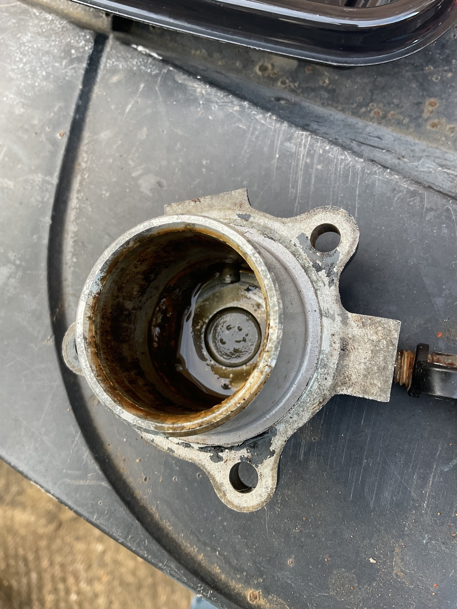

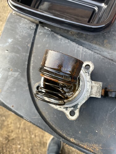

Hello again got a leaking hydraulic clutch… took it apart and loads of yuk in there…. Can you get refurb kits for these ?
Yes - All Balls and others have rebuild kits. clean things up good, if you have someone in your area with a vapor hone they do wonders to refirb the aluminum. Just did mine - super easy to rebuild, a bitch to bleed!
Thankyou for advise ![]()
Bleed from the bottom to the top, use a syringe and pump it in from the slave end. Air doesn’t like to go down.
