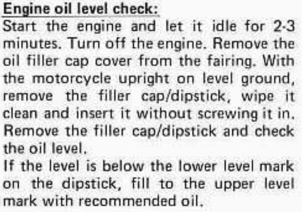

I going to change the oil and filter tonight. I have the filter and four quarts of oil. I’ve seen some say these engines take 3.8 quarts of oil and some say 4 quarts. I know that’s only 3.2 ounces. Does it matter?

With the oil, after draining the oil and replacing the oil filter, just fill till the oil is at the top of the full mark on the dipstick, do not screw the dipstick in, start the engine for a minute or two….then top off as necessary, oil filter will take ~250ml or so, oil level must be taken with the bike upright, not on the sidestand. We also need to remember, the first of the “R’s”…the 1984 RE’s never had a twin element oil pump or an oil cooler so they will take slightly less oil than the other two.

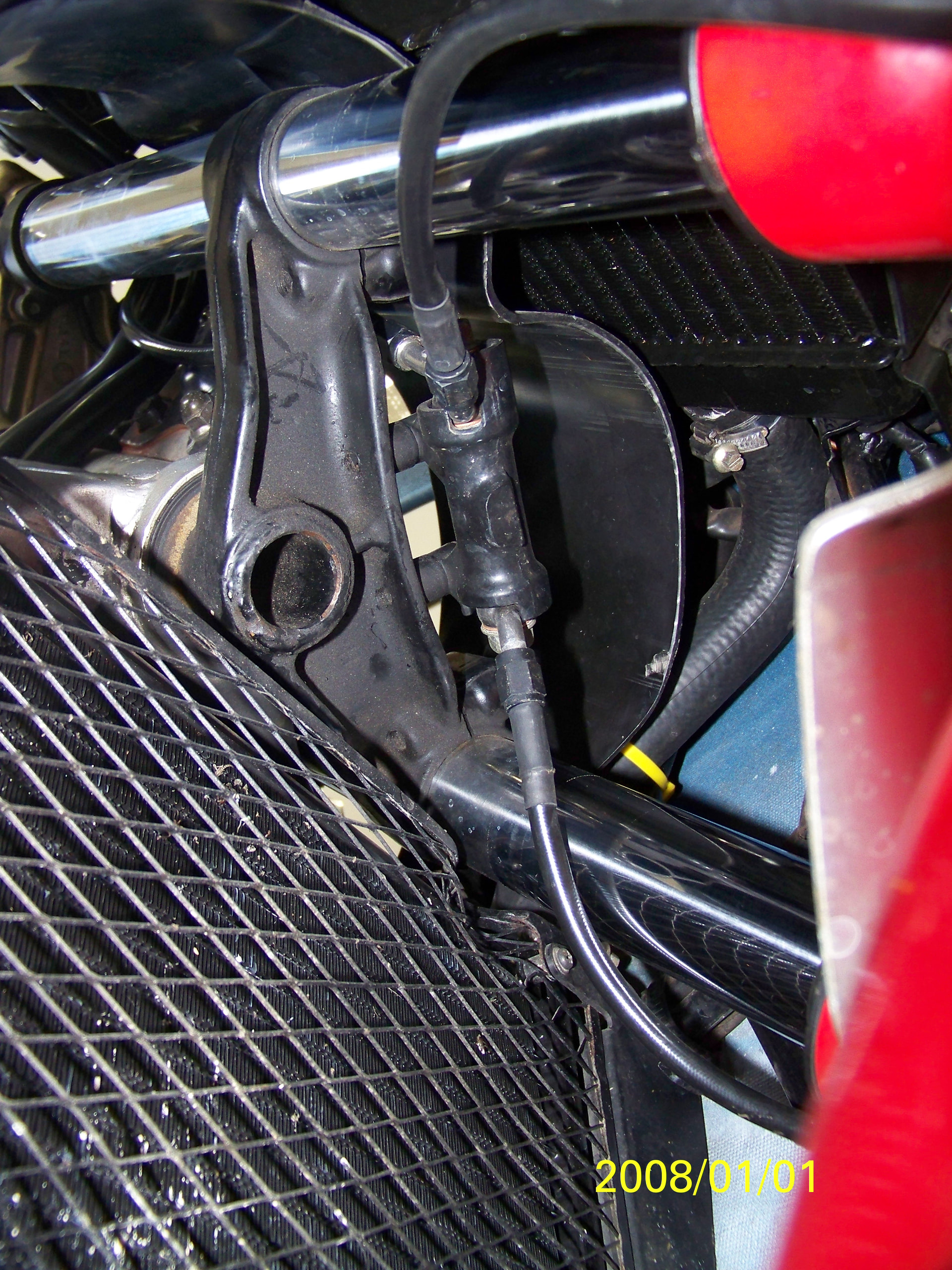

I’ll take a picture of mine.
Well, I’ll be dogged!
It does have two radiators. The upper one is so small, it’s hard to see. Thanks for the help guys.
My wife is eating pizza for supper tonight, I’m eating crow. :woozy_face:

Here is a pic clearly showing both radiators. You guys are awesome.
