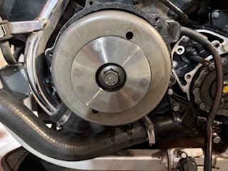

Removal of alternator rotor?
rattle gun will not undo bolt .
Can I make a plate up with 2 pins to drop in small holes on flywheel to hold while I undo with strong bar?
Your idea should work…just be careful not to push the pins in too far, might damage the stator. There is a clamp type holder for them too, like a big oil filter strap.

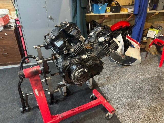

all stipped

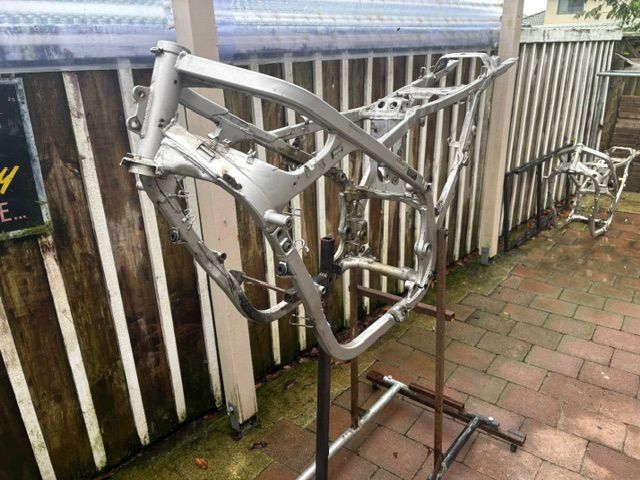

frame sorted and ready for paint
engine ready for strip, check found blown rear head gasket
will look at bearings etc.
have been water blasting cooling system to clean out

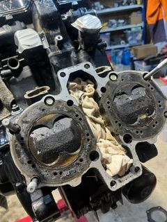

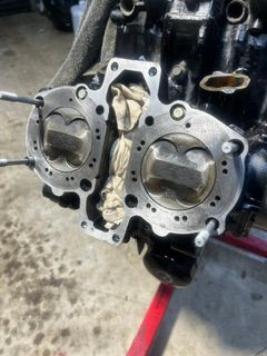

Well engine is being checked after a blown head gasket
Checked oil press before removal which was ok so leaving bottom end alone.
Cams in very good condition and rockers.
Front head off and a clean up which is wasn’t bad plus valves need a small polish .
We will replace valve stem seals with viton ones which also fit cbx1000 I found out.

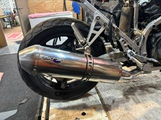

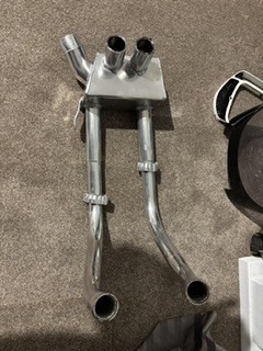

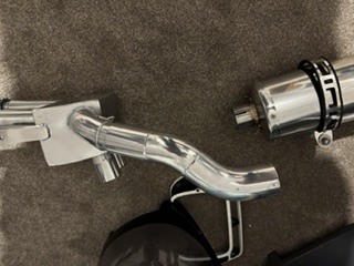

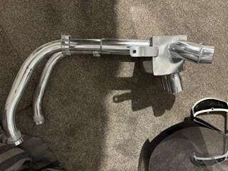

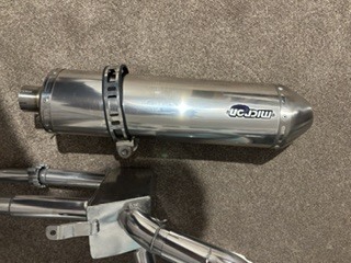

Had a exhaust made up but still have original so stash that away.
Other head of this weekend hopefully

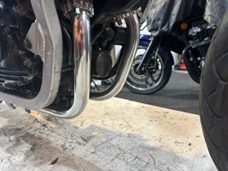

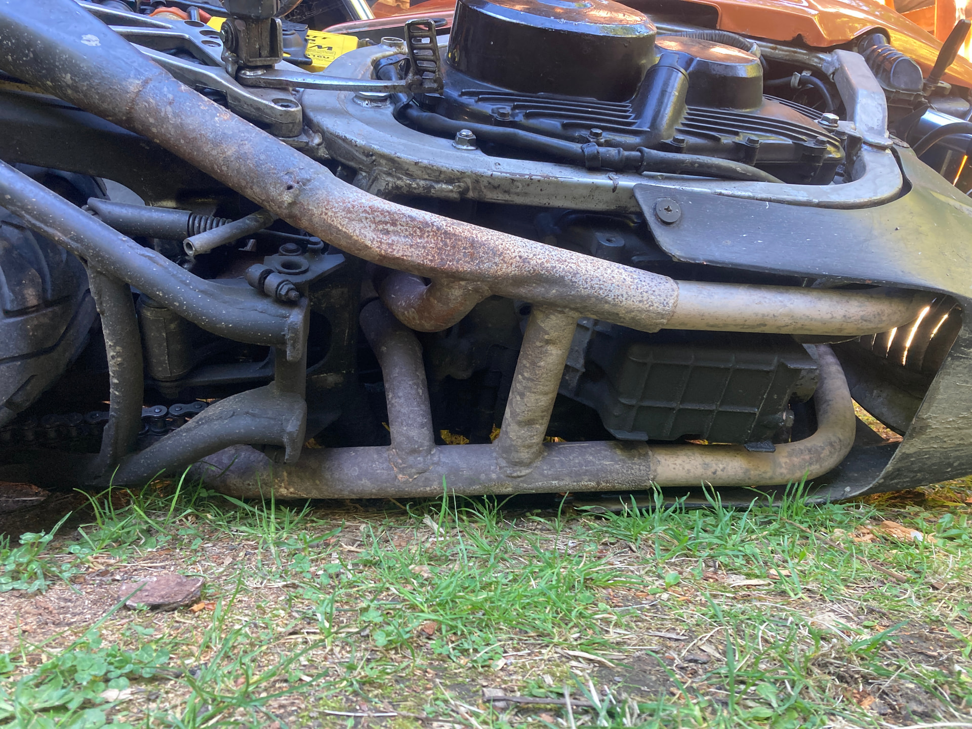

hiya- any pics of that exhaust before you put it on? I haven’t touched mine since I bought it, as it passes the wof- but it’s welded all the way and poorly done- so needs replacing. cheers
Yes and this was put on the dummy bike set up
Has a ceramic coating ,something different plus the wife liked the colour
Used the original front pipes.
fab thanks - looks nice.. looking forwards to your review of it when up and running- here’s a pic of mine- cheers

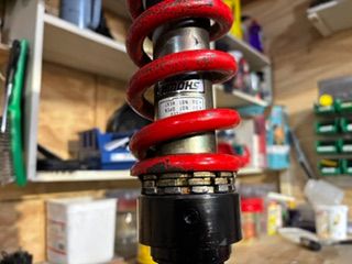

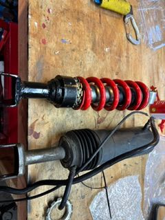

Have replaced the horrible rear shock with one off a blackbird.
Top mount ok so removed the bottom blackbird shock mount then got a tube and cut a internal thread to match thread on new shock then copied bottom of mount to match old shock. In hindsight I should have cut old shock up and used its bottom mount which would look tidier but the old shock still hold air which seemed a shame to destroy at this time.( I’ll hang it on the wall).
Looking at the shock this morning and have realised my mistake.
What a fool to do this.
I’ll have to have a rethink to fix this.
Hindsite could have a purchased a new one but do like the challange
maybe a big washer welded to a short piece of pipe? would work asis prolly though?
possibly a bearing flange would do it..
I wonder if anyone realised I have altered the wrong end.
I put it in and it is upside down now.
Will start again
Yeah…that’s not going to work if upside down…and the oil will be in the wrong place.
Most of us just fit a YSS or Hagon shock and be done with it…they’re brilliant for the VF’s. Jamie Daugherty also has quality shocks for the VF’s. https://daughertymotorsports.com/
