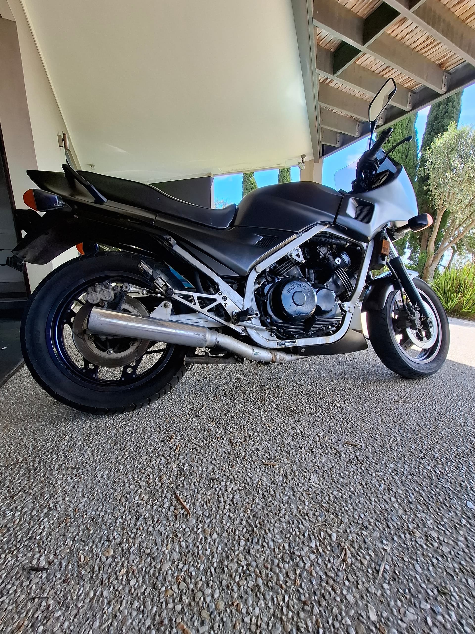

Well found a cheap bike without doing many checks on it, nonstarter and maybe im stupid for not even do a compression check. Anyway, long story and I know you guys probably will read this much so this is the short edit I promise. The bike is mostly complete, it was rough on the paint so the bloke or bloke before him gave it a quick spray. 2nd red flag.
Fuel tank was installed but with random fasteners and washers, sensor was out and not working.
