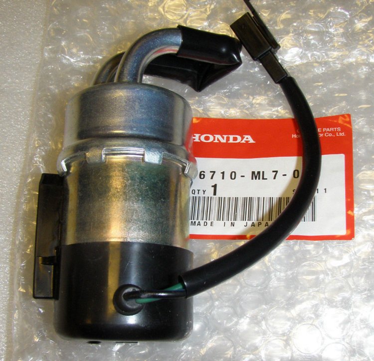

Thanks Marmite. Check this out…this is 2 photos of a fuel pump for the 1986 and 1987 Honda VFR 750. I just had my pump out of my VF1000F and this pump looks like a dead ringer. My guess is maybe the electrical connector is different…just my guess.
Connector is the same. Black/green wires and the same configuration. if i can find chinese copies of these somewhere, i’ll probably buy a few as spares.
