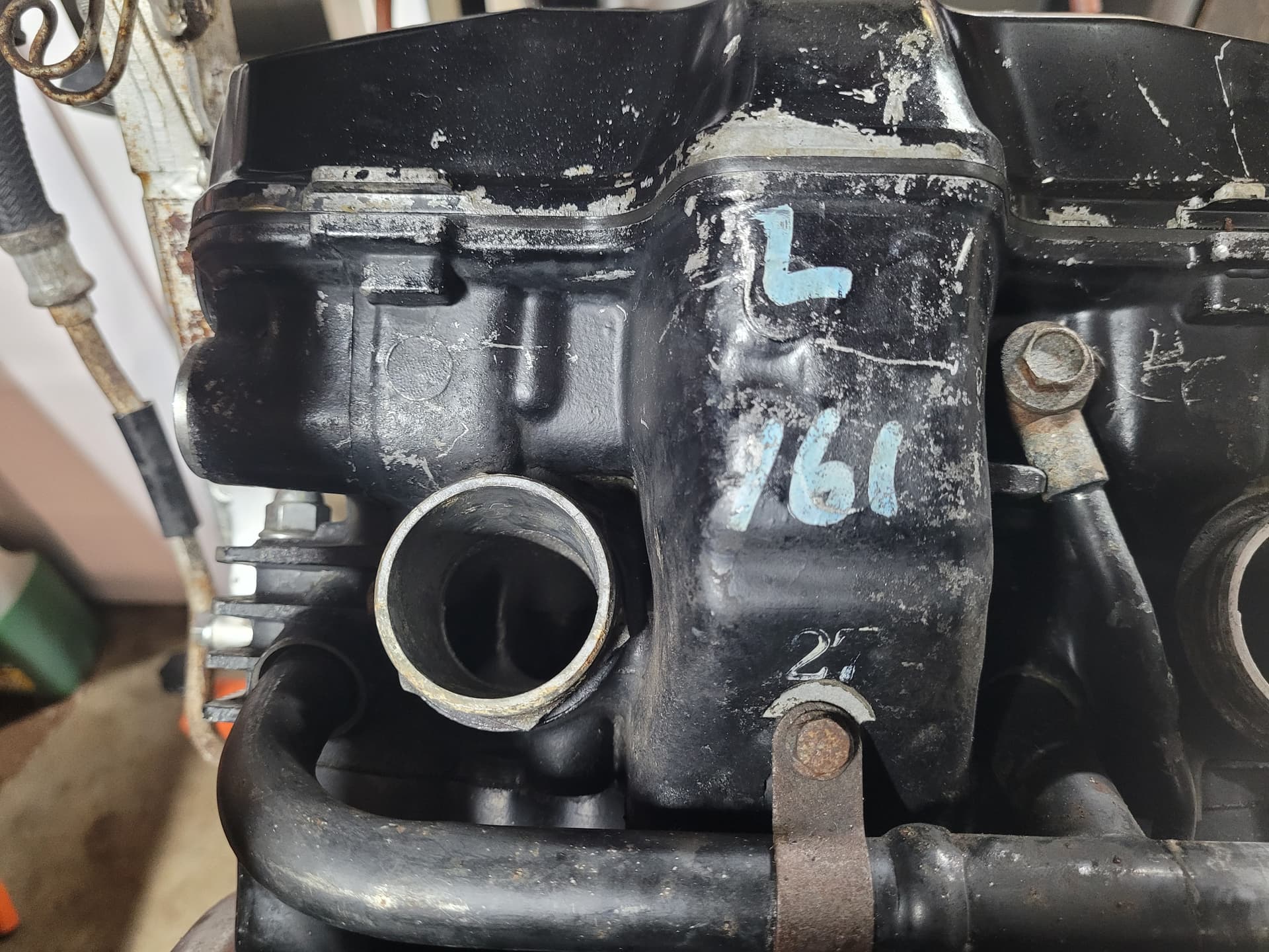

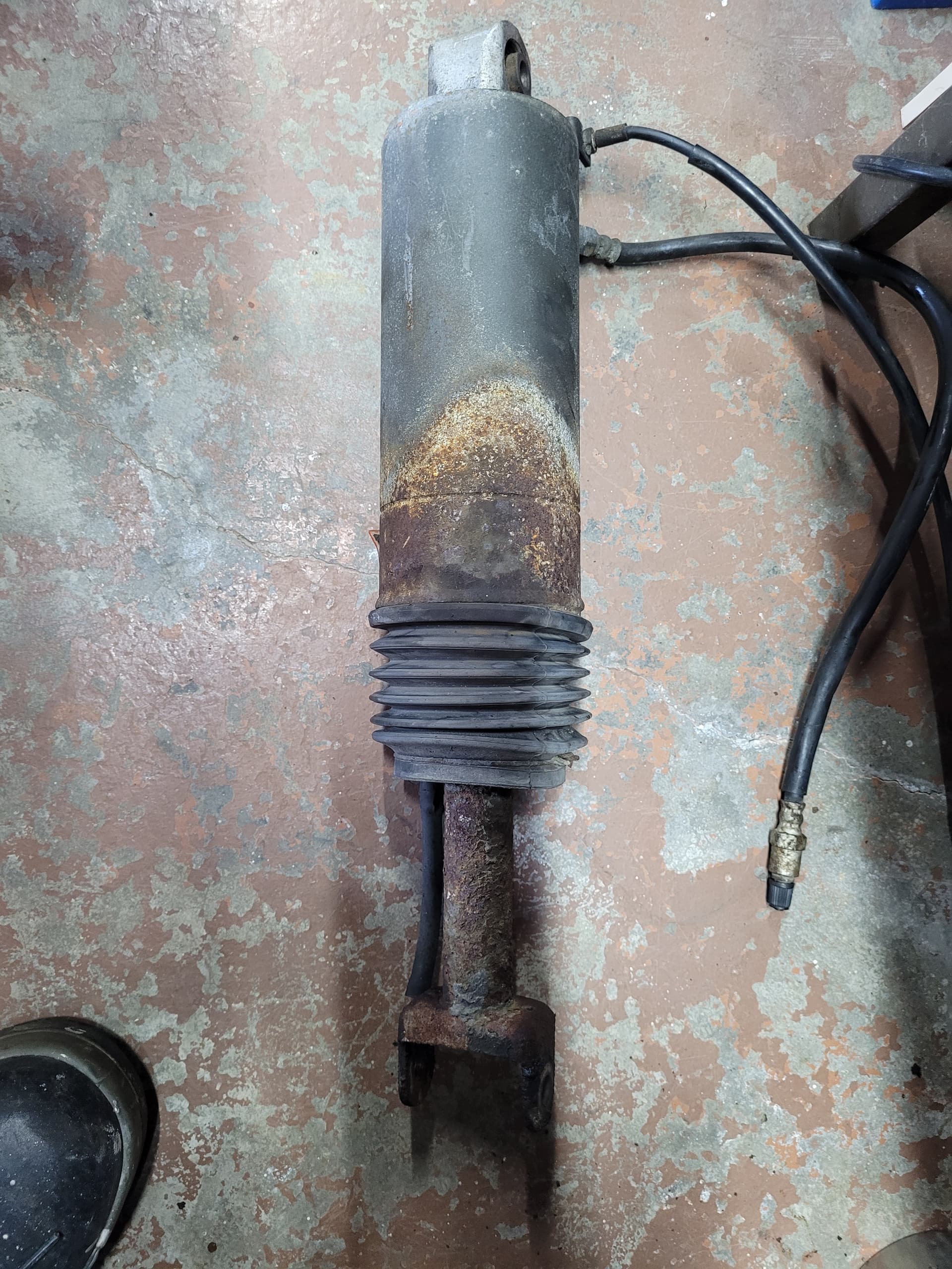

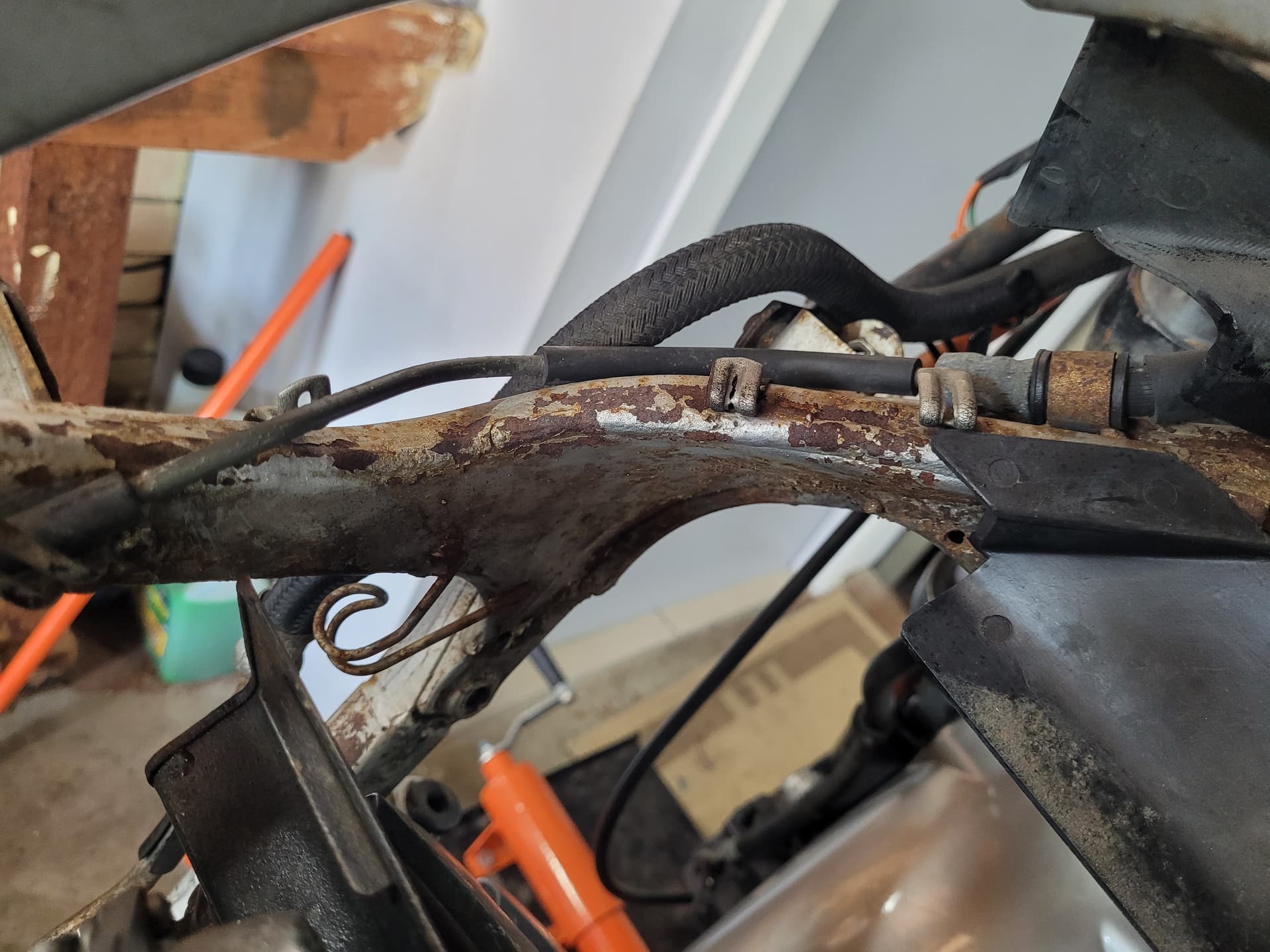

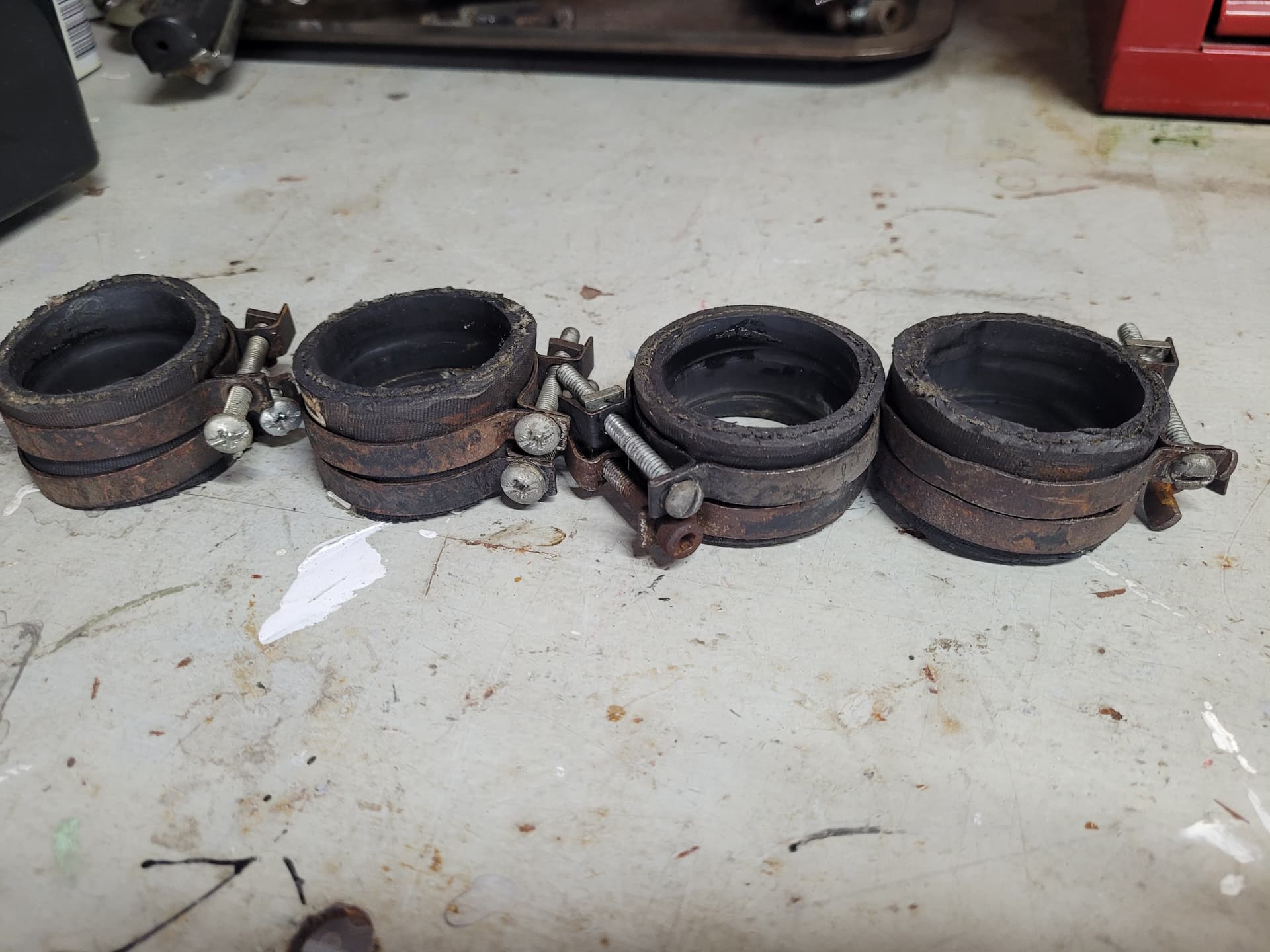

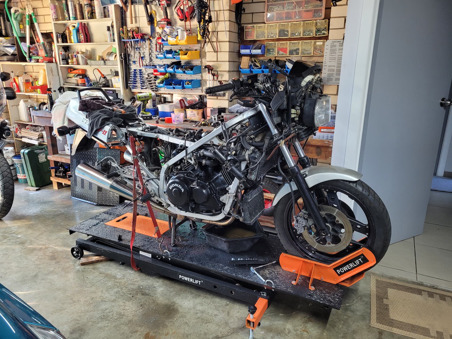

My vf1000 arrived and it had covered in muck due floods in NSW, the delivery guy could not get up my street so a block away and road up to my place, it sounded okay. 8pm so dark and I waited for daylight to have a decent look started it and it was a bit sluggish to rev so I let it idle to check the fans operation after about 3 minutes it died would not run cleanly or idle. At point I realized that the bike had significant corrosion and the rear shock was seized. I thought dirty carbs and started to strip down the bike. let the pics tell the story

Looks like an '85 FF or F2..?? Not good mate, plenty of corrosion & rust in there. That exhaust is interesting. The whole bike needs a good going over, frame stripped, cleaned and powder coated, swingarm bearings and shock pivot bearings replaced etc. The steering head bearings and wheel bearings will also need doing. Those carbie manifold/boots are what looks like pieces of an old radiator hose.??

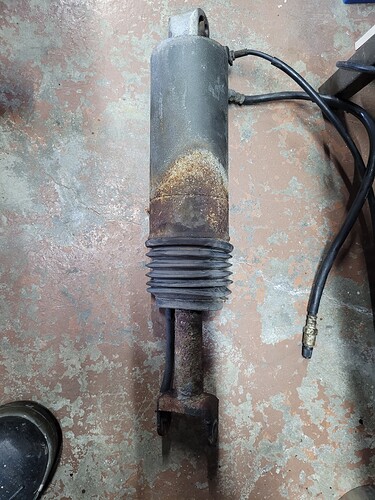

The rear shock isn’t such a bad thing, they were junk even when new…just fit a nice YSS shock and be done with it.

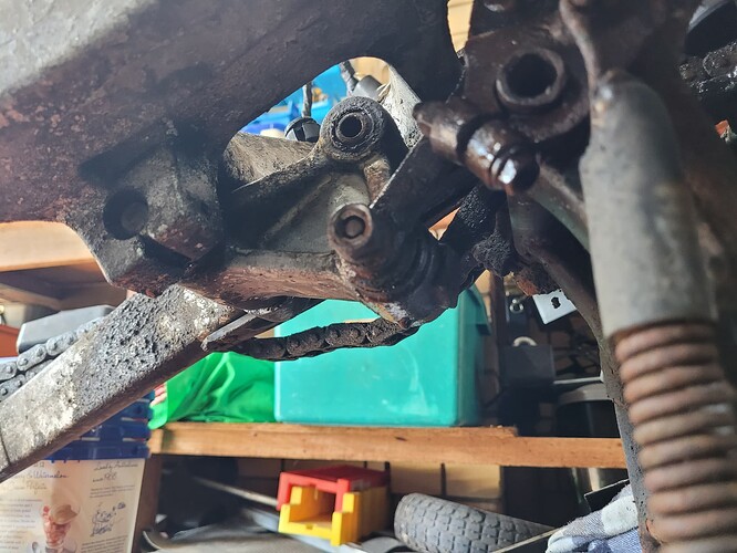

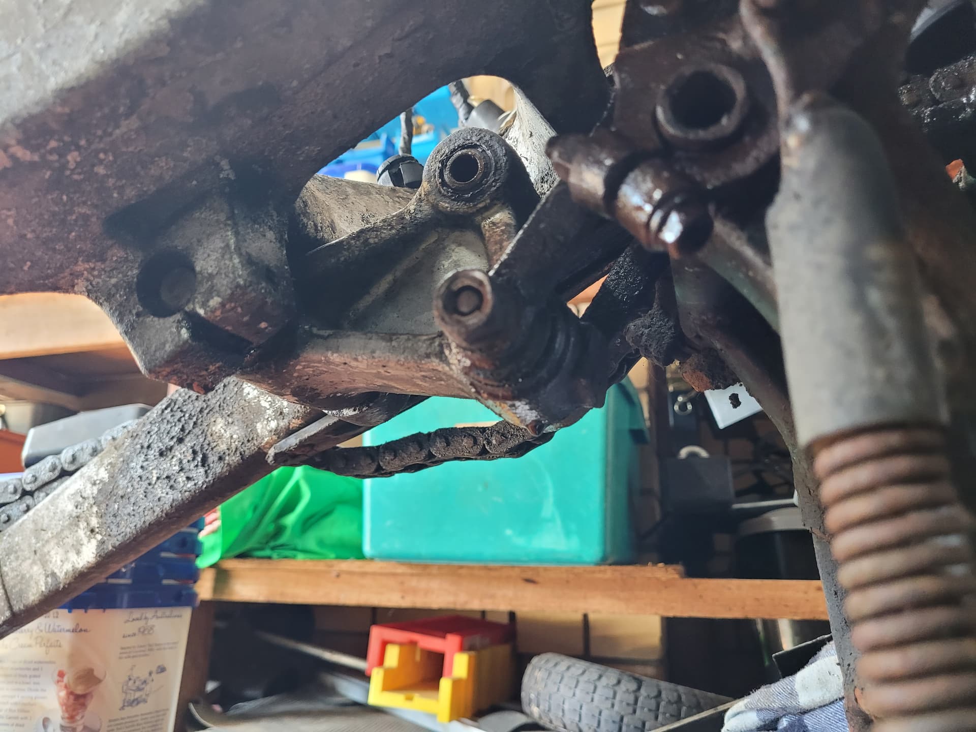

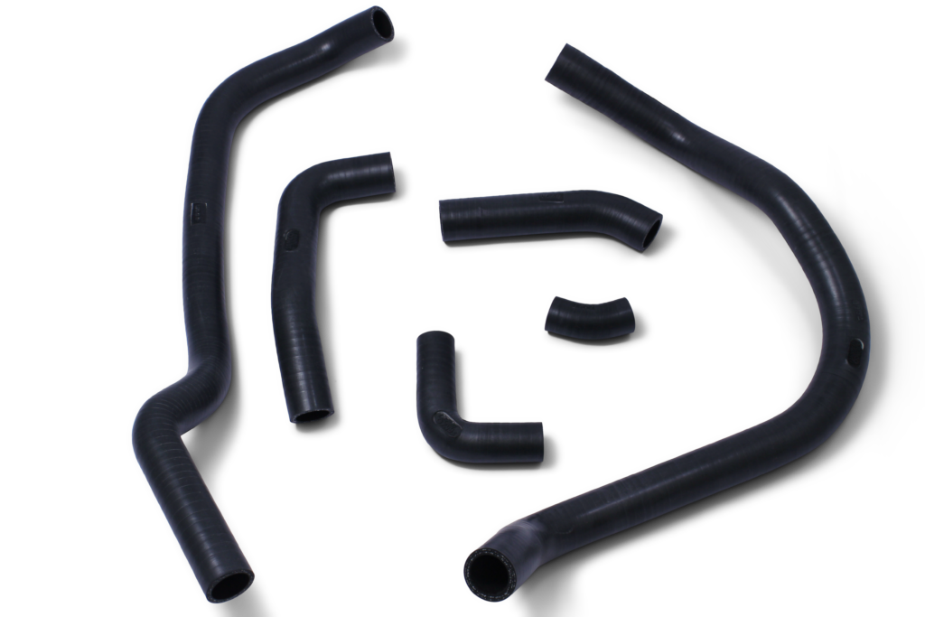

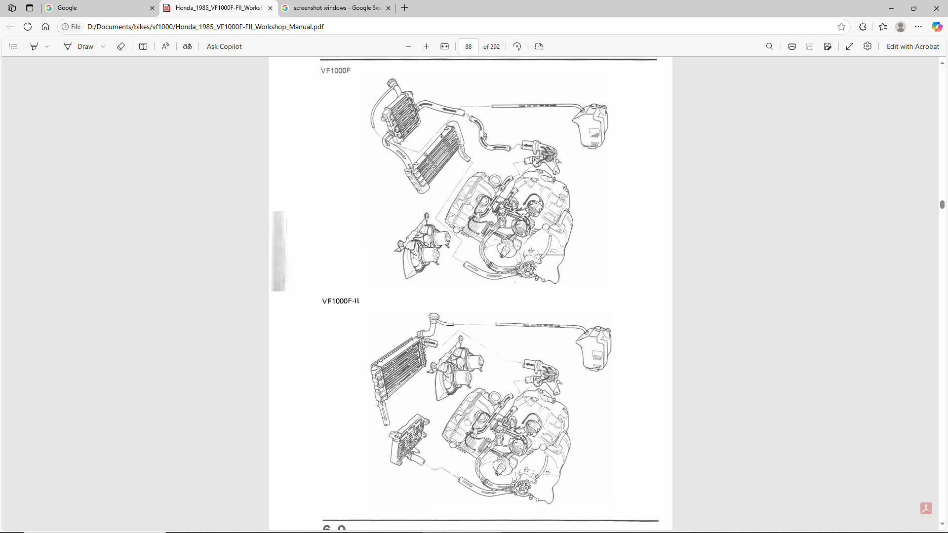

I am in the process of stripping to the frame and replacing bearings but it is such a poor state I cannot get the linkage pivot bolts out, so everything is soaking in penetrating oil, The fairings are ok for their age, just dodgy mounting bolts (there is a pattern here) and a paintjob that is good from 10 meters. I have a YSS shock coming and Carby kits, intake rubbers, but I cannot seem to find a coolant hose kit and was wondering if the R models are close. Yes, it is an 86 F2 from England the dealer imported.
Samco do coolant hose kits for the R’s…but nothing listed for the F’s…the RF/RG kit should be very similar to the FF/F2 since the engine/radiator layout is pretty much the same.

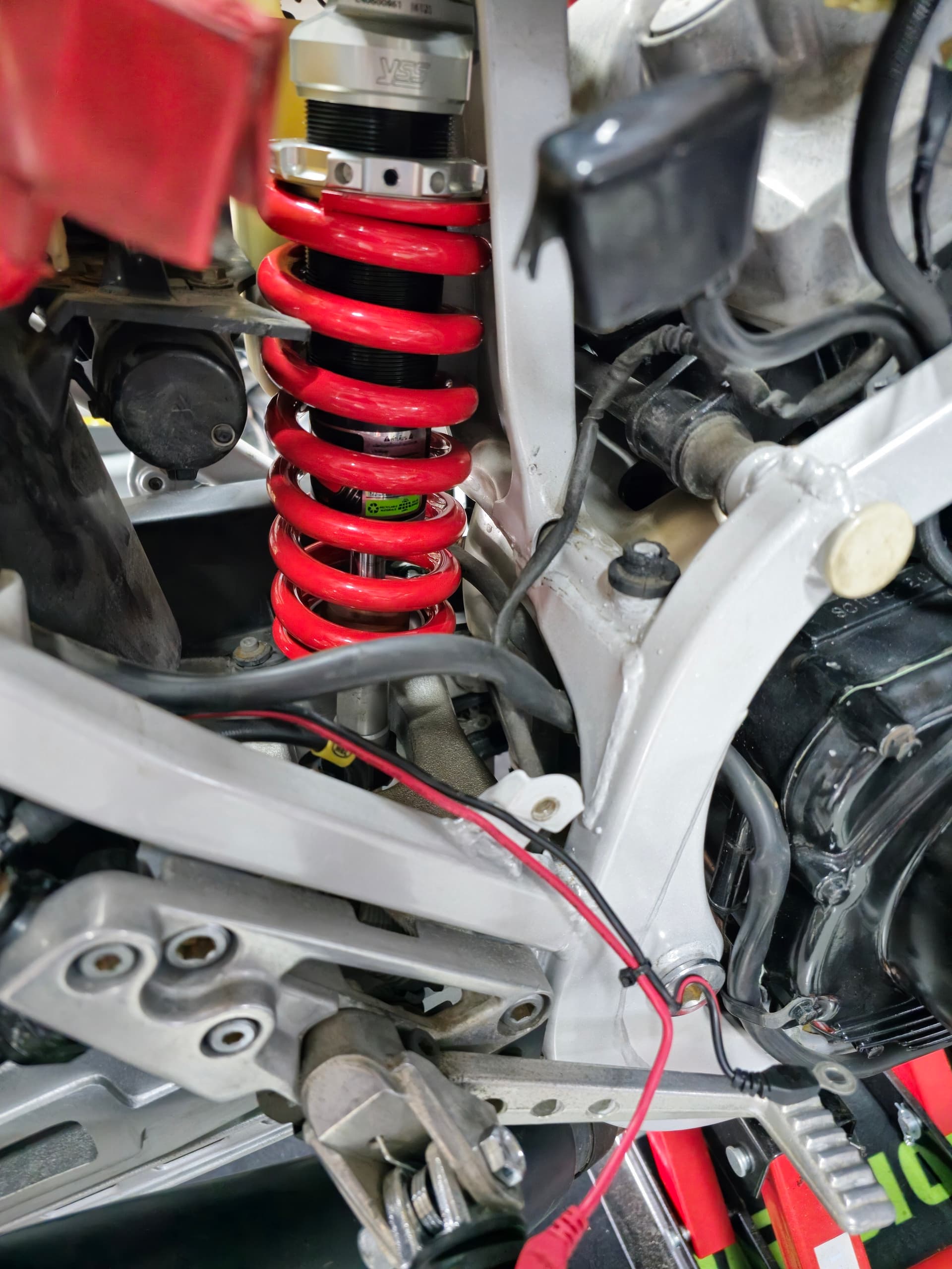

I fitted a YSS shock and fork valve emulators to my RE…transformed the bike into something that actually handles a bit.

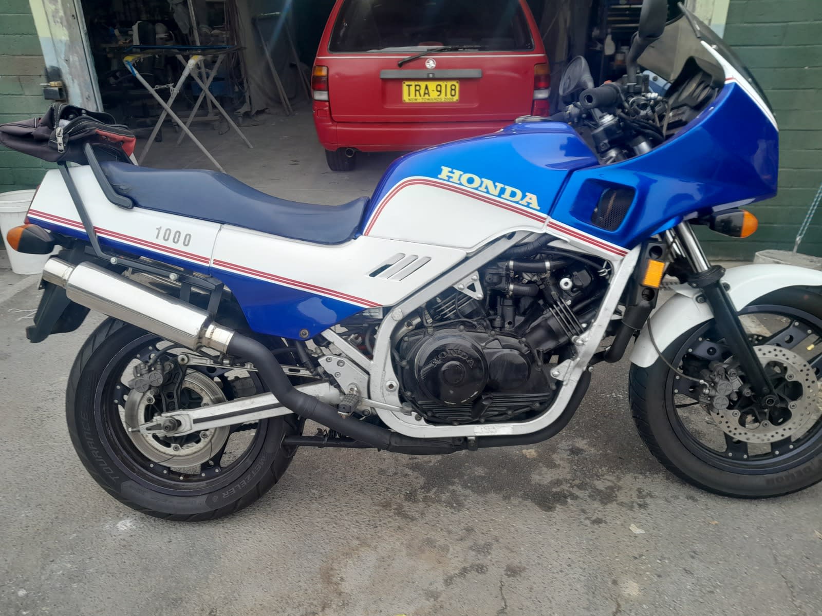

If you take your time and use attention to detail…you’ll get there in the end…I’m a bit anal and tend to go overboard a bit…This is my second RE, the first one was restored many years ago and sadly was sold off when I had to move house from Sydney to Brisbane ~6 years ago. I regretted selling it every day since.
When I first got this “new to me” RE, it was rideable but wasn’t happy at all, it ran poorly, engine ignition misfiring, variable idle, the carbies were poorly balanced and I suspect were a bit gummed up with old fuel, tyres were all cracked and suffering from old age… 40+ years had taken it’s toll, it had sat unloved and unused for many years and had suffered as a result. The previous onwer had unfortunately passed away and his family weren’t interested in keeping it and kept it in the back of an old shed under a tarp…at least it was out of the weather… I was happy to take it off their hands and give it a new home and do my best to restore it back to it’s former glory.
During my restoration I used many stainless bolts and screws wherever I could on non structural items. New YSS suspension front and rear, new titanium wheel spoke bolts, Samco coolant hose kit, I stripped the bike down to a bare frame and repaired all the little frame clamps and poor welds & powder coated the frame, new swingarm pivot, shock pivot & headstem bearings, overhauled/rebuilt carbies with a “Factory Pro” jet kit…one-off home made stainless “cross-over” headers and Polish Dominator mufflers, Italian Mold lab side covers, repaired/painted and new decals on the bodywork as required, new windscreen, new Avon tyres, new DID chain and sprockets, complete new ignition system, new brake kits, all new brake pads, front brake rotors, new Lithium battery, reg/rec and stator wiring… and lots more, the engine only had 27k km on it so it’s still in good condition with no oil or coolant leaks, I replaced all the engine side coolant related O-rings, external engine oil seals etc as they had gone a bit hard, as they tend to do over 40+ years…it came up really nicely… even if I do say so myself…a labour of my love for old Honda V4’s.. ![]()

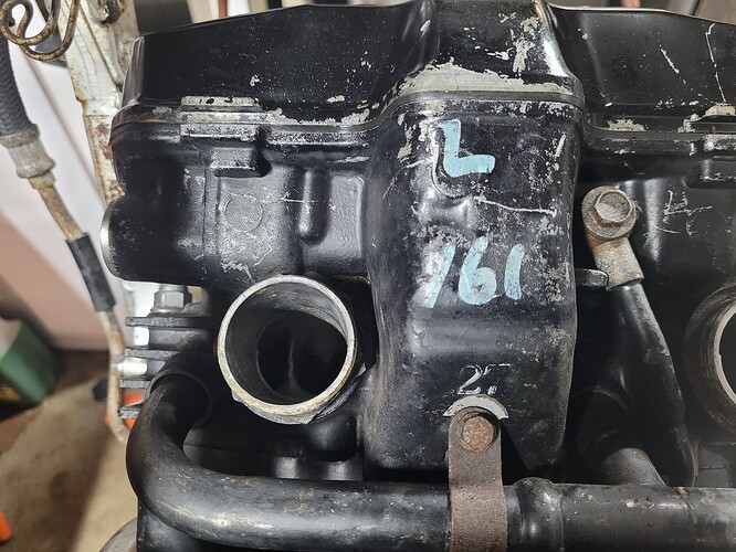

Those paint marking are factory originals, as are the ones on the back of the cases behind the exhausts. Those ones show which color code bearings were fitted from new.
The kit for the RE is considerably different to the F2. The R has a rsdiator behind the headlight , the F2 does not. It has radiator in the bottom of the fairing. Fairly sure the hoses are more than a little different.
I see what you’re saying, I got a set just to give me a starting point as all of mine are dodgy and I can not find a kit for the F2. Thanks for the help.
Thanks , I learnt something new, must be the original motor as all the engine bolts are rusted solid as well.
