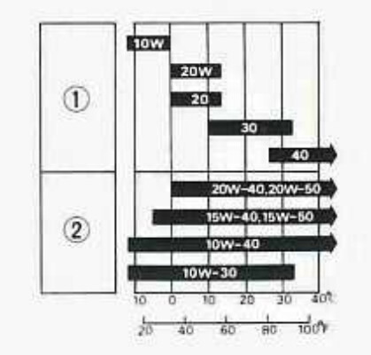

My Honda manual also has a table with varying oil grades depending on the local ambient temperatures. I can’t see an issue with using 20W50 if the ambient temps are within the range.
I actually use 10W60 Full Synthetic in mine…no issues to speak of. But we get silly ambient temps where I am….not unusual to see several days in a row of 40C+ in summer.
This is the table out of my VF1000RE “official” Honda workshop manual.
