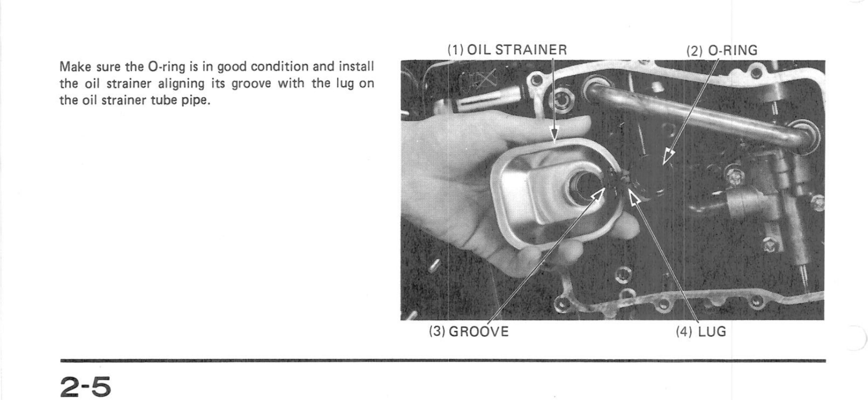

Planning to clean the oil strainer in sump with next service. Any tips to remove the strainer? (Once sump pan is removed.)

Hi tuffy, the oil strainer just pulls off, always interesting to see what they have picked up.

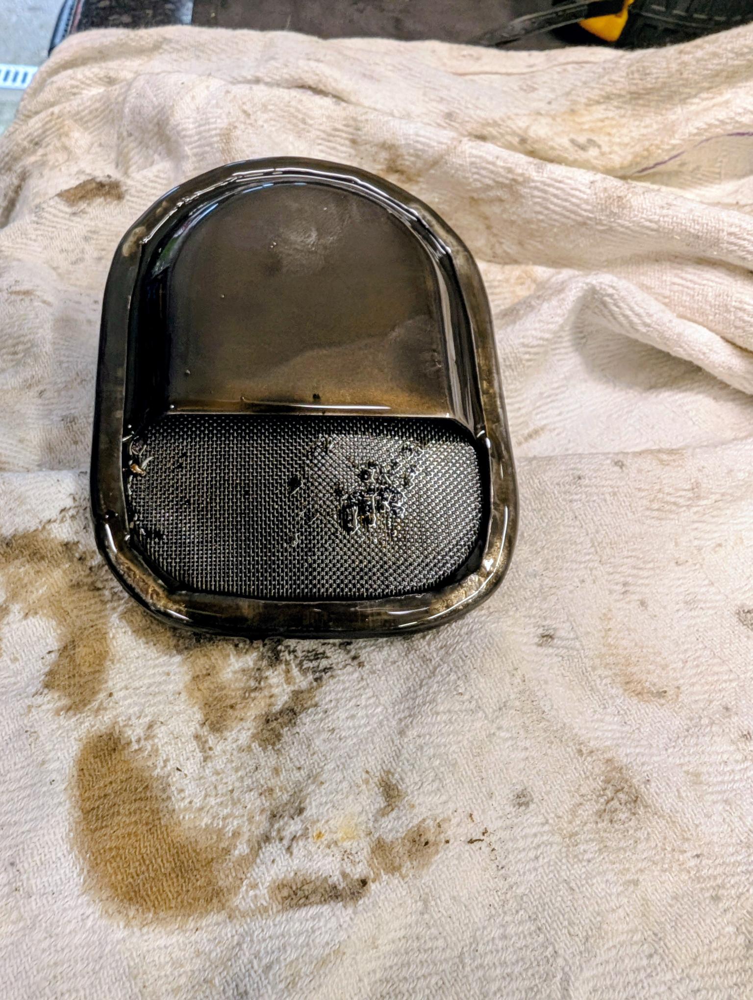

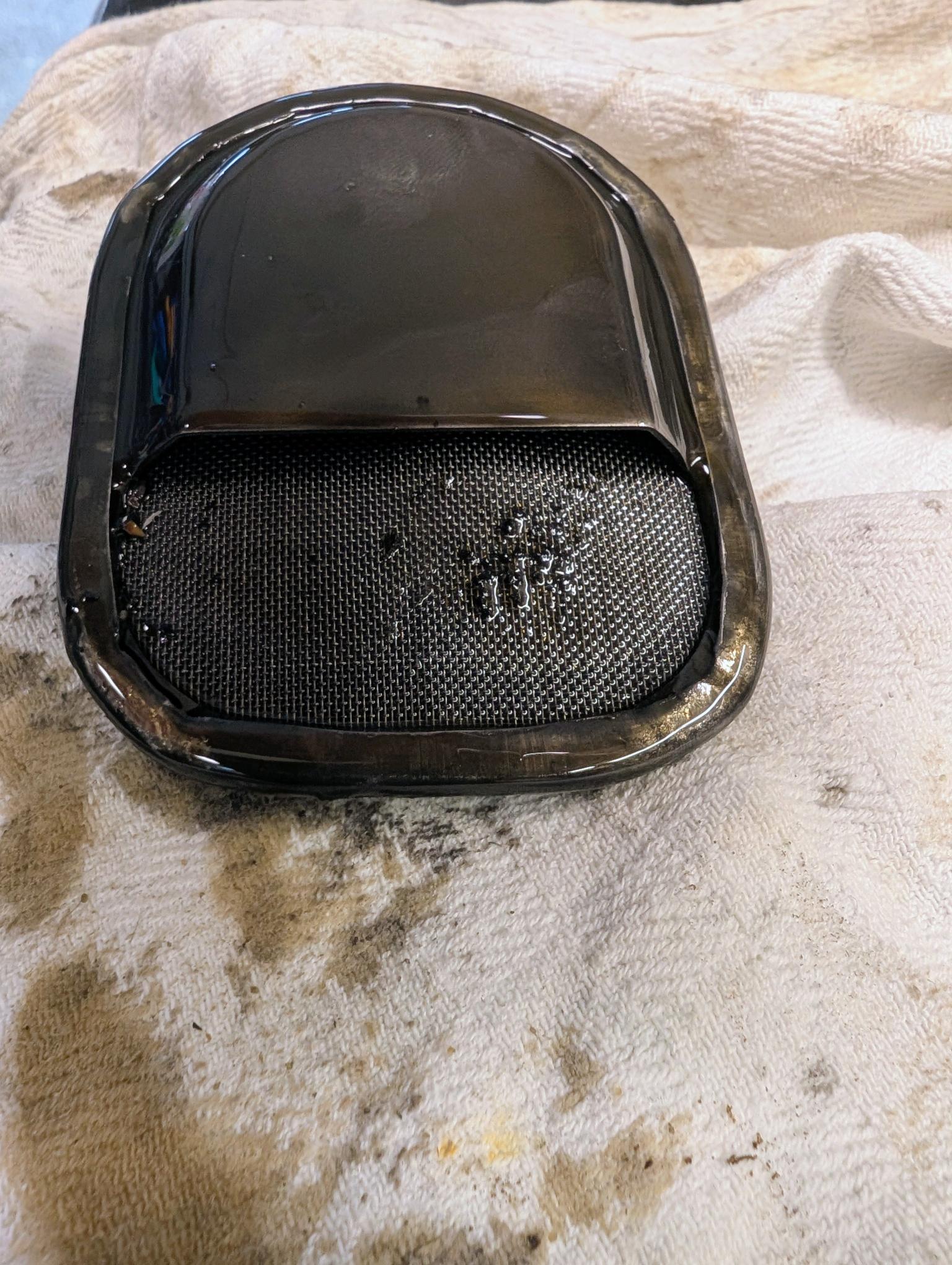

I will post some pictures after the cleaning β¦.
Have seen a lot worse than thatβ¦..often full of silicone sealant excess from the sump etc if earlier owners have had the sump off.β¦
