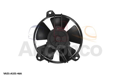

Hi gary, both fans should be sucking air through the rad, normally one turns clockwise and the other anti clockwise, I considered doing the stick coil mod on mine and bought some spal slim line fans to replace the honda ones, I haven’t as yet got round to fitting them…
Hi Pete, where did you get them from?
Hi gary, these are the ones I bought, I read through a post on another forum by an american guy “kel”, sounds like he just fitted one of these centrally and says he has no over heating issues…
I was going to fit 2 but haven’t got round to it yet…
You can even get some special fixing that fit through the rad fins, I dont know how good the are, my plans were to make a bracket…
Thanks Pete, have ordered one as I don’t think two will fit. Have fitted the coils and started her up with no issues but haven’t rode her yet, feels even better than before so Hope’s are high! Took some videos of the sparks with standard ignition then ignitech and standard coil and finally ignitech and cop coils but I can’t see much difference between them, will look on a bigger screen and if there is a difference I’ll post a link.

Fan fitted and some tweaks done to advance curve, have increased full advance to 37 degrees as stated in manual and have reinstated the dip in the curve from 1.5k to 2.5k to see if it makes any difference as I’ve cleaned out tank so petrol starvation should not be an issue. If all is well I will play around with the curve to see if I can make any improvement but without putting her on a dyno it’s going to be all guesswork. There is a dyno only 2 miles from me so might go and see how much to setup properly, the map should then work for anybody else with a VF. Not sure if a throttle position sensor would make any improvement but have bought one and will make a mounting bracket, as a test I removed the blanking plug for the butterfly valve on carb 1 and drilled and tapped rod and fitted a 3mm stud and an activator to turn TPS on a spare carb to see if it works and looks like it will. Will post any progress.

Already ordered the Spal fan x1 to delete the twin setup, free space and anticipate packaging issues for coils + reduce unsprung mass! ![]()
