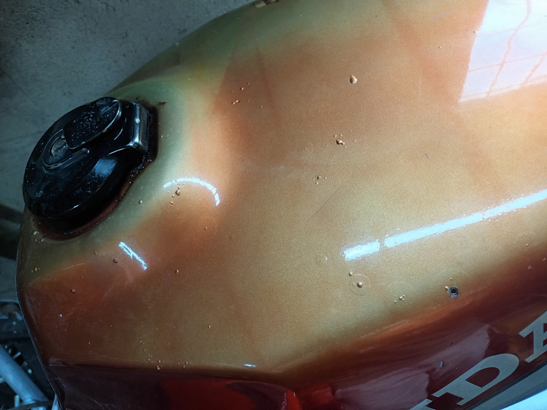

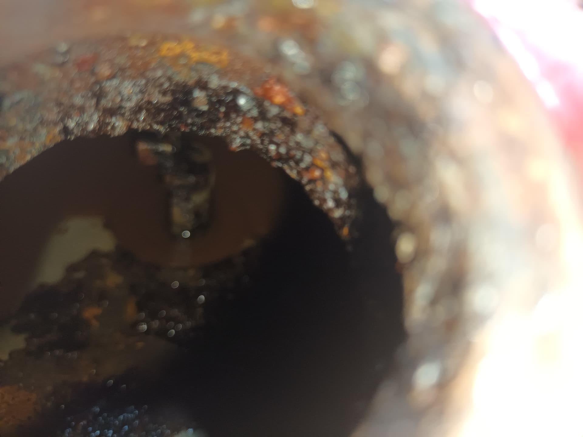

I have a somewhat rusty fuel tank. I can remove the rust with an acid but i suspect that will leave some pin holes where the paint is bubbling on the top of the tank. As tanks are hard to come by I am thinking my only option is to use sure seal or similar two pack epoxy tank liner to try and seal it up and prevent further rust. Not sure if the pipes in the tank will get blocked but I assume if i rod them through with wire before it cures I should be OK. I will need the puncture the filter gauze and fit an inline filter. Anyone have experience of this? Or willing to offer approval for this this plan?

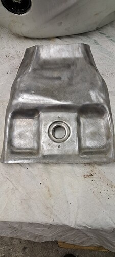

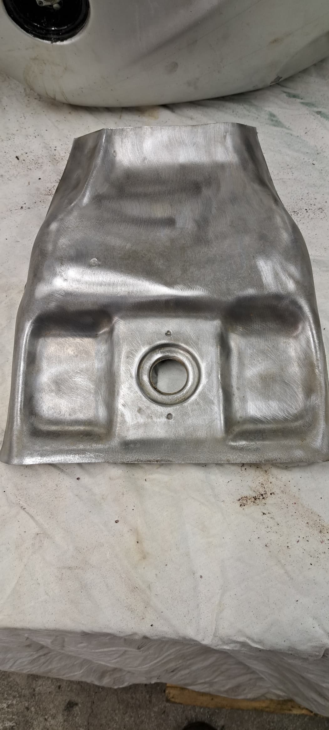

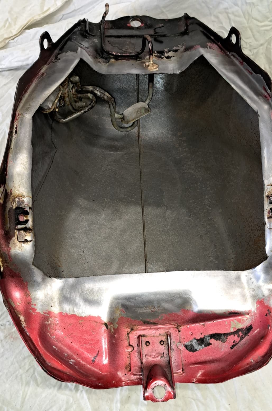

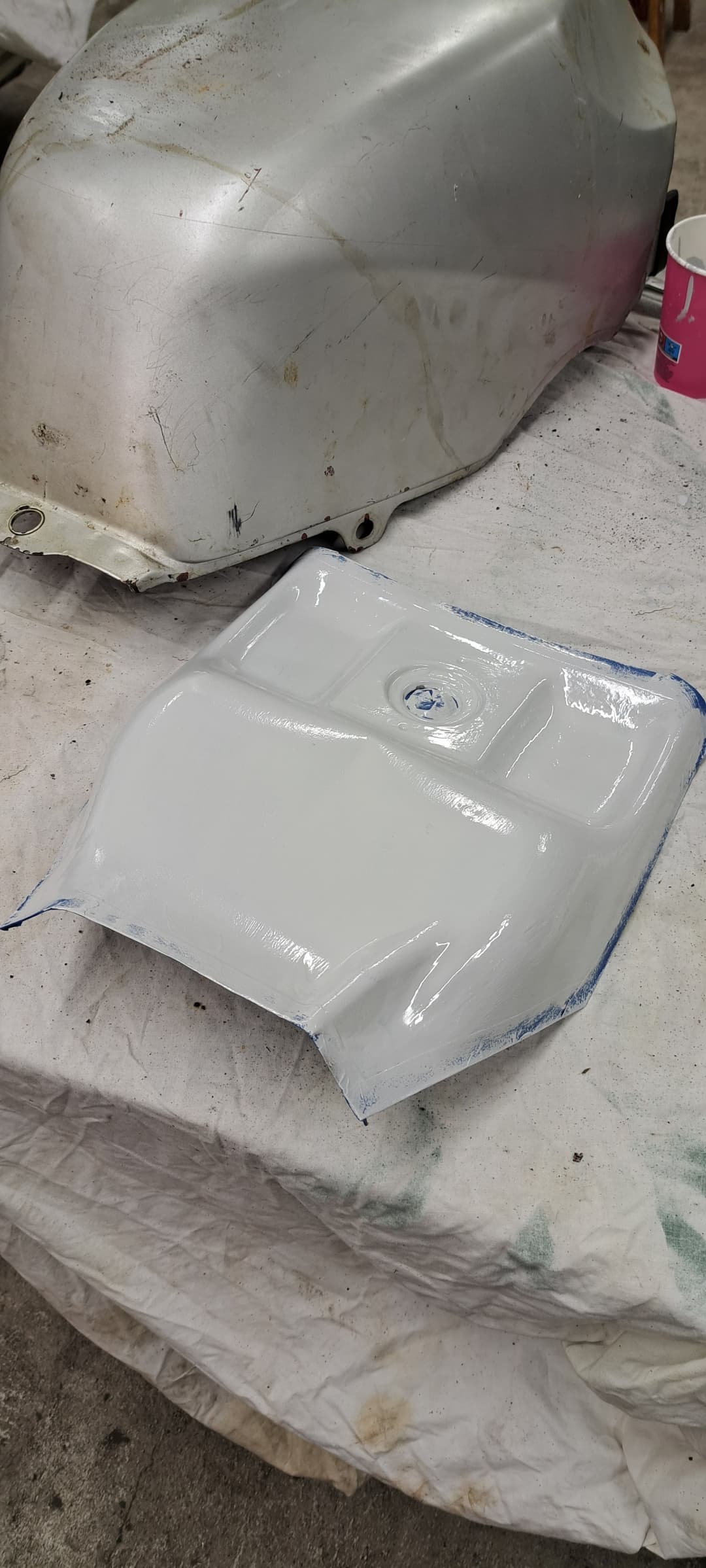

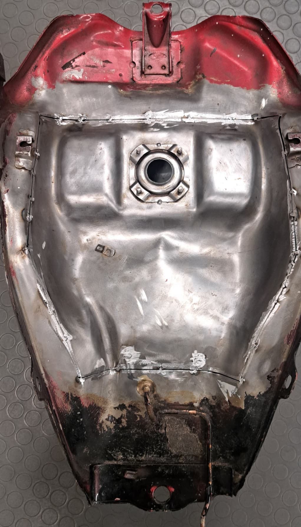

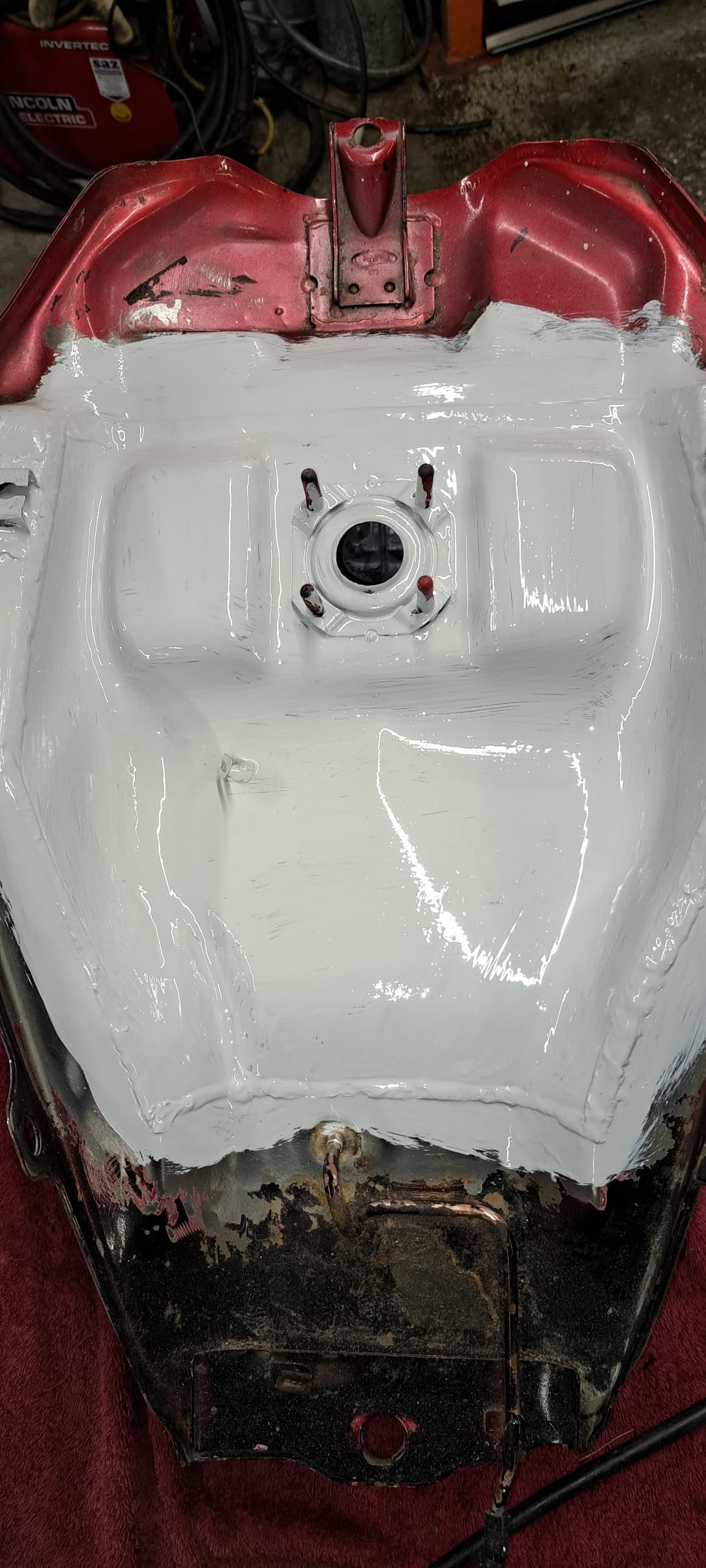

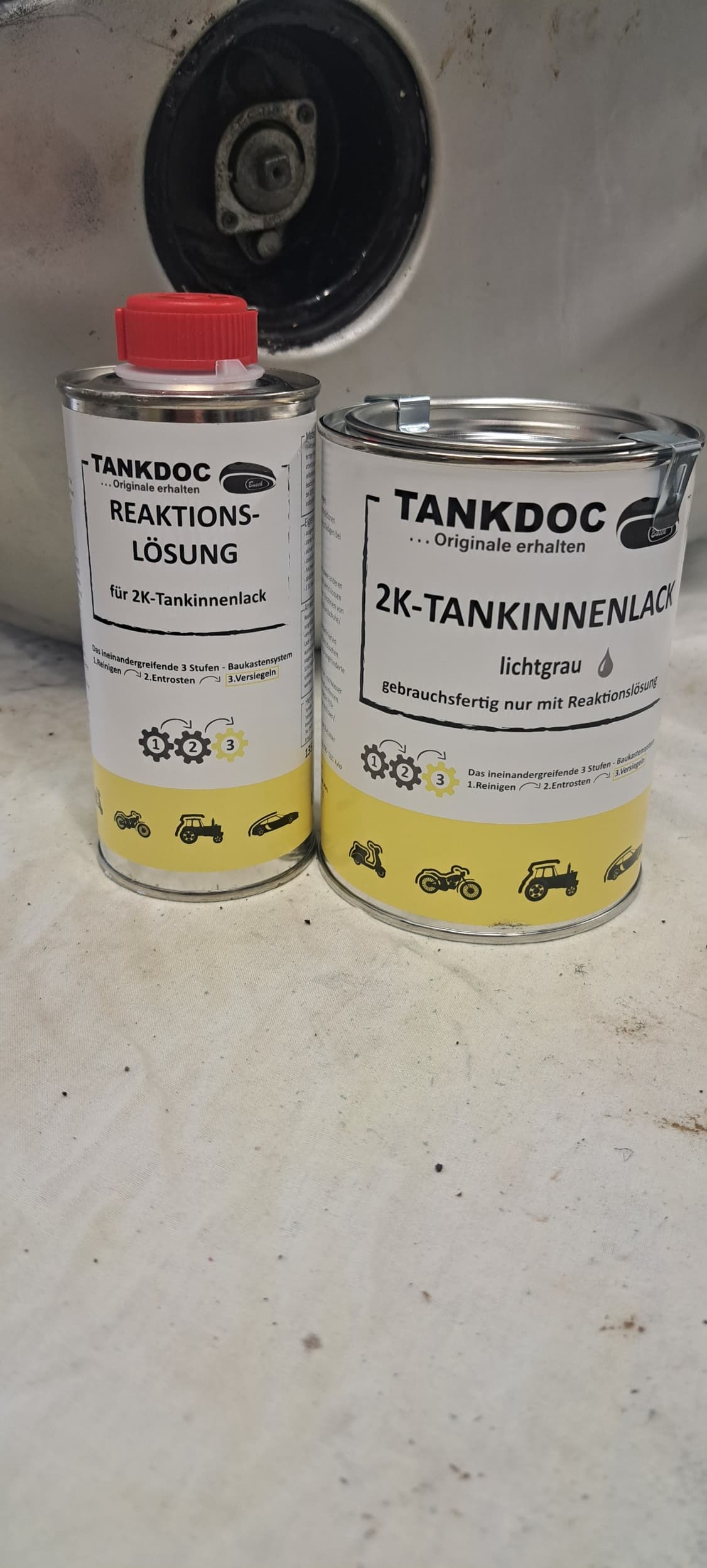

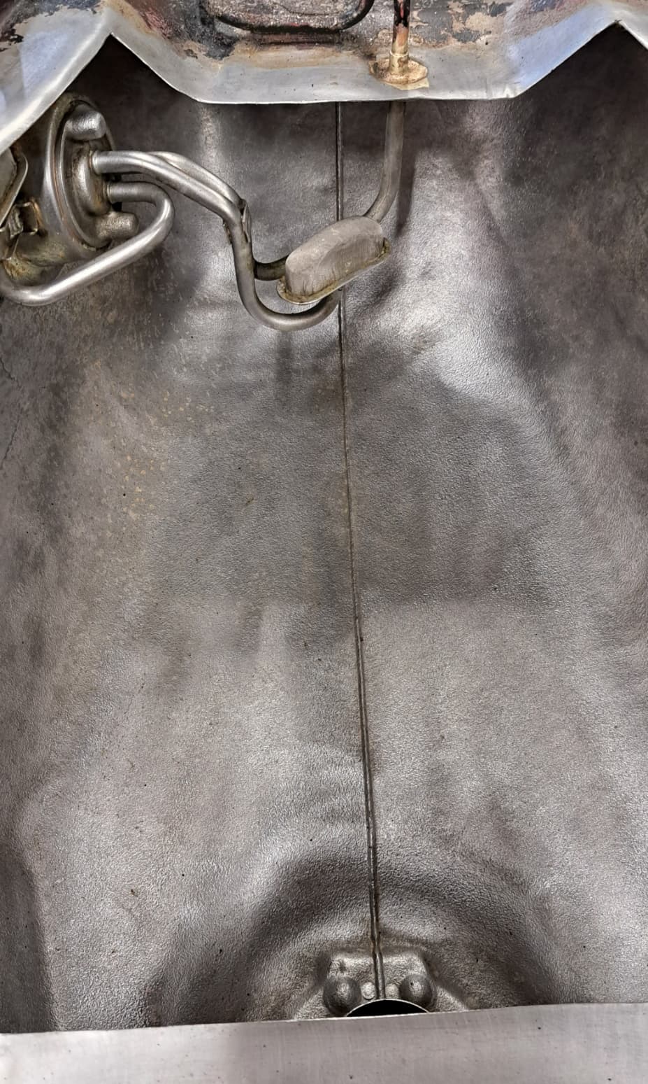

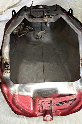

I’m just finishing up this operation. I pre-cleaned the tank with citric acid. Then I cut out the bottom section, cleaned and painted the inside, and now I’m going to weld it. Everything is pre-assembled, next will be laser welding. I used Tankdoc paint. - https://tankdoc.de/en/home-english/

@Qczu very interesting? Some questions: will you be fully butt welding along the cut? Will you now line the tank with a reseal product? If relining- how will you prevent the fuel lines being plugged by the liner?
Thanks, good to see someone else dealing with tank demons!

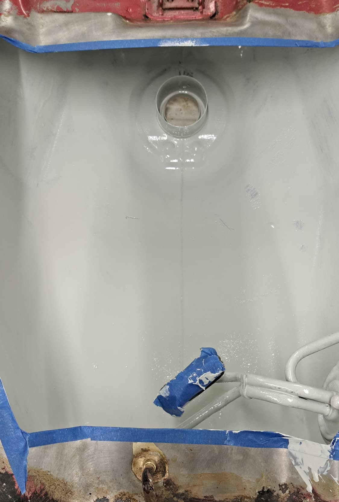

I left a small margin of bare sheet metal. After welding, I’ll pour in some paint and spread it gently over the bottom. Additional compressed air in the fuel line will prevent clogging of the lower strainer.
The weld seam will be additionally sealed. I don’t know yet whether I’ll use soldering or liquid metal glue.
Finally, I’ll paint everything with Tankdoc.

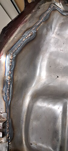

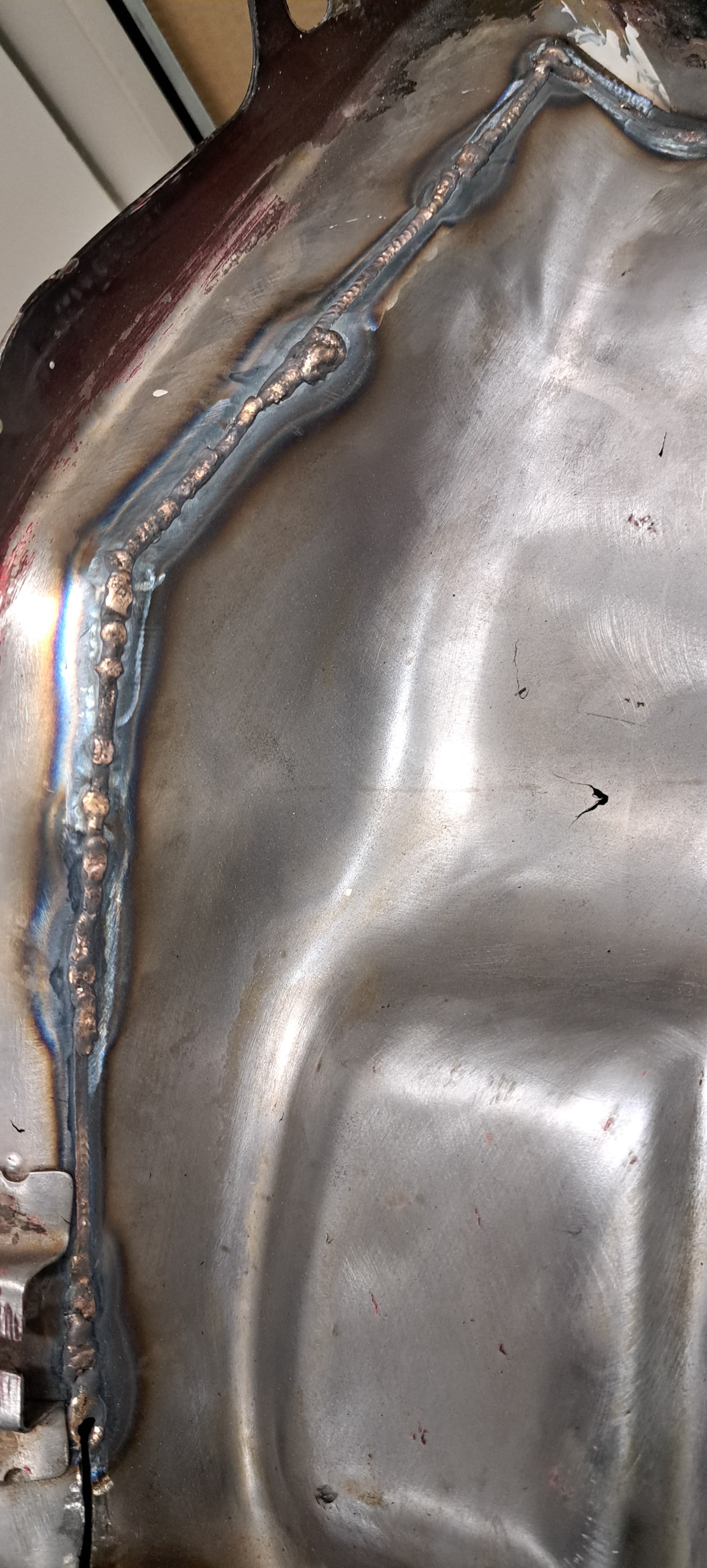

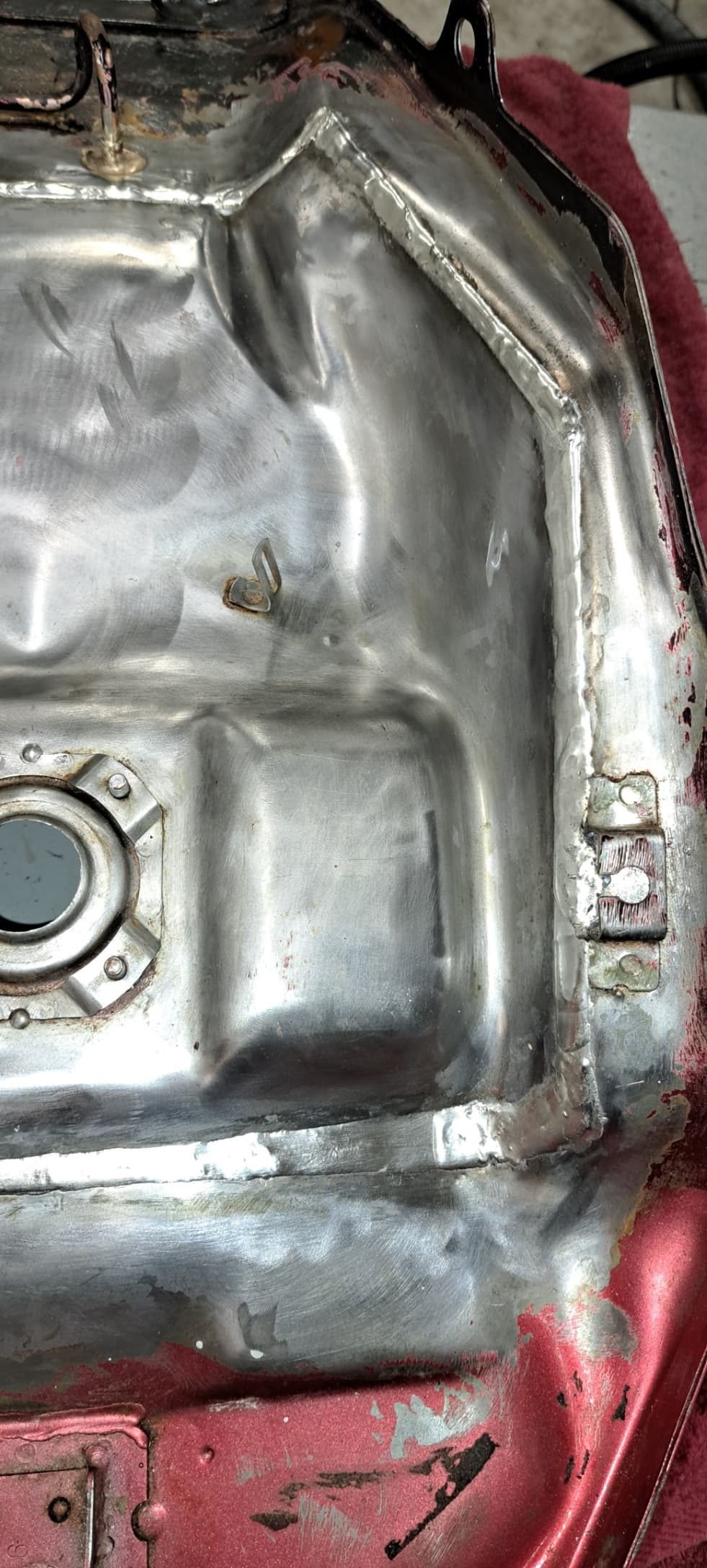

The tank is almost welded. I used the laser brazing method.

It’s time for the next step. The joint was filled with tin. To be sure, everything was painted with the same Tankdoc paint as the inside of the tank. The tank has been testet with compressed air + leak detector foam and is tight.
