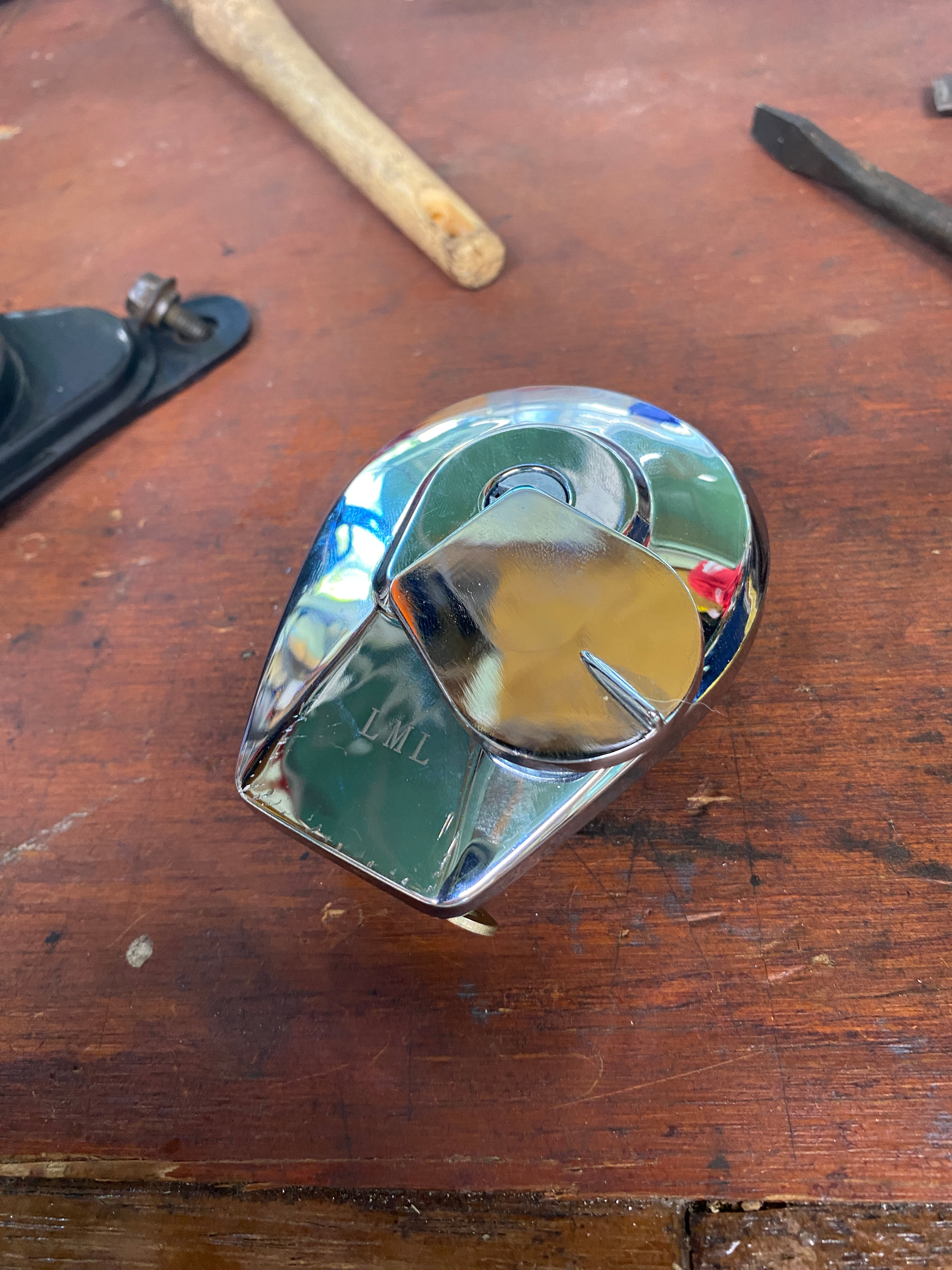

Ordered the AU$45 cap (“For Honda VF1100C VF500C VF700C VF750C Magna 82-88”), it arrived from Chyna in 2 weeks. Looked like this:

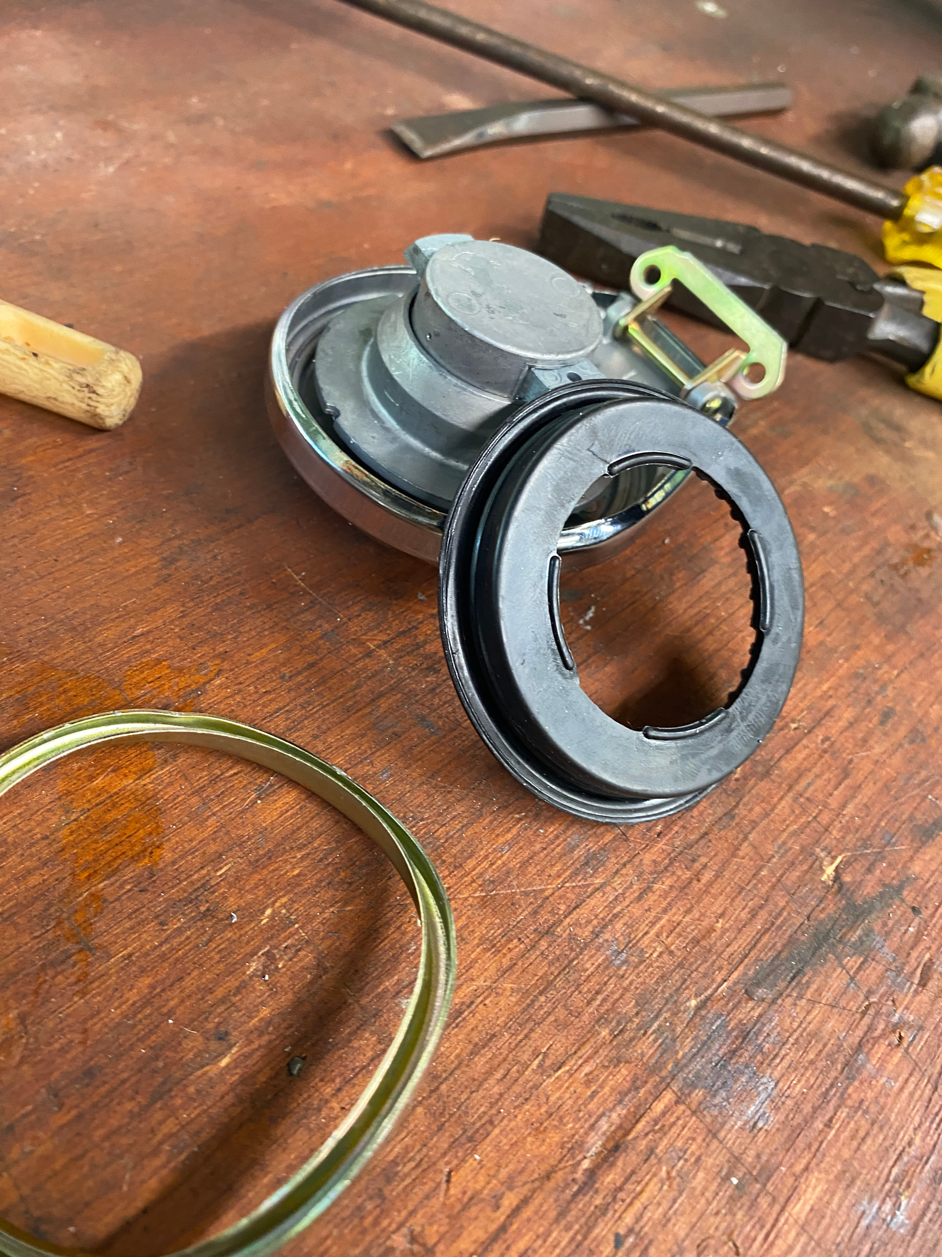

Some gentle persuasion convinced the rubber seal to pop out:

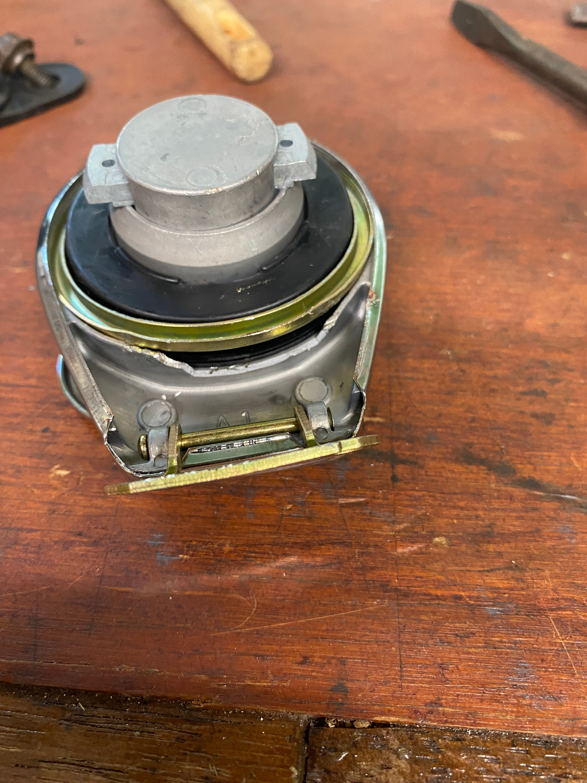

Aand it’s identical to the original in enough ways:
(Much more gently) prized mine apart, changed the seal out & pressed it back together. My one-way valve in the cap was f*#’d, luckily I had a spare, so now I can fill up to the top without gasoline sloshing out. WIN!!!
