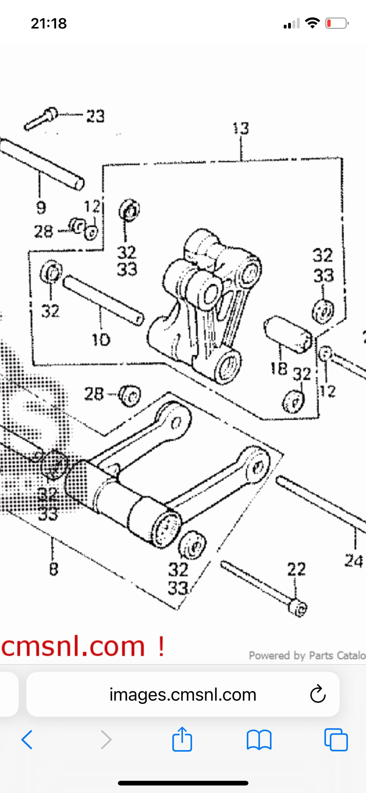

Hi. I am after the linkage bearing spacer for a 1986 vf1000 boldor 10x17x62. Would really appreciate if someone has or knows where to get one.
Can you post a pic of the parts diagram(CMSNL is good) showing the item you are looking for.

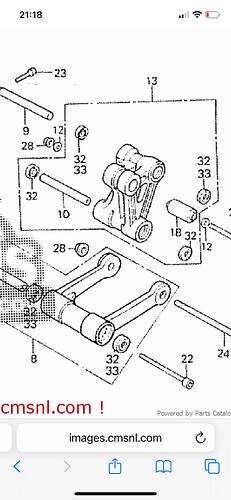

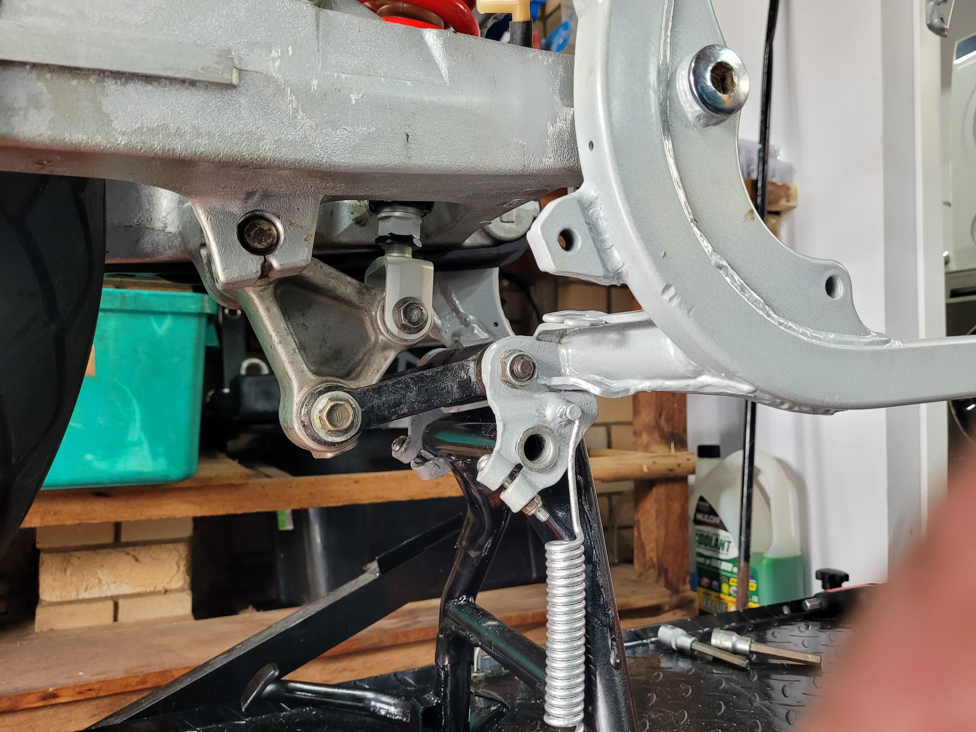

I need it for a 1986 vf1000 f2 bol dor, I can not find a diagram for my model hpwever here is a photo of my linkages type and you will notice my model does not have the same pivit as the vf1000f or R.
Picture 1 of 3
Vf1000r or f linkage
Picture 1 of 14
So,item 10 on this diagram

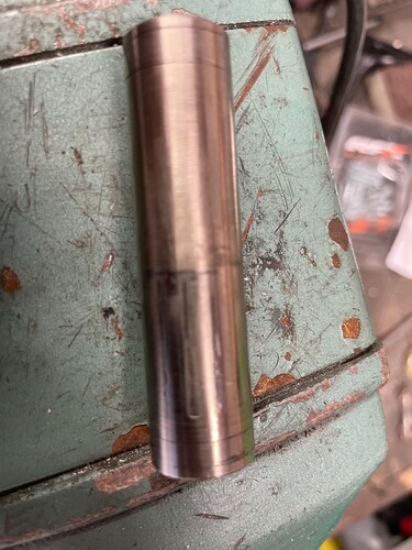

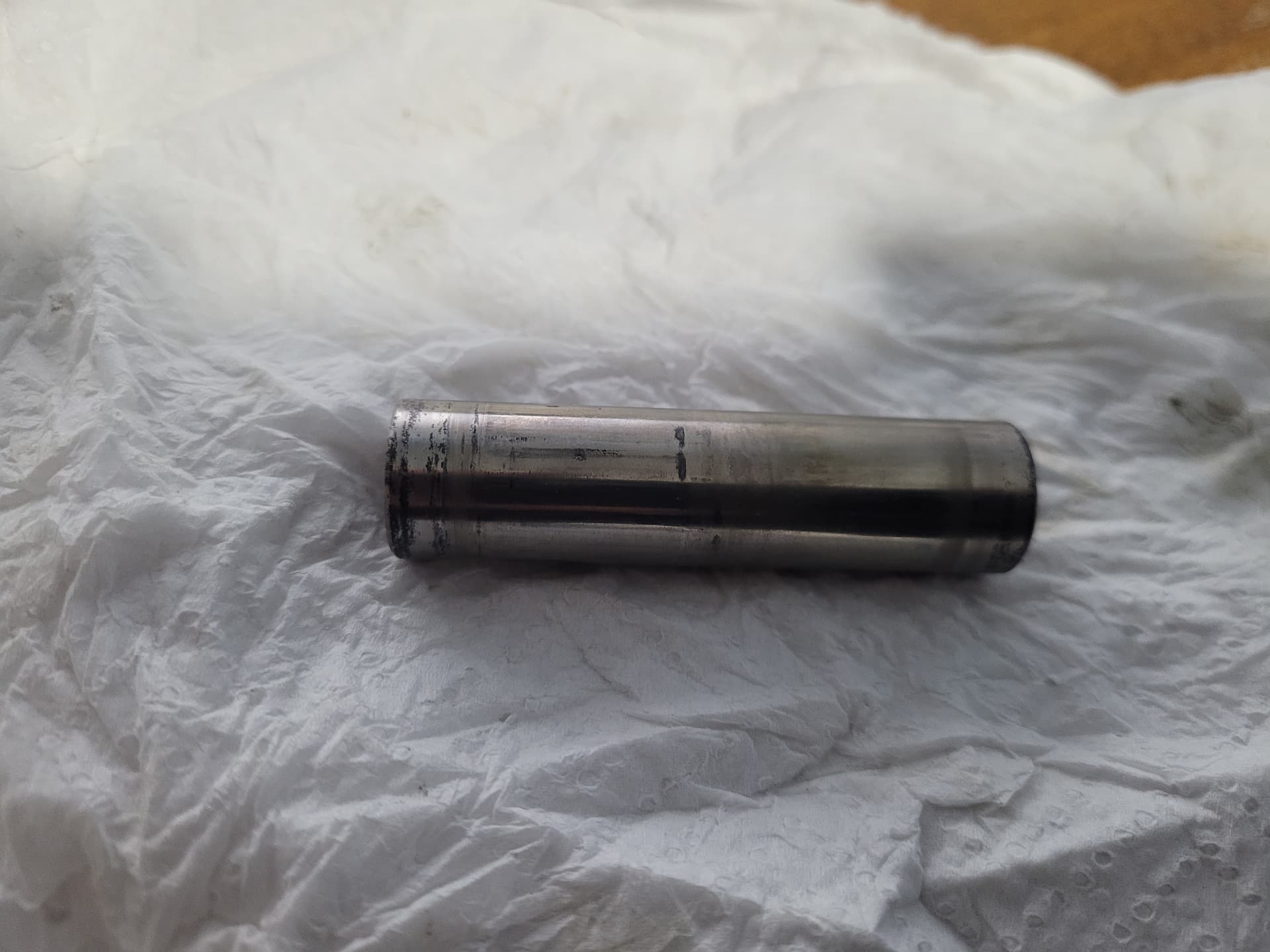

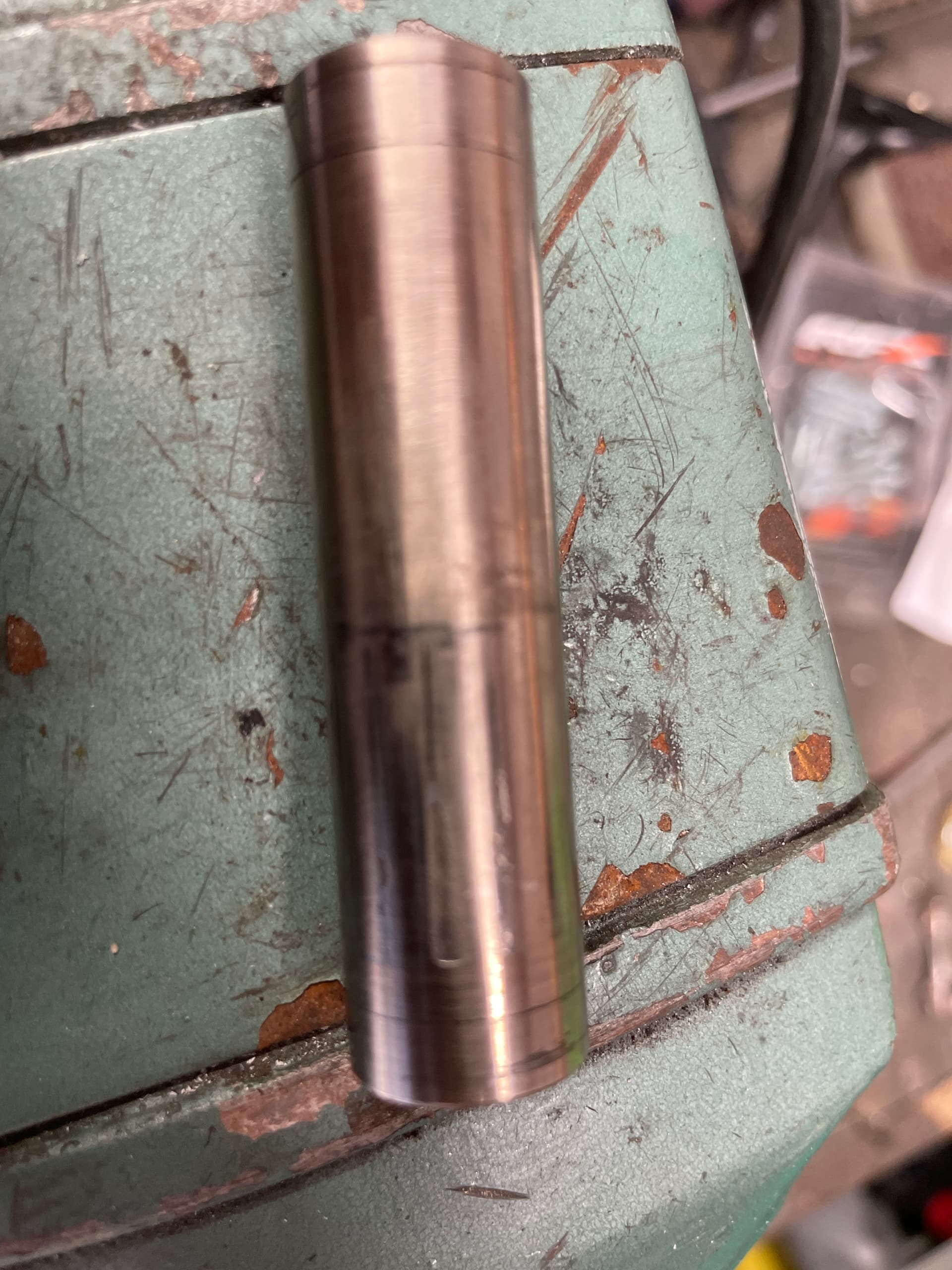

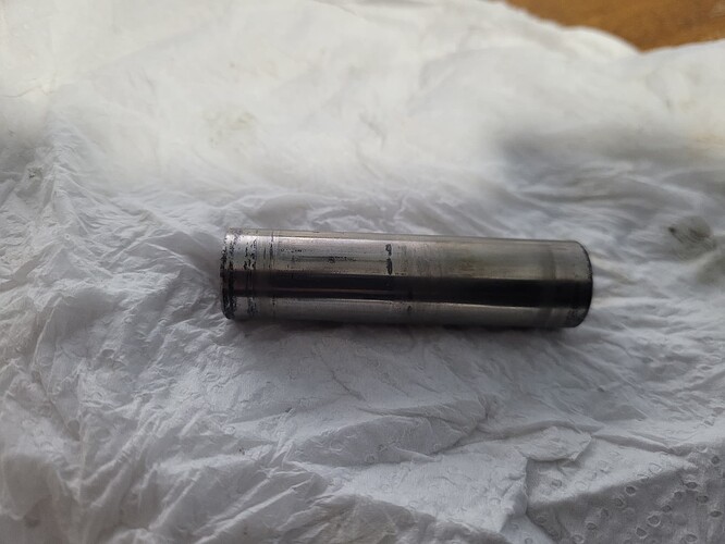

Appreciate the effort Bif, I finally got mine out of the bolt after 6 weeks and as you can see it is not good. Your measurements are correct, it is 67mm long.
The state of the bush would suggest the needle bearings are past it.A

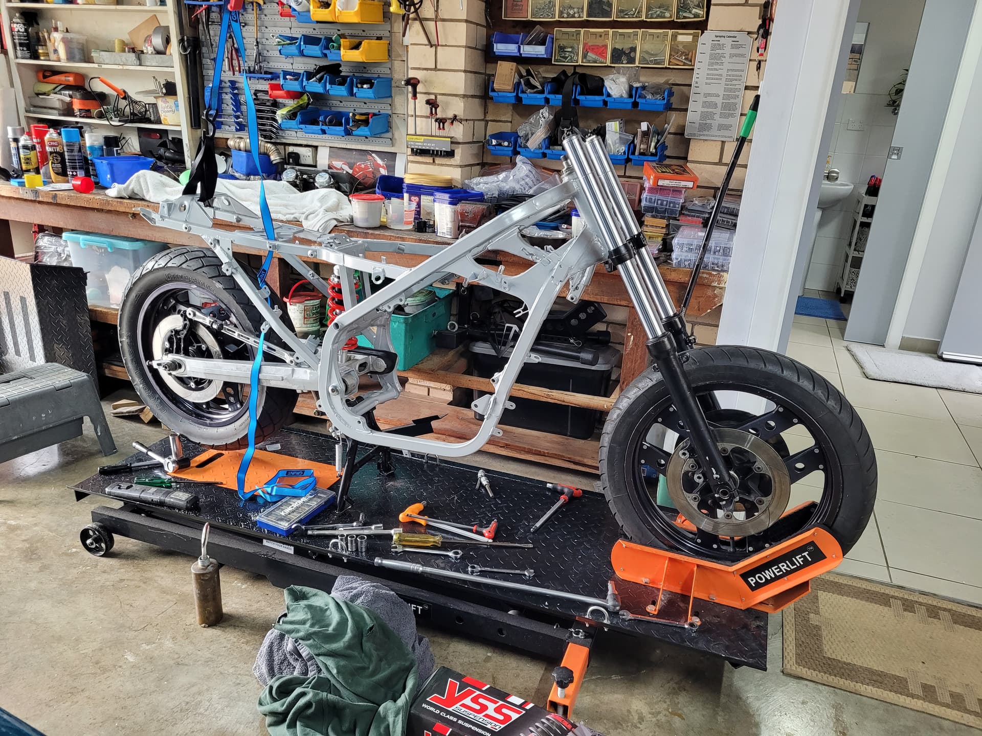

I got some parts from them. Now the work begins.
Coming along nicely…YSS shock I assume..?? Good choice, they work very well in the old VF’s. Keep the progress pics coming…this is what we live for.
