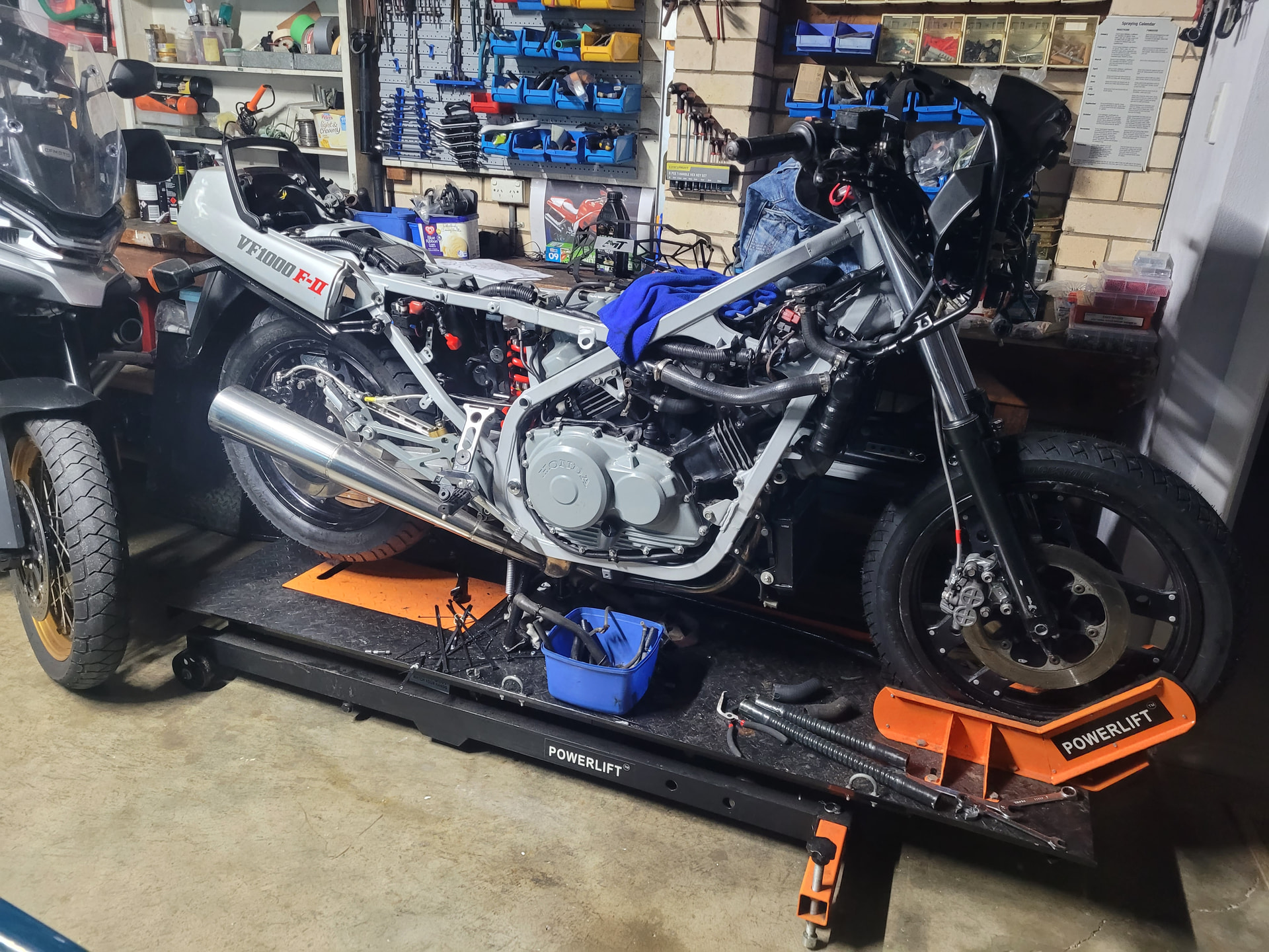

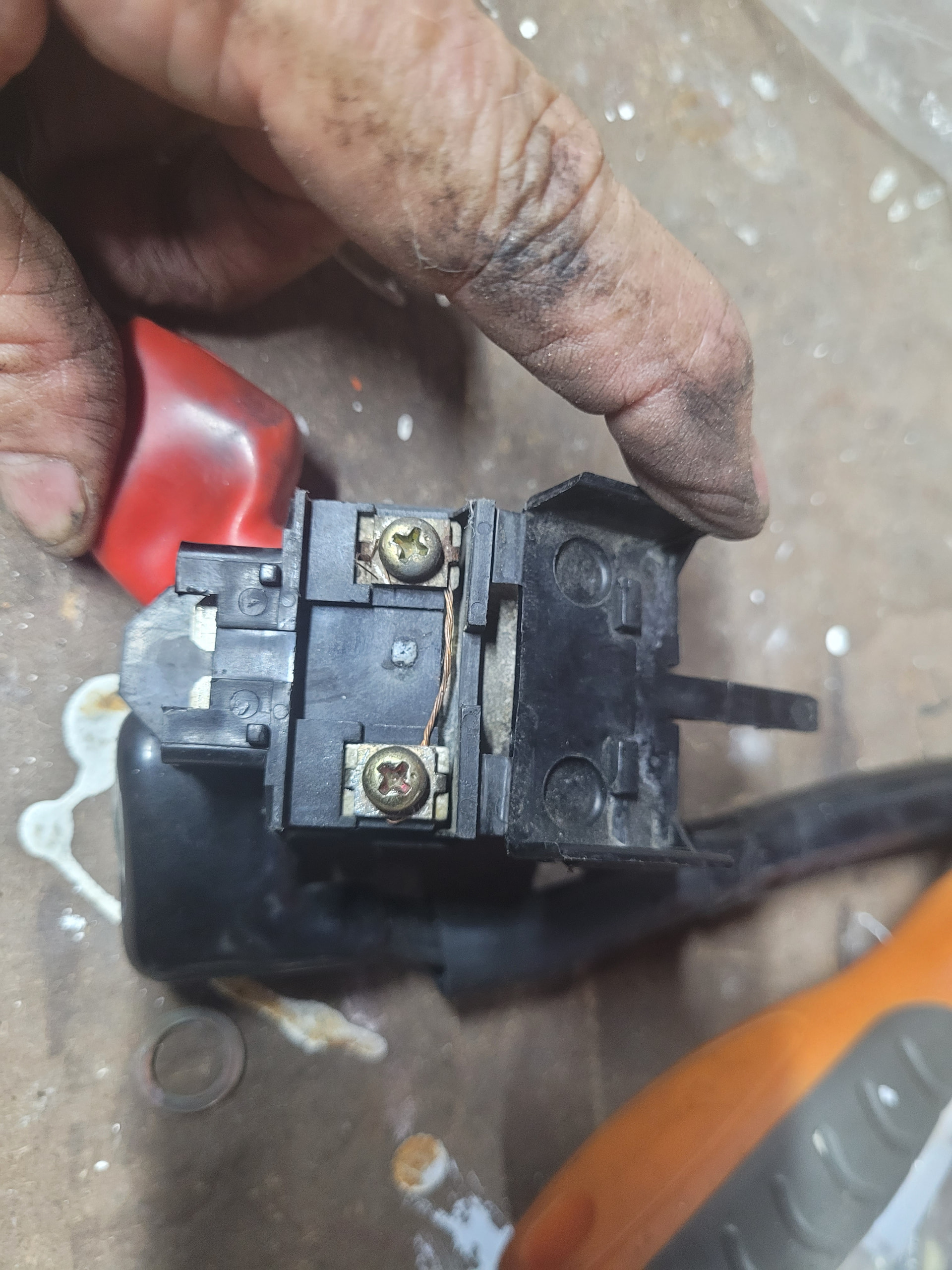

Just an update, it is slow progress. Got to love the fuse. (house wire strands)

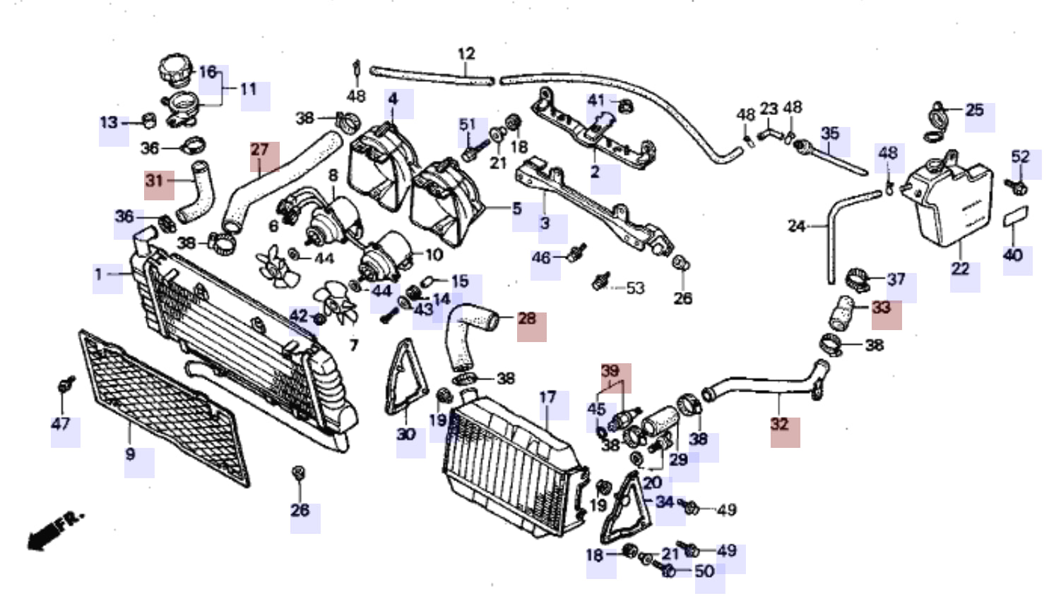

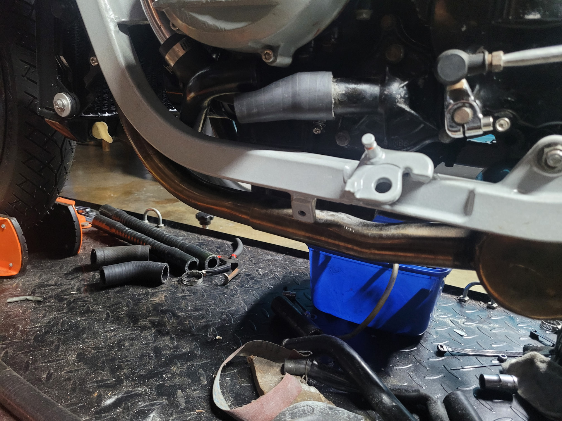

I am having trouble getting my head around the cooling hoses at the lower radiator to pump connection through the exhaust. if anyone has a helpful hint or a photo of the routing It would be appreciated. I have a vfr750 as well which has cuased slow progress.
Does this help..?? Just remember, the ‘84 FE is different to the ‘85/’86FF/F2F/F2G.
I might be telling you something that you know already, but, for an F2, the thermostat housing connects to hose 27 in the above picture, but it’s not yet been fitted to the bike, where it would be visible just before the triangular engine mount by the rear head.

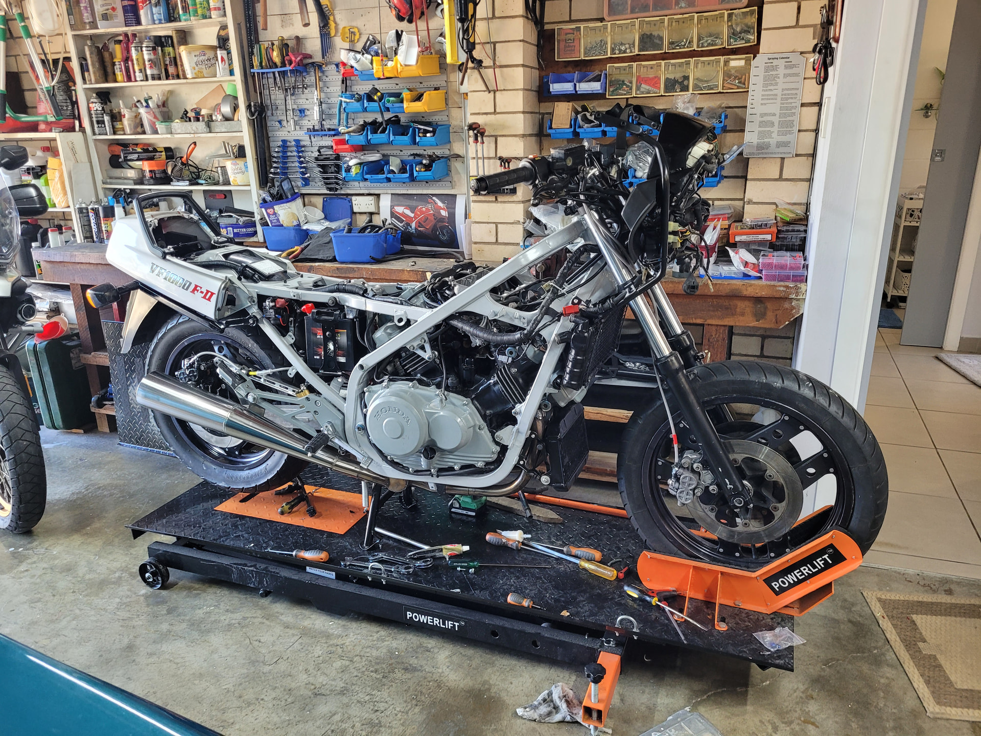

Thanks, I have already done that side, it is hoses 29 and 32 routing and if they have a spring on their outer. I have a sabco set of hoses which the majority don’t match my model which I think is making it very tight and I am worried about the headers heat. Is there a trick to this.
Sorry, earlier photo before,latest version.

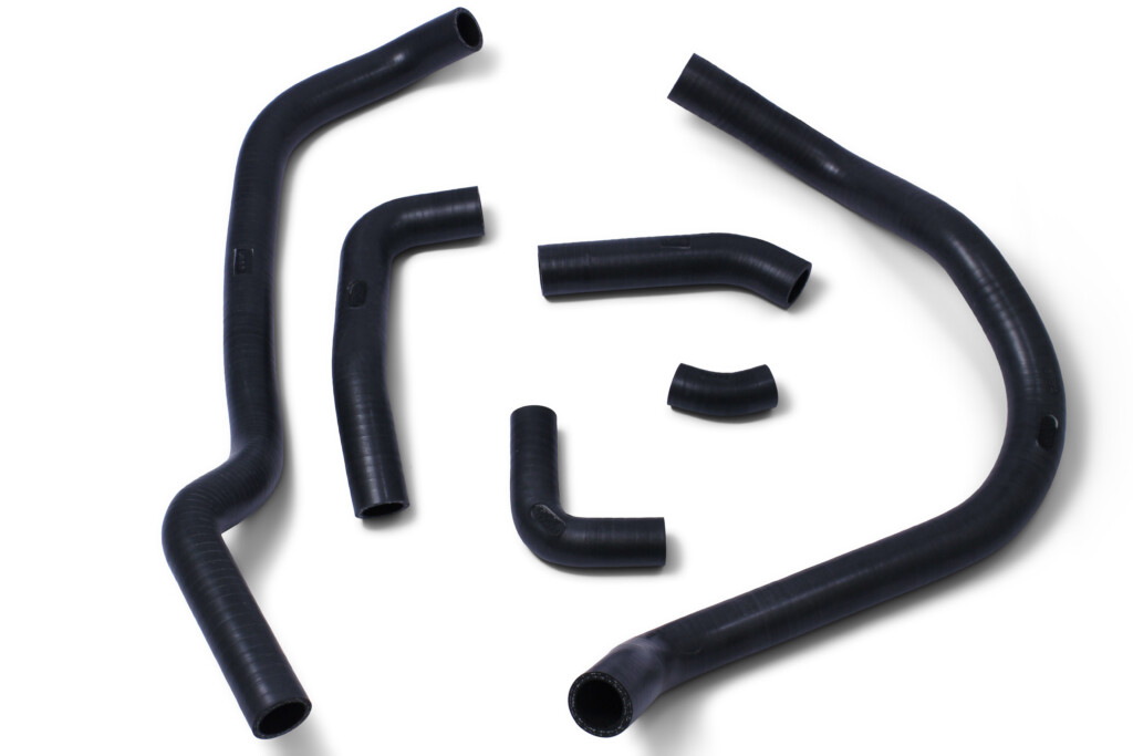

Samco makes kits for the RE & RF/RG…The RF & RG kits should be similar to the ‘85 FF’s.
Yes they probably are but I have a 1986 vf1000 f2 Bol Dor and I paid $450 for the sabco and used about 3 hoses, they are slightly thicker than standard. Still I would like a photo of my model’s installed lower hoses.
I believe it’s “Samco”, not Sabco….strange you’re not using most of the hoses though..!
The VF1000FE and VF1000RE kits are very similar.

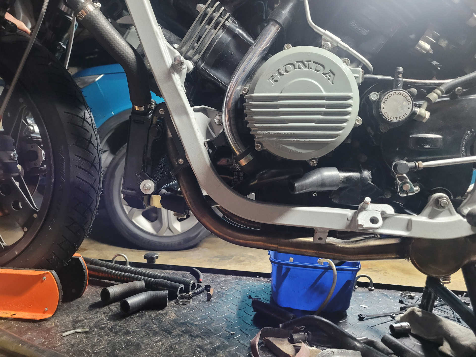

The f2 boldor has a completely different cooling / radiator set up to any of the other vf models, its the only one with a lower small radiator, the piece that crosses the front of the engine close to the exhaust headers is steel tube :+1:t2:
Sorry you are right, must of had mops in my head.:laughing:
It’s an easy mistake to make, although all the vf1000 models look very similar, they do have lots of differences and the f2 is more different than most in the cooling department, its a while since I owned a f2 boldor but number 29 on the previously posted parts diagram is steel, its the one that passes closest to the exhaust..
So as from the photo I have the routing correct with the steel section to the pump. I will try to connect tomorrow again. Thanks for the help.
Got everything connected today and you won’t believe it, the lower radiator is leaking. and it looks like another bogey job with some sort of putty. So it continues!
