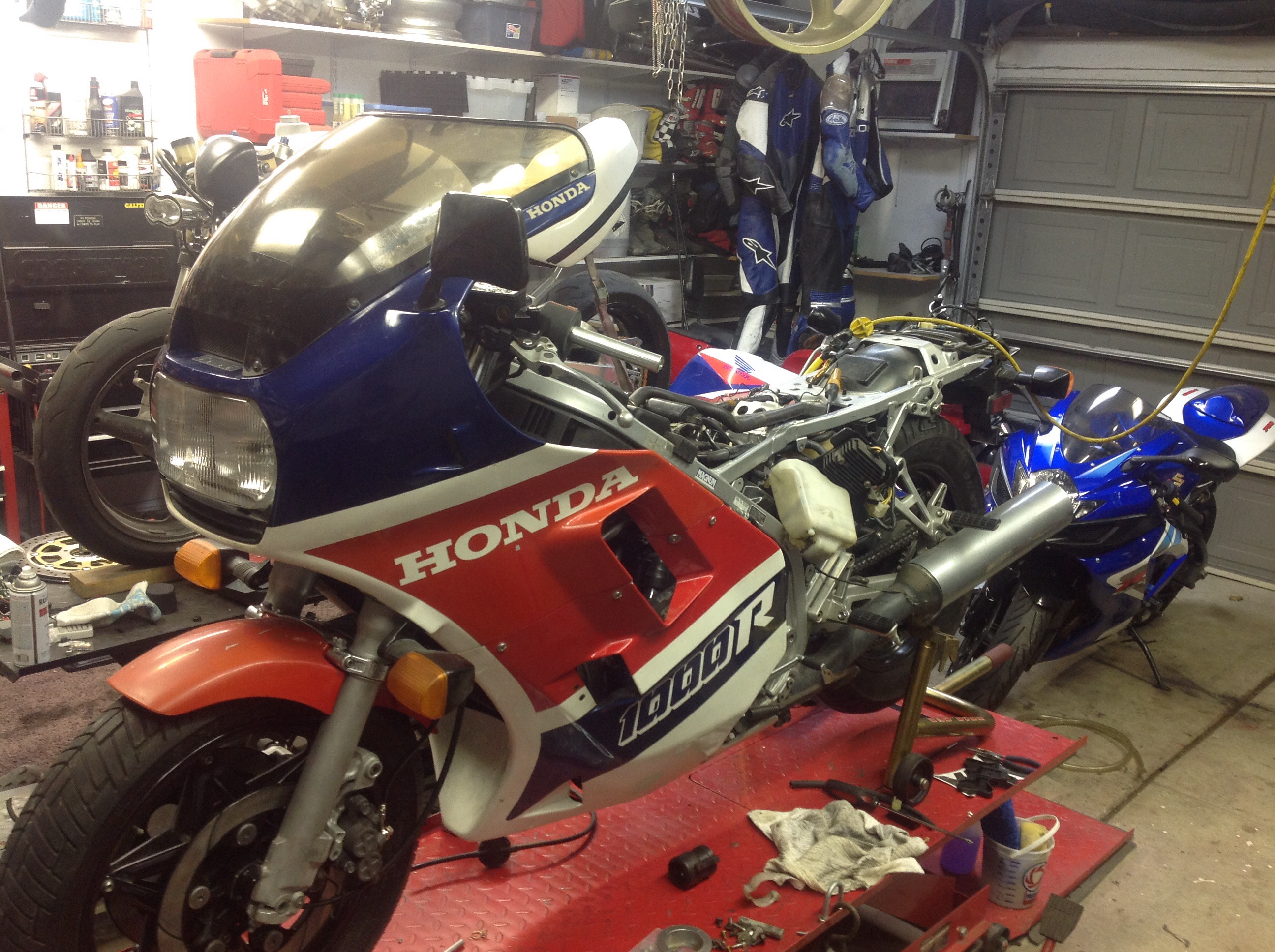

Here’s the bike in current state. The other side has some rash so it will need re-painting, I’ll deal with the bodywork once I have it mechanically complete.
