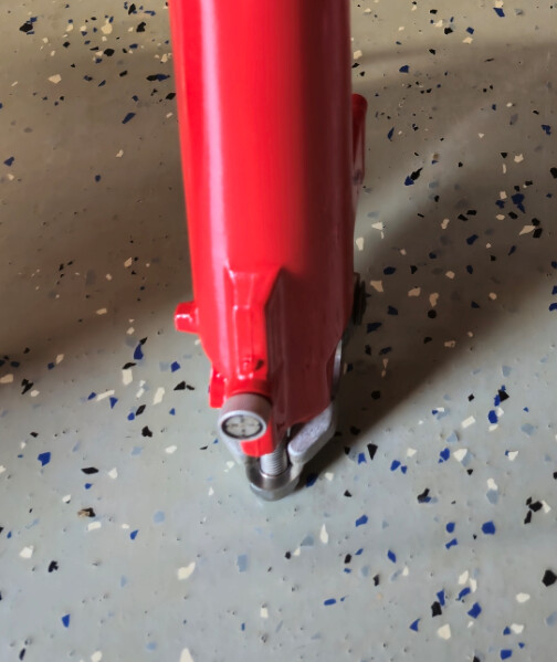

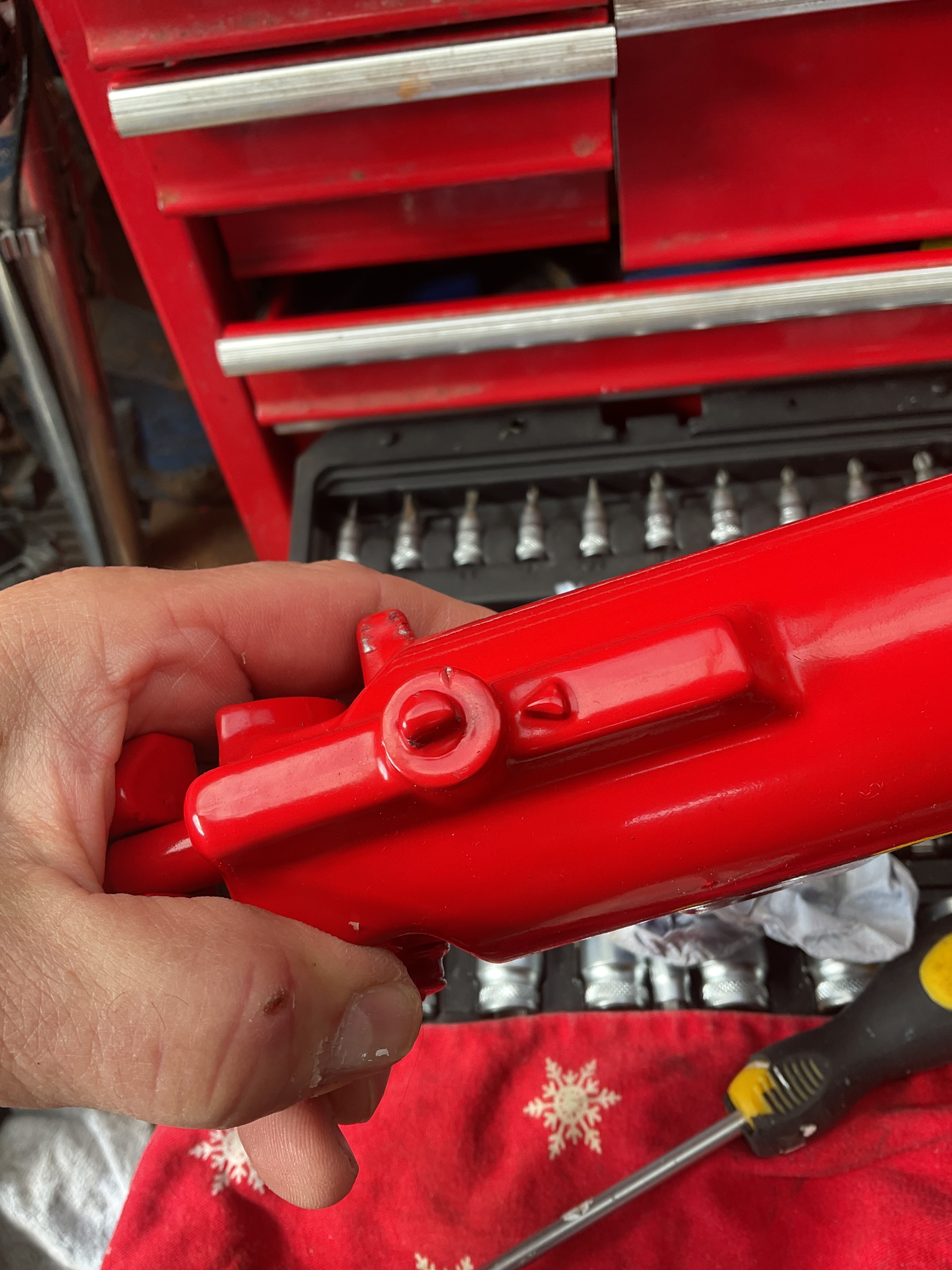

I’m still trying to sort the crap job somebody did with my forks… I’m going to change the adjuster so it’s all done properly.. as you can see it’s been sprayed.. not sure how these come out if anyone can shed some light on this one. Thankyou. Sean

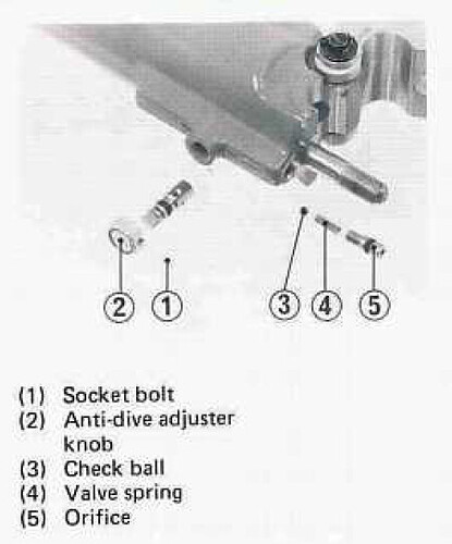

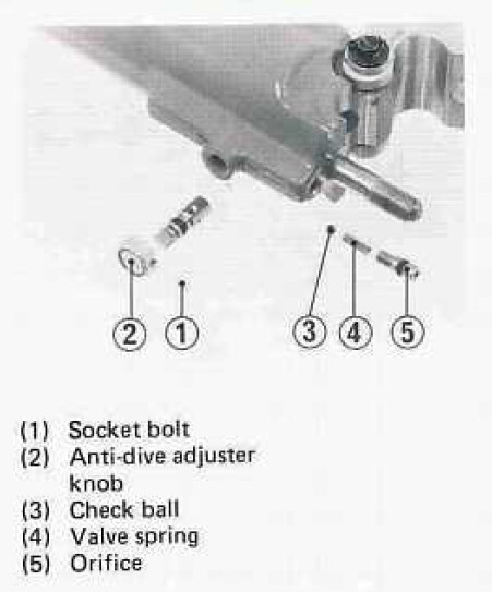

Pretty sure there’s a spring loaded ball & orifice which is screwed in/fitted from the bottom side…Once that is out, the adjusting valve should hopefully just pull out. I did mine and replaced the tiny O-rings when I fitted the YSS fork internals. They never worked very well, even when new.
Ok cool.. thanks for pic Smithy :slightly_smiling_face:
