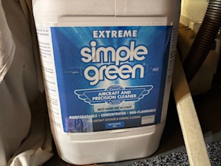

Simple Green and extreme simple green to finish off

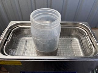

I put clean water in the cleaner and put the solution in a plastic jar with the parts.
Keeps the wastage of cleaner down try calling aircraft maintenance places
The extreme simple green is designed for aluminum parts

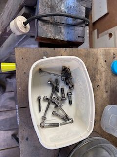

I just use garden variety isopropyl alcohol in a plastic/glass container as “kiwihonda004” mentions. Works fine. If there are stubborn deposits I bring them to my work and use the wallnut shell blaster…
For bigger parts I use a plastic bag as will mould around it.
The extreme simple green brings up aluminum really well 30% solution.

What dilution rate did you use with Extreme only 30%?
Reading the info on it, heavy cleaning is 1:1 but could corrode metal?
No mention of what metals though. Mild cleaning is 1:13 with no corrosion of metals. With 30% you noticed no adverse effects after cleaning but got a very good clean?

65 degrees temp for me. Not recommended to put hand in machine when going.
