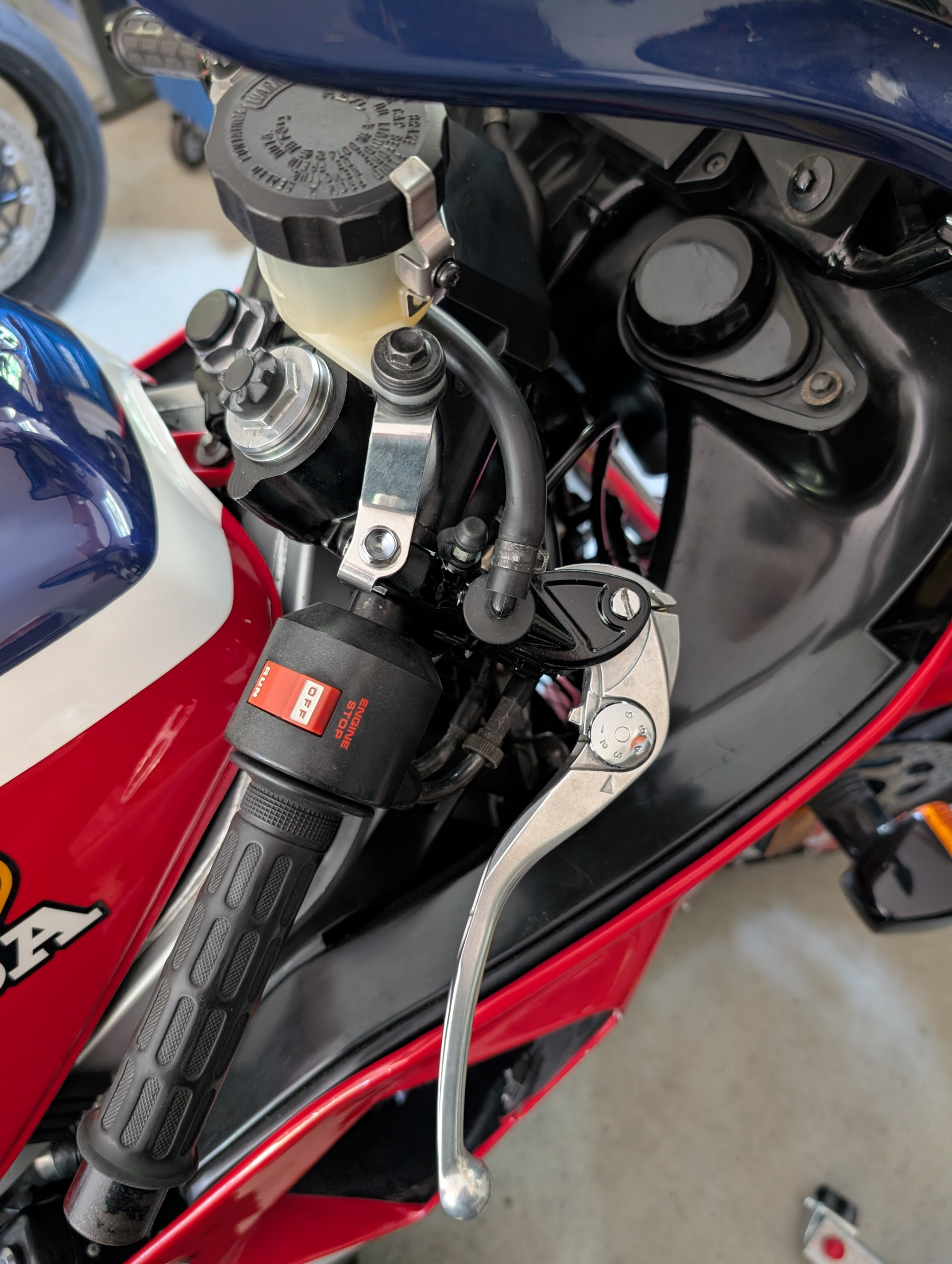

I have mounted the pump of the CBR600 F4i and now it works pretty well. It’s not the breaking power, it’s the control. Using one or two fingers it’s possible to control the progression very well.
It’s a little bit tricky to mount the pump to avoid collissions with the cap of the radiator and also the instruments. Maybe the alternative pump of the CBR600 F4 with the intregrated reservoir would have been the better choose, but that’s complaining about first-world problems.

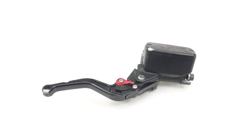

That’s not a CBR600F4i front master cylinder. The F4i doesn’t have a remote reservoir.
This is an F4i master cylinder:
More than likely it’s a 2004 onwards CBR1000RR or 2007 onwards CBR600RR master cylinder.

Smithy1 you are right. As I bought it, it was labeled CBR600F4 (PC37), but my master cylinder is from a CBR600RR (PC40).
Dear Bif, I took both for a test ride. For me the CBR600RR master cylinder definitely allows for better control when braking. The braking power isn’t increased, but the modulation is significantly better.
