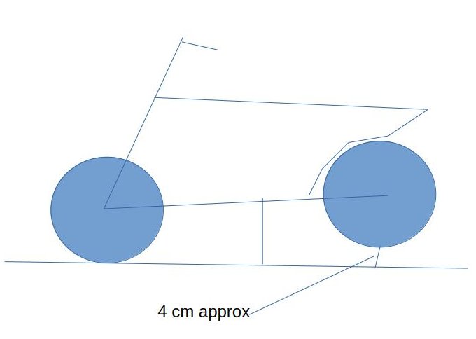

Terribly frustrated installed shock and resulted that bike continues to be very difficult to raise to stand.
Almost every time I need help. Seems I must lift the bike to first floor of the building.
Saw that there’s no way to regulate shock extension, it’s at it’s maximum (~41mm)

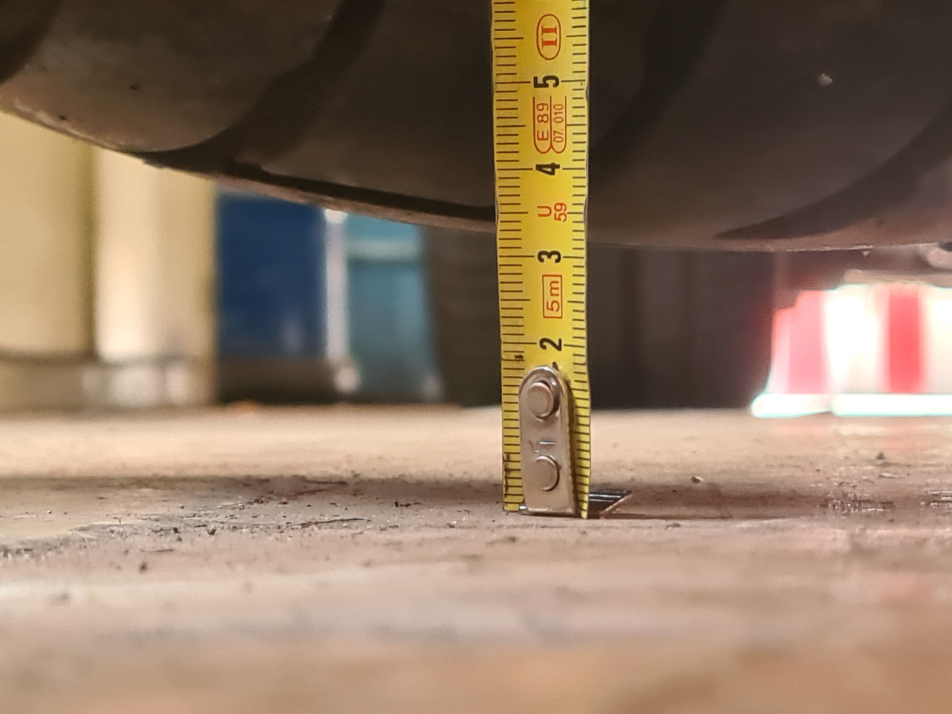

When standing on central support I saw that there’s around 4 cm space between tire and floor
Can hardly remember, but I think long time ago I saw tire closer to floor than it look today.
Can any of you measure that distance on your standing bike
I add a terrible draw, I hope it’s enough to understand what I’d like to know.

Hi Ricardo - With my Bol D’Or on the centre stand, I cannot get my hand under the tyre - maybe about 12mm gap to the floor

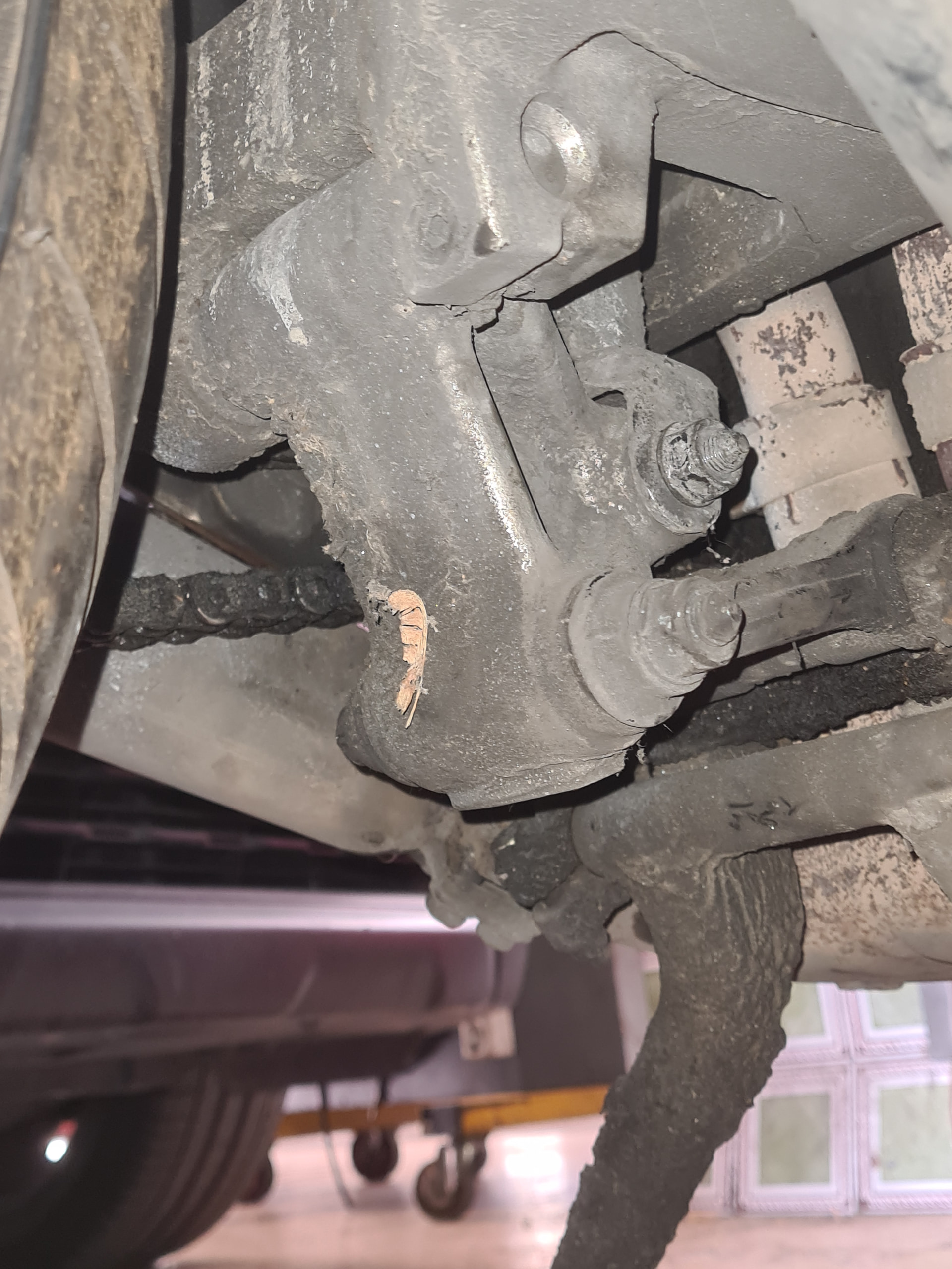

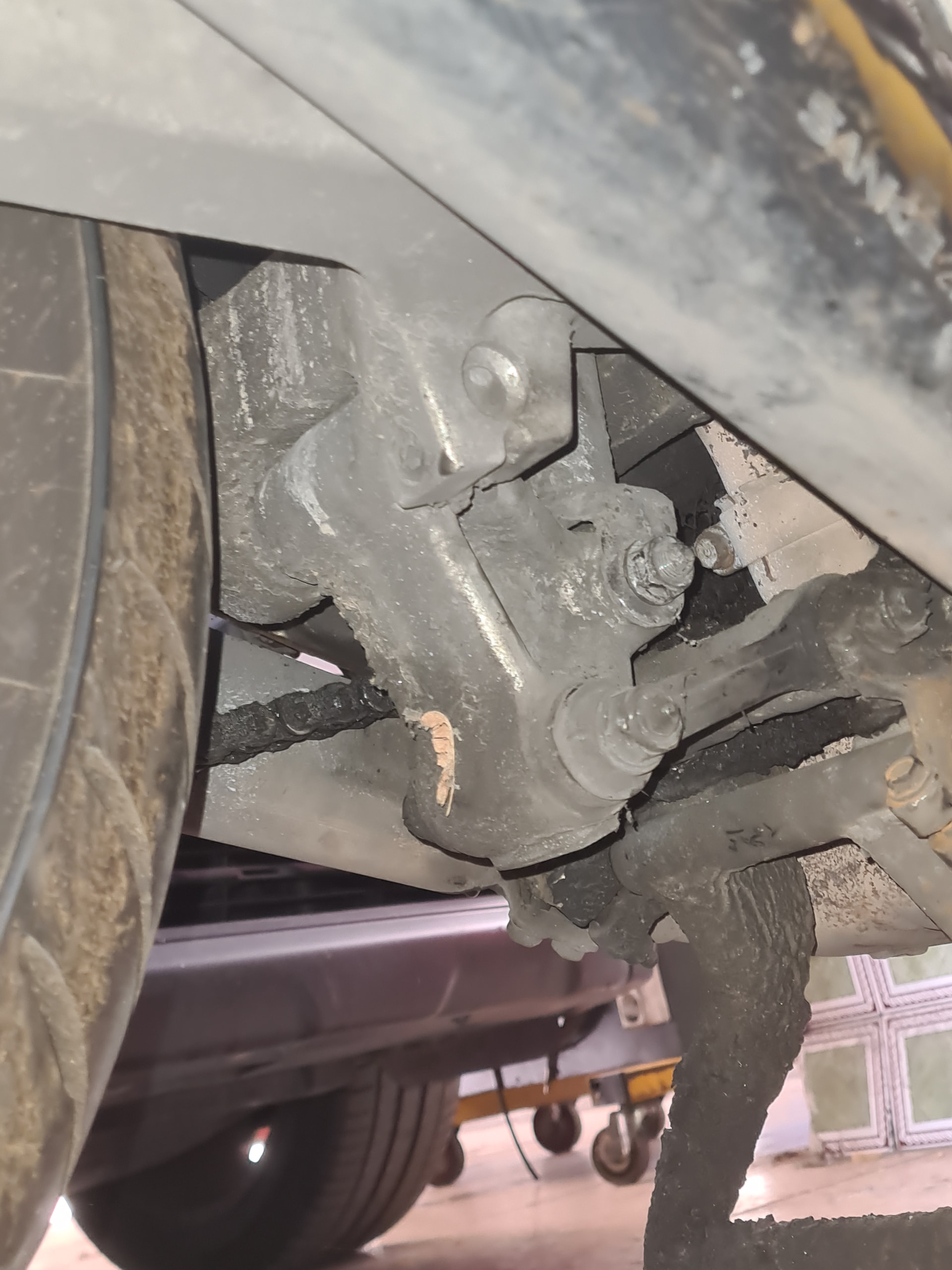

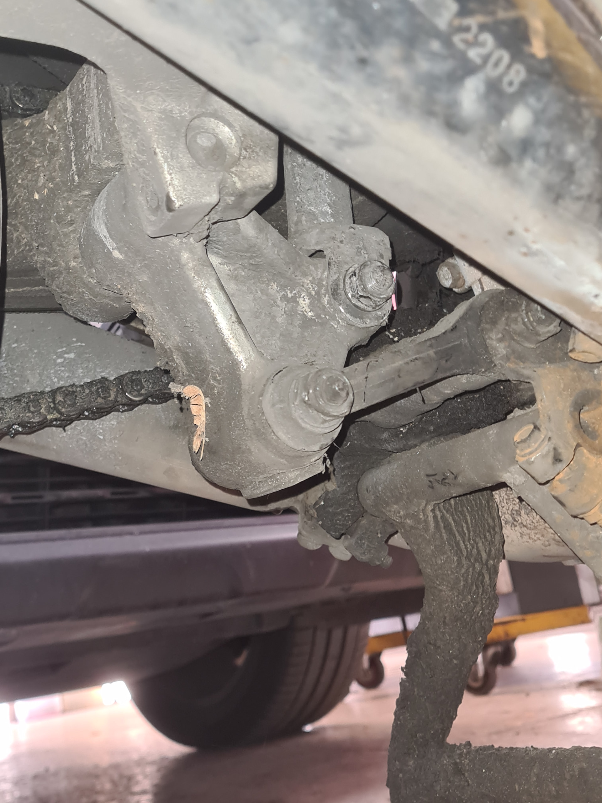

I’ll try to attach a couple photos, if I discover how to do…
Please excuse disorder, I’m terrible managing computer

Thinking a littled more I believe the only way to change geometry, could have been dismounting shock link and mounting it in reverse position.
Maybe some of you could take photos of their bike shock link as those sent in previou message
I will appreciate if I could compare mounting with my “heavy” Honda…
Thanks in advance
Ricardo
Hi Ricardo. The shock linkage looks correct - it’s the same as mine. What else could it be? What size rear tyre do you have fitted? 140/80-17 should be the ideal size.
