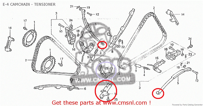

You may need to check the long tensioner arms, they have a rounded section on the bottom and this part sits in a bracket with cutout down near the crankshaft…if this is not seated correctly it can cause all sorts of grief.
I’ve seen the long tensioner arms snapped off at the bottom too…worth a look at least while you’re in there.

How much will I have to take apart to get to it. Do the cams need to come out? if the cams have to come out I’m going to put timing chains in it just to get it out of the way now.
Yes, cams need to come out to remove the tensioner & blade assemblies.

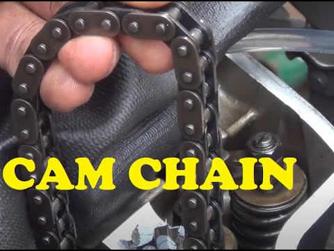

There’s a vid on youtube showing how to remove the tensioners, he also changes out the chain…but that’s not required in your case I suspect. etc…

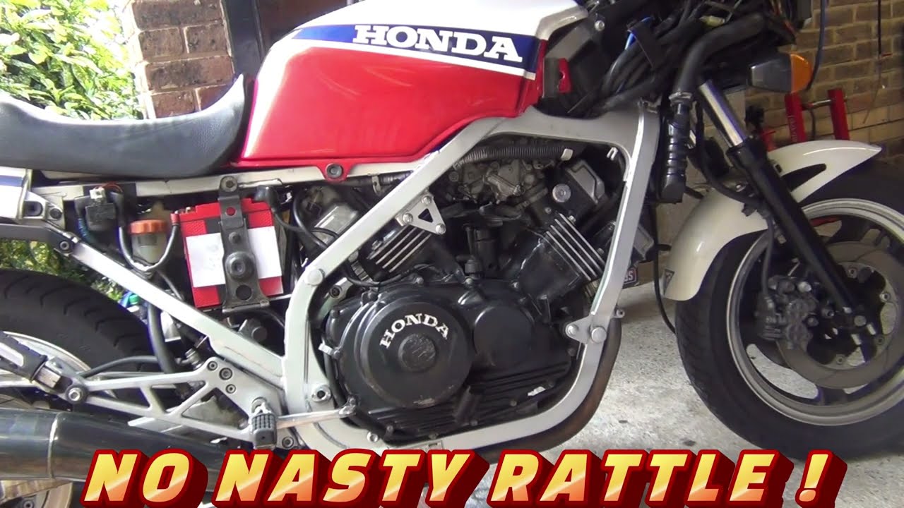

And here’s your before and after audio

I noted on that video that the chap changed the lockplate spring but refitted the pastic sheath to the new spring. that is a really bad idea. The sheath expands in the heat and oil and actually stops the lockplate from doing its job.
I fitted a twin spring setup and hardened lock plate to all my old VF-F’s, never had an issue after that. The plastic sheath is more of a pain in the ar$e than anything else…I suspect Honda thought it would help with spring rattles or vibration…
