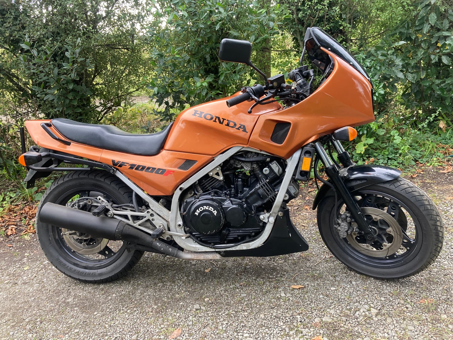

I’ve got an ol’ dunger I’m doing up and could do with heaps of bits..
If you’ve got 1 my way 4 cheap- I’m interested..
cheers
Put some photos up could help
here’s a pic of it before I took it apart- rare brown 1 ! -I’m nr chch
looking for so far - fuel pump, switch gear both sides, 4 into 1 and numerous small broken bits.. or possibly whatever anyone has to get rid of.. or whole 1 ..
carbs in bits at the mo- cooling bits coming off next… very keen to get it back on the road!

Hiya, thanks 4 the thought- I’m 1/2 way through the gummed up f brakes.. no where nr as bad as yours! but need doing.. carbs still in bits- nothing major apart from time there cleaning all the glue someone used on the bowls and blocked jets. Bit of movement in the head race so’ll try and tighten before buying new bearings- should pull it apart really. I’ll have to replace a tyre valve- it’s perished- that’ll b easy and look at rear shock links/pins for greasing
the 4into1 would b a nice to have and all about looks really.. any pics of yours? I could fab 1 up - in theory anyway- ha.
